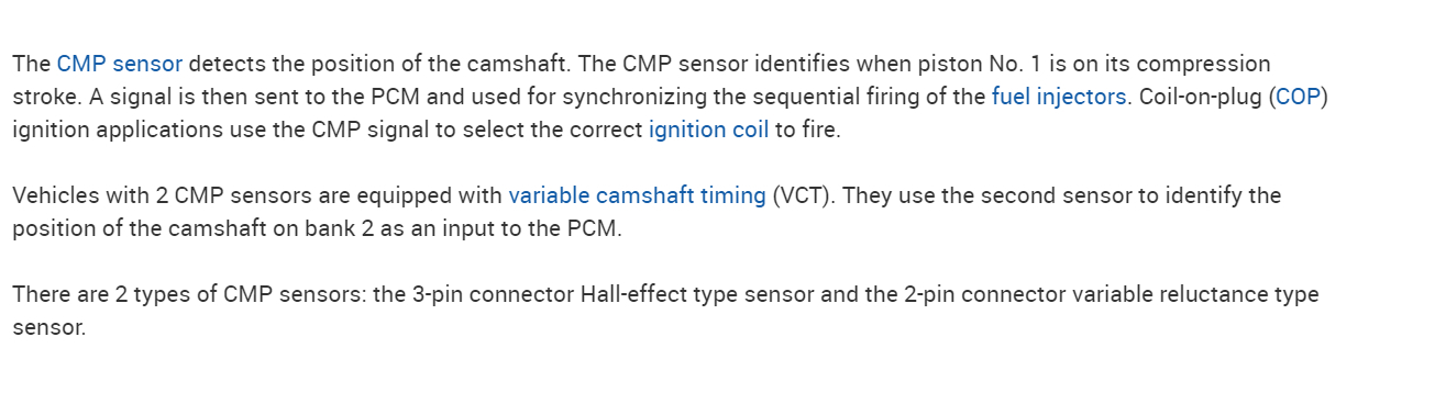

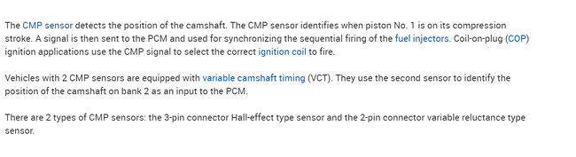

can the sensor variance be done by me or is it dealer only?
Sep 7, 2019 at 1:39 PM
SCGRANTURISMO
  • 4,897 POSTS
What sensor variance are you talking about? Camshaft sensors usually read a wheel on the end of the camshaft to give the Power-train Control Module (PCM) information on where the camshaft is in it's cycle.

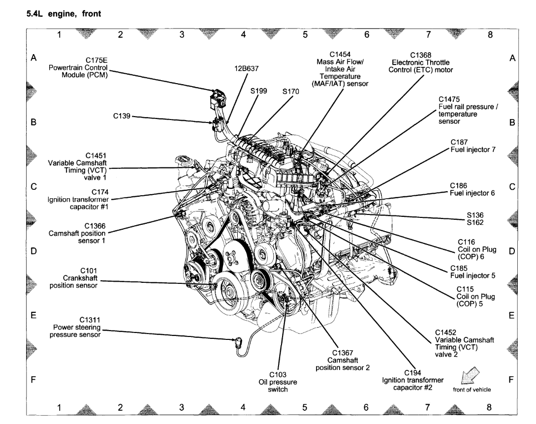

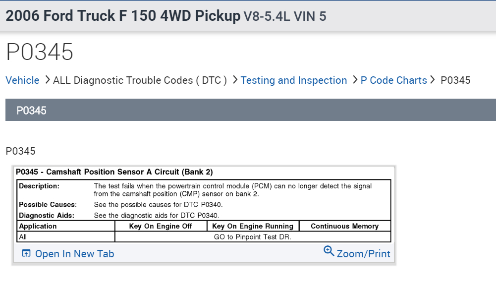

PATRICK ROONEY

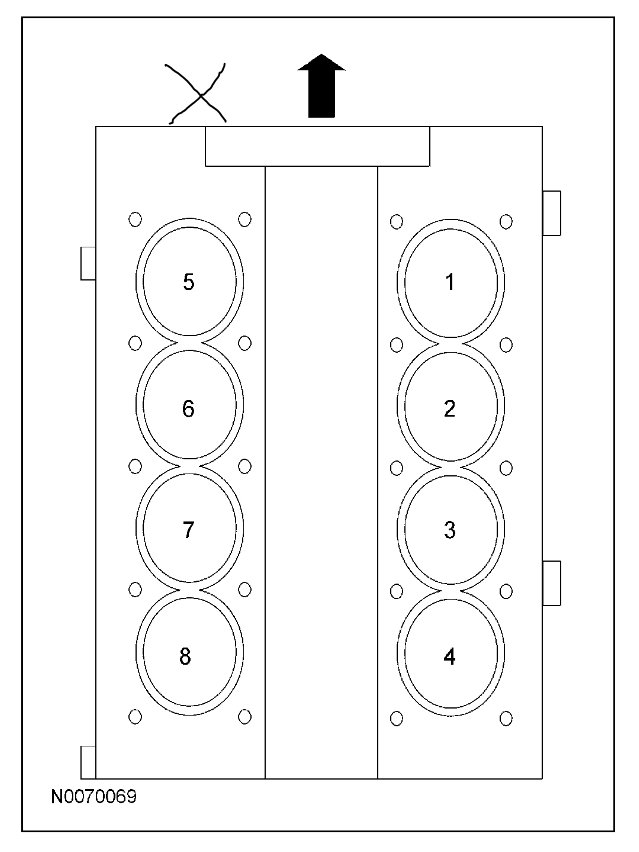

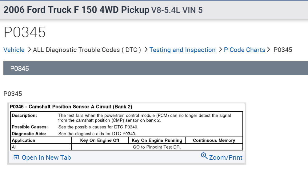

I need to know or find a picture to where my camshaft position sensors are located. I got the P0345 code today and after every other start I get the code. Thanks!
Aug 21, 2020 at 5:38 PM (Merged)
SCGRANTURISMO
  • 4,897 POSTS
I have included the information you requested in the diagrams below.
Thanks,
Alex
2CarPros

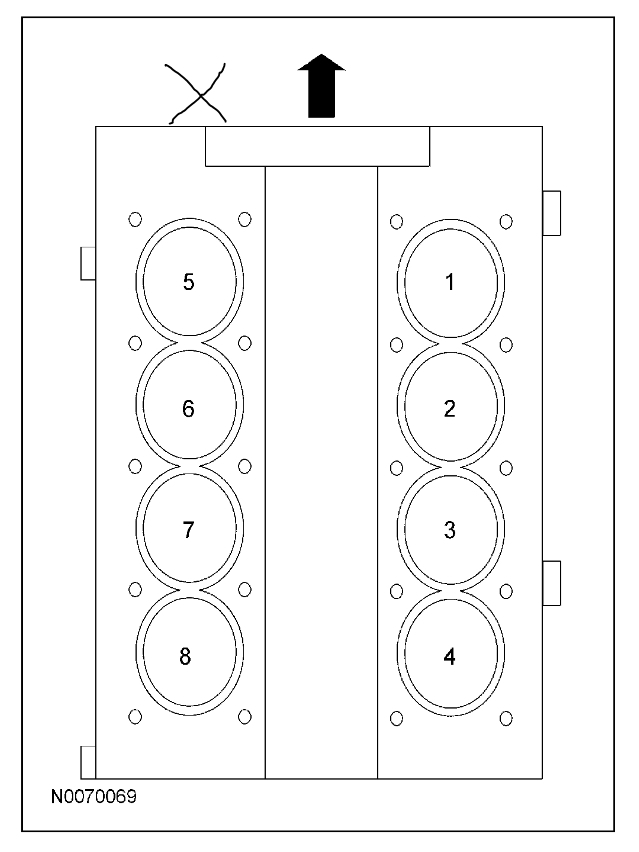

PATRICK ROONEY
Which side is P0345 on? Or should I just change them both out?
SCGRANTURISMO
  • 4,897 POSTS
I have included a diagram down below in the diagrams for you. I have marked the bank with an "X". It is going to be the driver side bank as you sit in the vehicle.

TOMMYGUNZ06
truck runs fine but i get a camshaft position sensor circuit malfuction bank 2
Aug 21, 2020 at 5:39 PM (Merged)
RACEFAN966
  • 5,029 POSTS
Ok what is the code number that is found? This will lead me to the test procedure to that code. Get back to me with the P code you found so I can look it up and walk you through the test. Thanks.

WRENCHTECH
  • 20,761 POSTS
It has two of them, they are on the front of both heads. The picture is the left side. https://www.2carpros.com/images/external/118853912.gif

HMAC300
  • 48,601 POSTS
There are two sensors one on each cylinder head at the front here is a guide that will walk you through the steps with a diagrams below that shows you the location on your engine.
https://www.2carpros.com/articles/camshaft-angle-sensor-replacement
Check out the diagrams (Below). Please let us know if you need anything else to get the problem fixed. Cheers

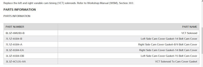

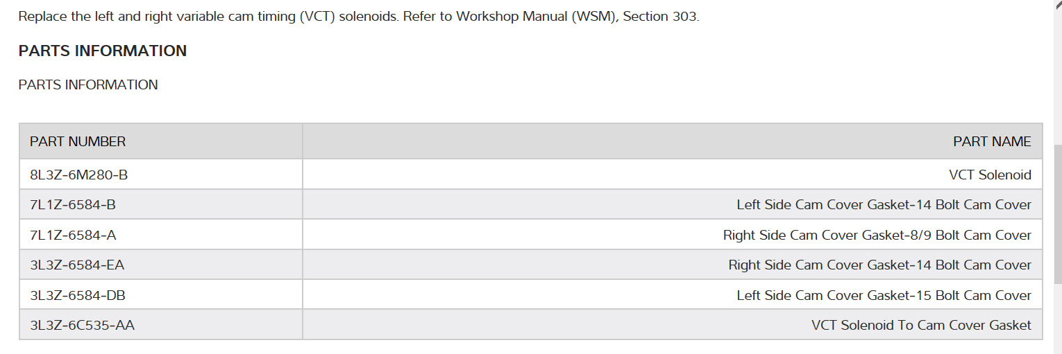

PHILLIPSG148
Replaced vct solenoid and cam sensor still makes deasil sound on idle and a 0012 code
Aug 24, 2020 at 9:22 AM (Merged)
HMAC300
  • 48,601 POSTS
there is a tsb on this for your problem the number is 14-0114 dated may 30, 2014. call a dealer and see if they will do it for free they may see pic

DIJEFFZ
I replaced the sensor and the check engine light came back on. thinking that maybe I did not know left from right I replaced the other sensor, but it still came back on. is there something else that I might be able to check?
WRENCHTECH
  • 20,761 POSTS
The code doesn't automatically mean the sensor itself is the issue. It can be any part of the circuit to include the wiring and PCM or even mechanical issues preventing the sensor from reading properly. It all needs to be looked into.
