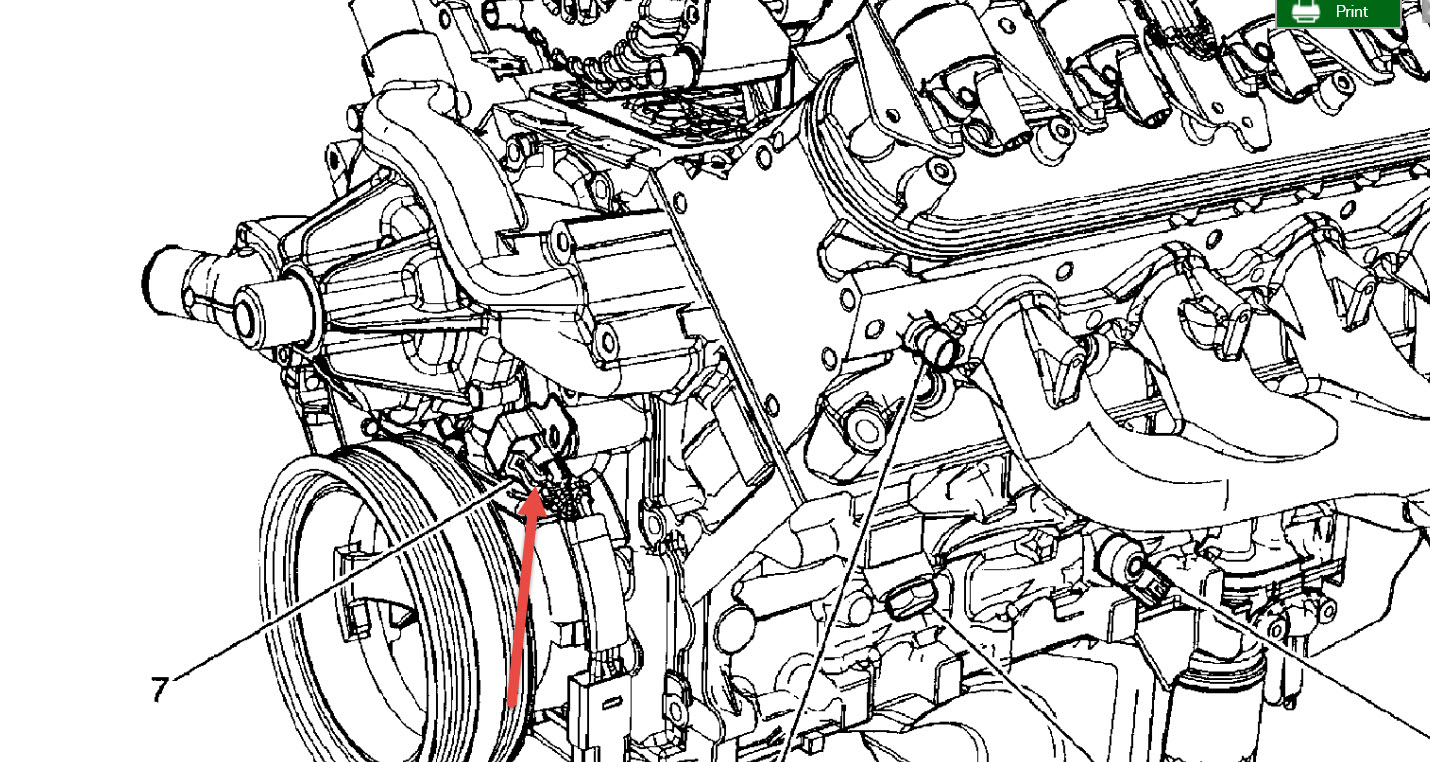

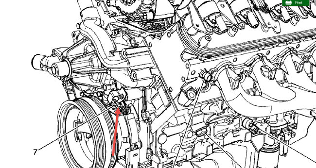

Coding P0011. Is the CMP on this engine located at upper rear of engine, passenger side, and only access is to remove the intake?
Aug 13, 2016 at 5:27 PM
HMAC300
CERTIFIED EXPERT
48,601 POSTS
no it's on lower leh side of motor see pic
Image (Click to enlarge)
Aug 15, 2016 at 7:31 AM
RLDAVID71
MEMBER
2 POSTS
Thank you. I'd understood that location to be the Crankshaft position sensor.
Aug 15, 2016 at 6:34 PM
HMAC300
CERTIFIED EXPERT
48,601 POSTS
no crank sensor runs off of crank by the starter
