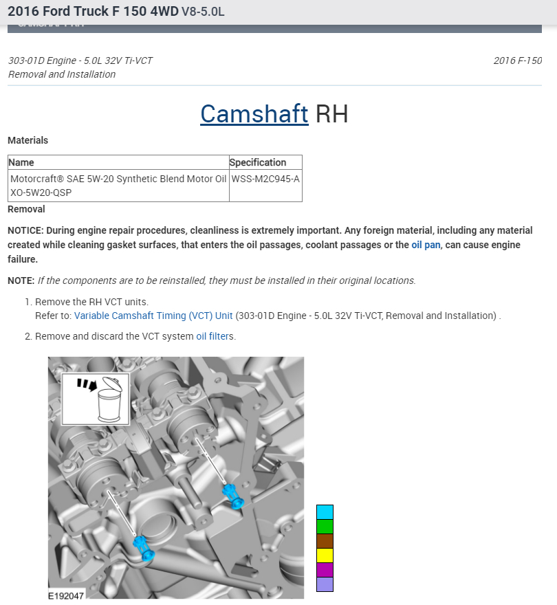

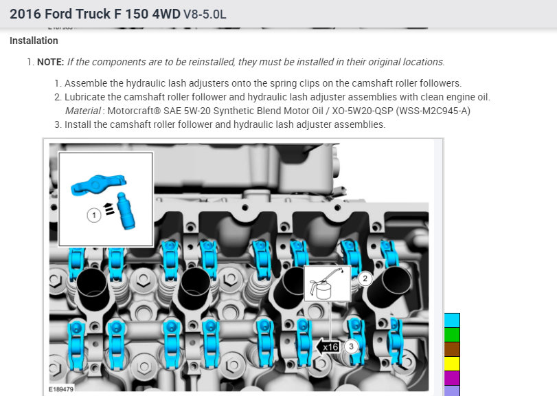

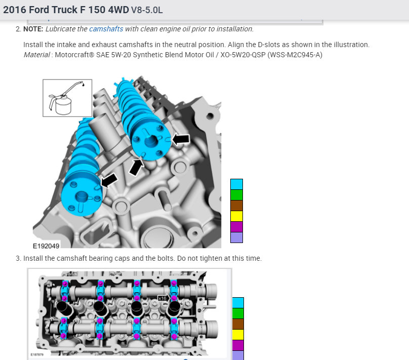

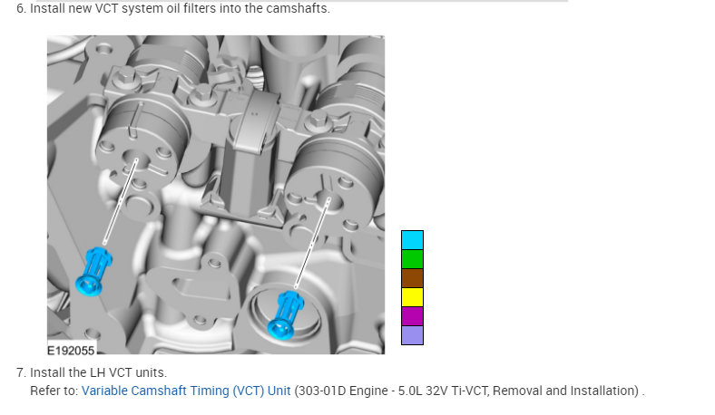

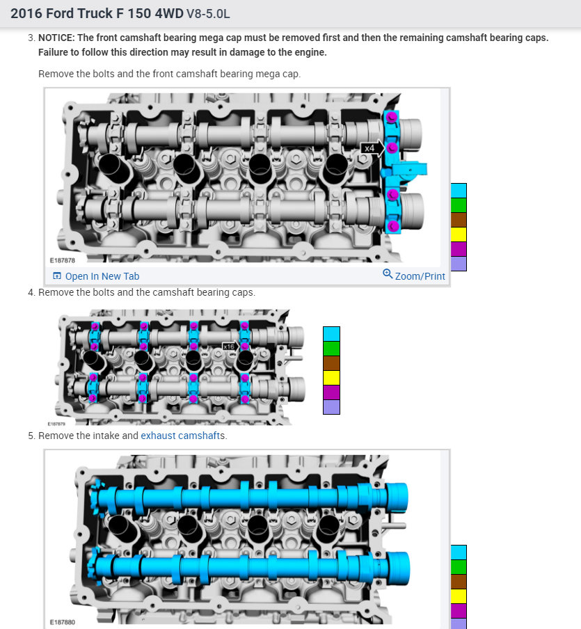

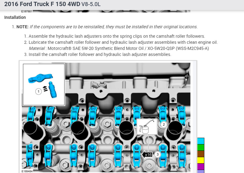

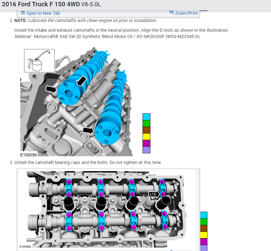

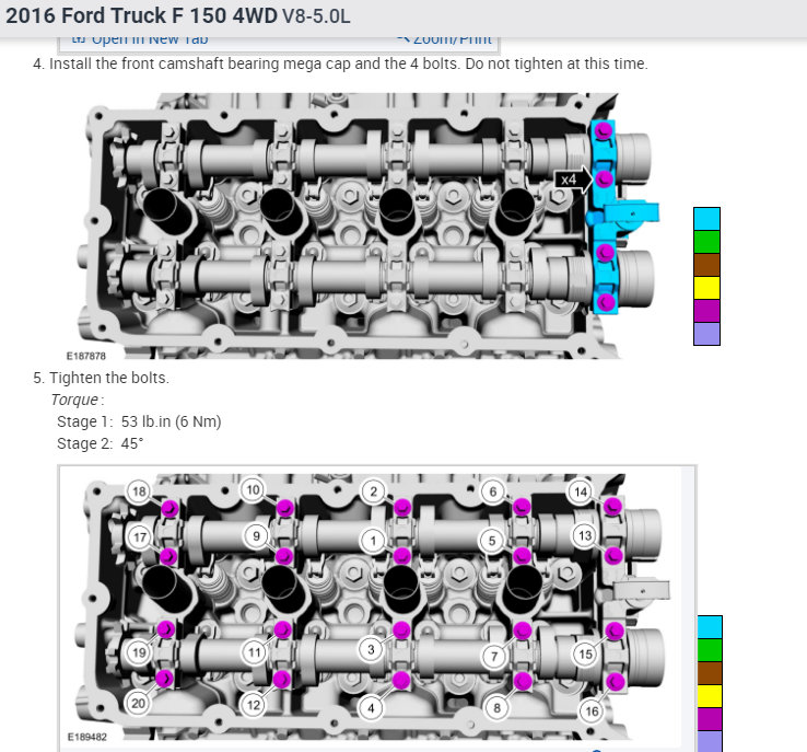

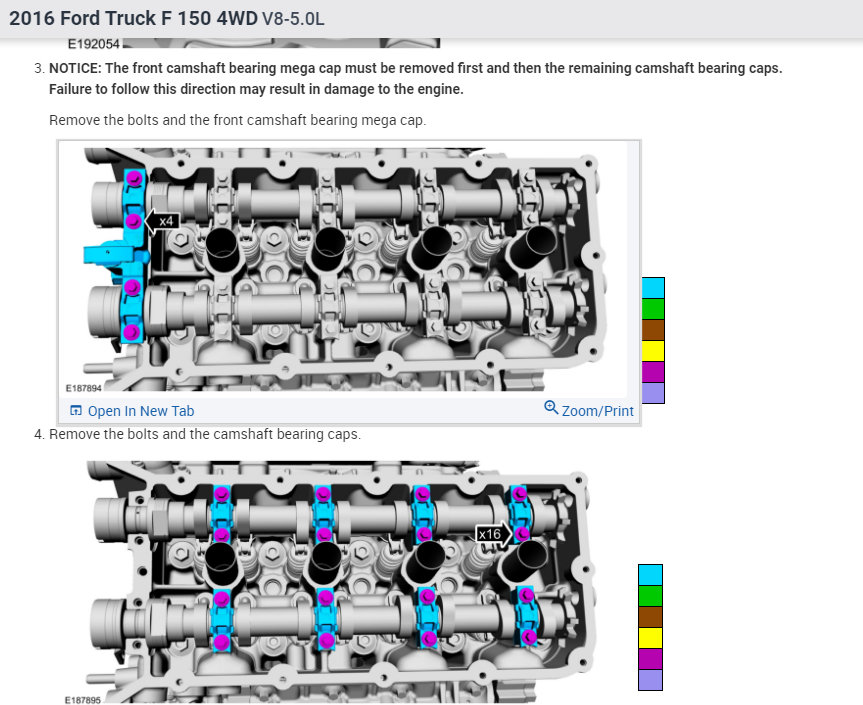

What orientation does each cam shaft need to be in when installing them into the head?
Jun 15, 2022 at 1:03 PM
SQM
CERTIFIED EXPERT
6,383 POSTS

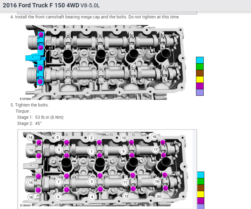

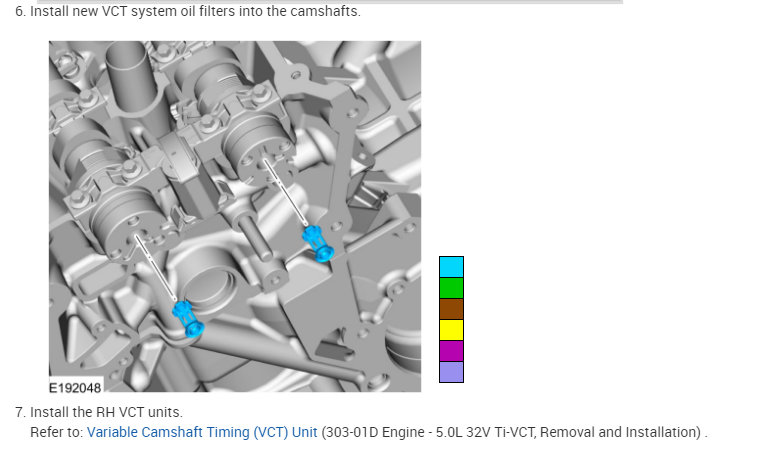

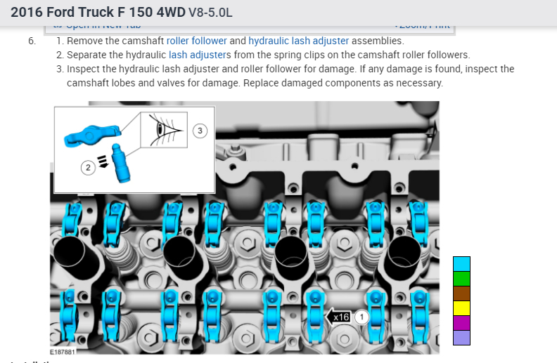

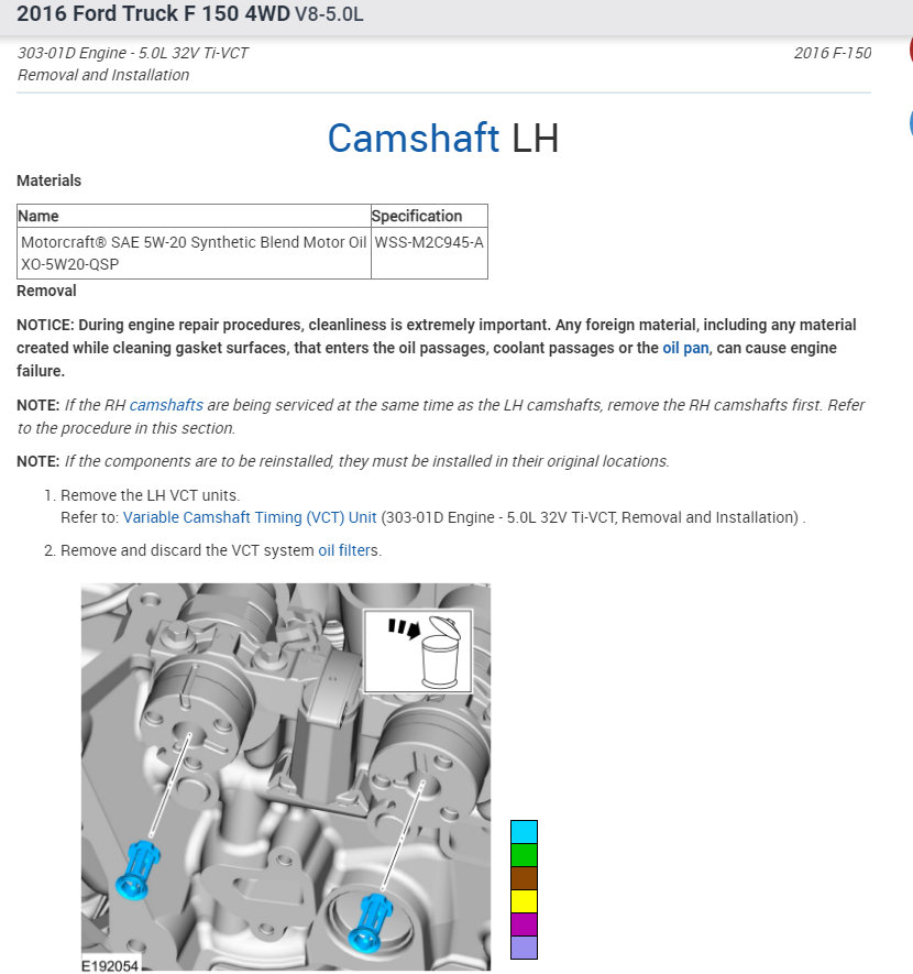

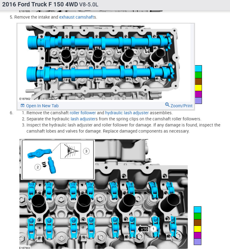

Look below for the camshaft replacement procedures.
It shows the position as well as the torque specifications.
Let me know of any questions.
Thank you.

This is perfect. Thank you!
