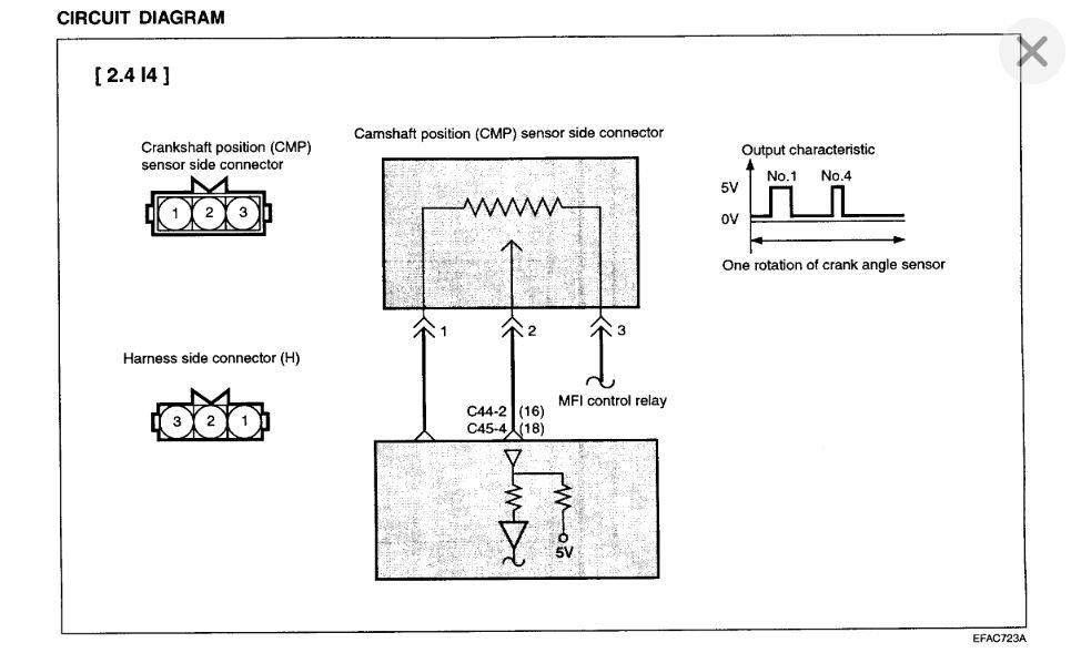

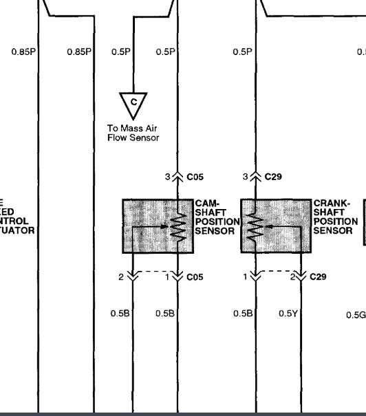

I installed the connector. Not positive which wires connect to which pin. but I put (one black and white, two pink, and three black). I was wondering if I can ruin the sensor while installing the plug. At one point I blew a fuse. But now the car starts then immediately shuts off. Does that make since? Thank you.
