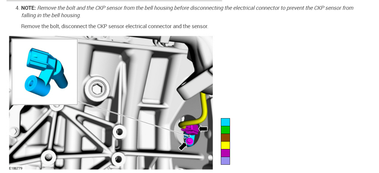

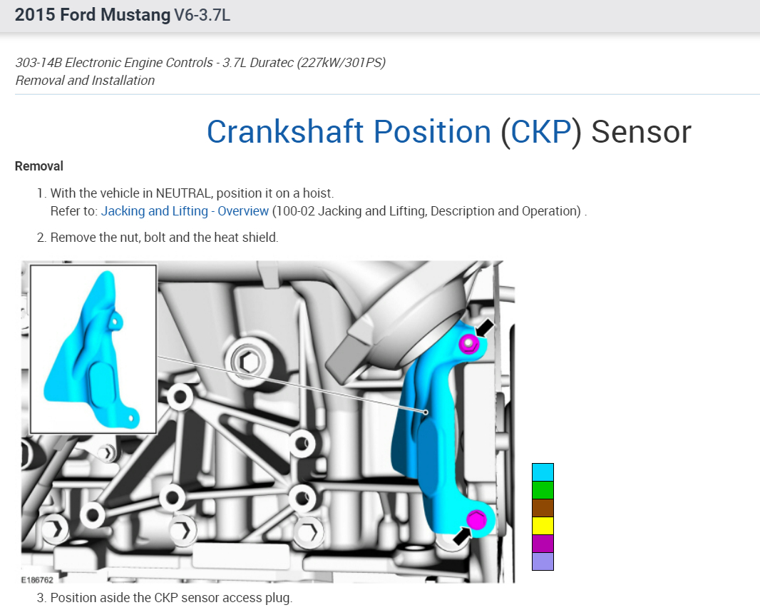

Does anyone know the part number for the crankshaft sensor bracket it screws into in side engine by the flywheel my threaded part broke.
Aug 1, 2023 at 4:21 AM

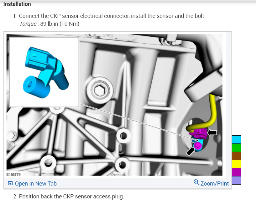

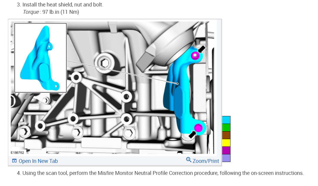

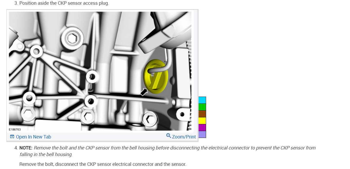

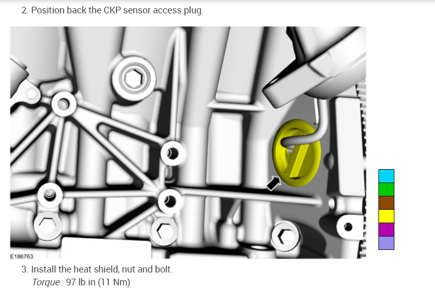

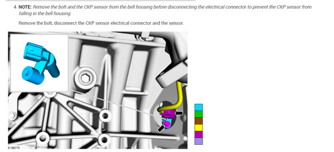

I am not sure what part you need; it looks like the sensor has the bracket made into the sensor? Please check the images below to see what I am talking about. Check out the images (below). Please let us know what you find.
