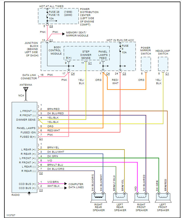

I'm trying to hook up the rear speakers in my van and don't know the factory color coding for the vehicle I got to aftermarket radio hooked up the way it should it's just the rear speakers aren't hooked up because I don't know what the colors are.
Mar 30, 2024 at 1:14 PM

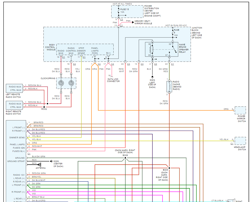

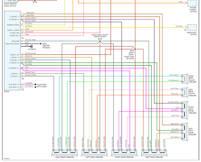

Sure, there are two different kinds of radios, one is the baseline model, and the other is the premium sound system which I have included both set up radio wiring diagrams. Check out the images (below). Let us know if you need anything else.
