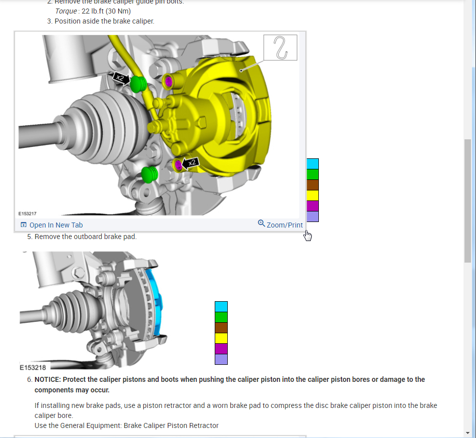

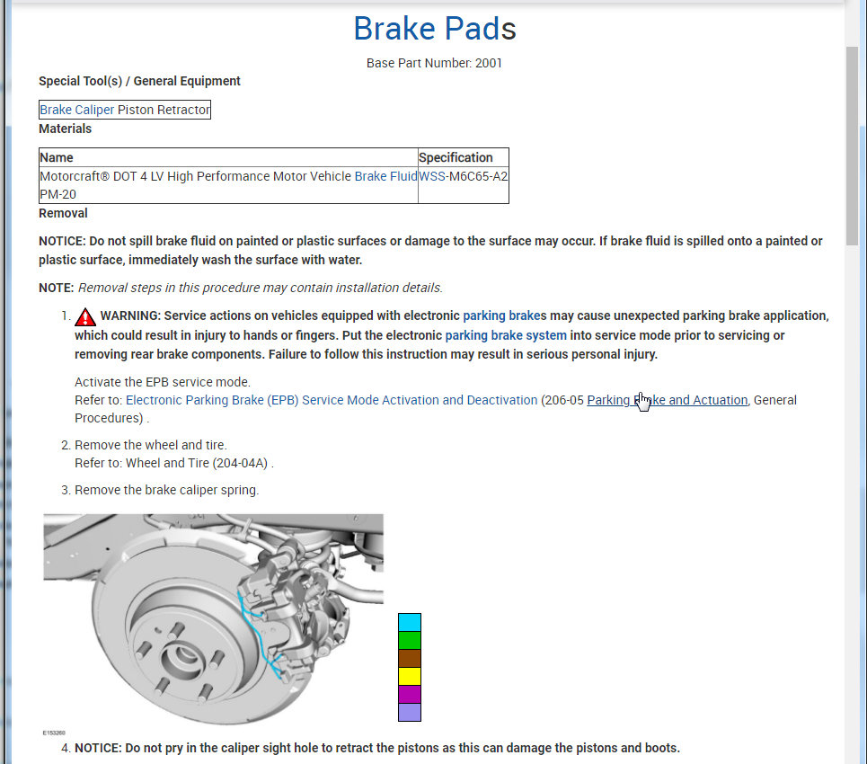

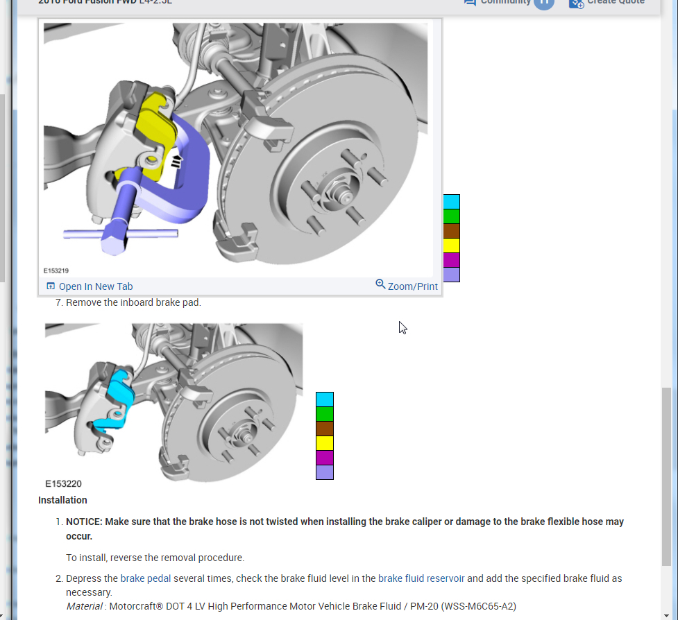

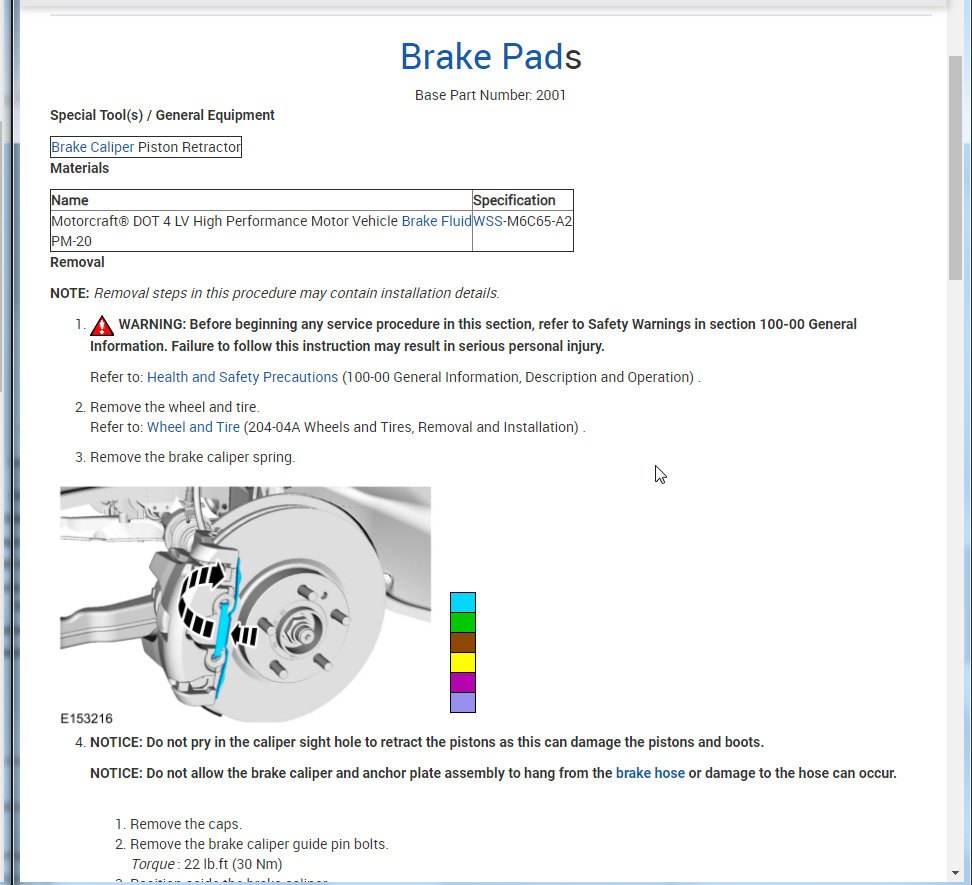

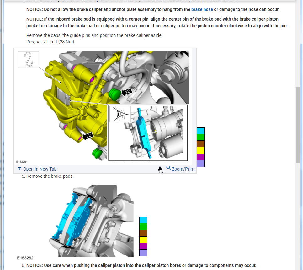

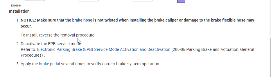

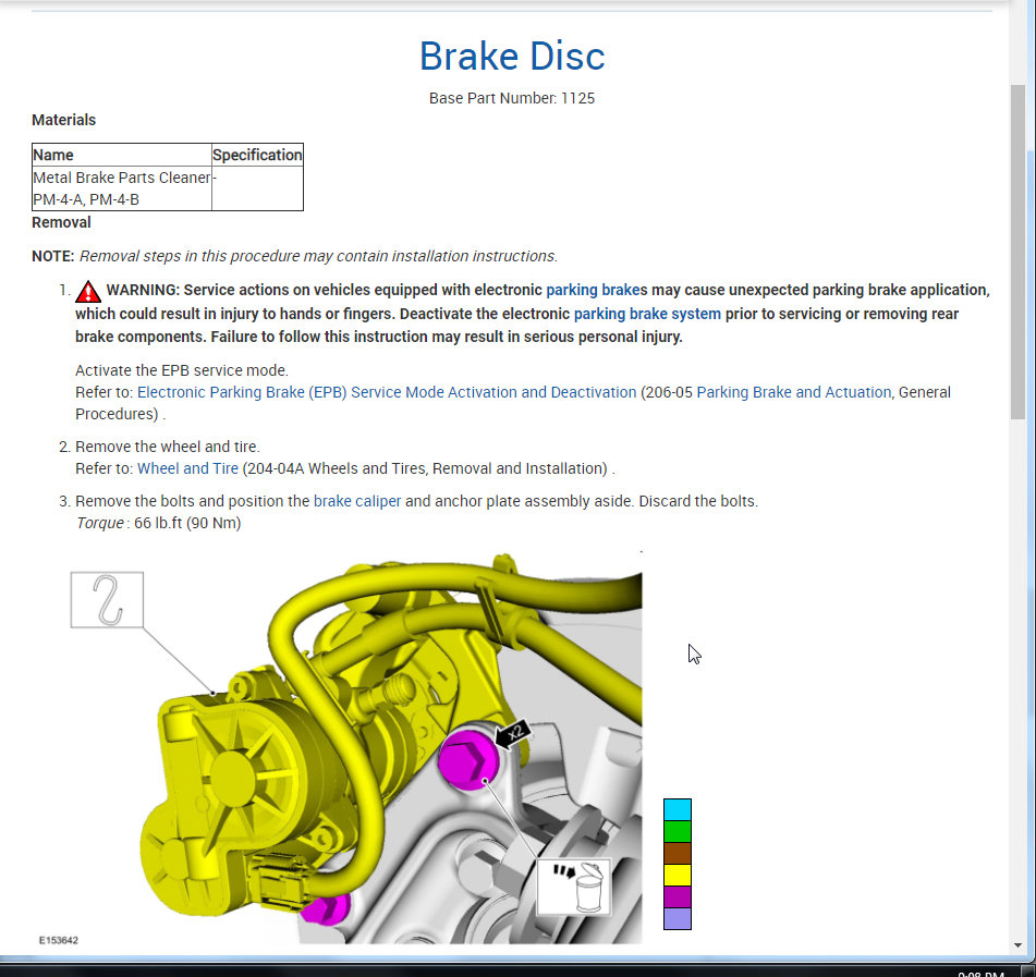

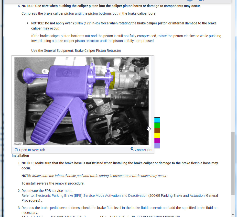

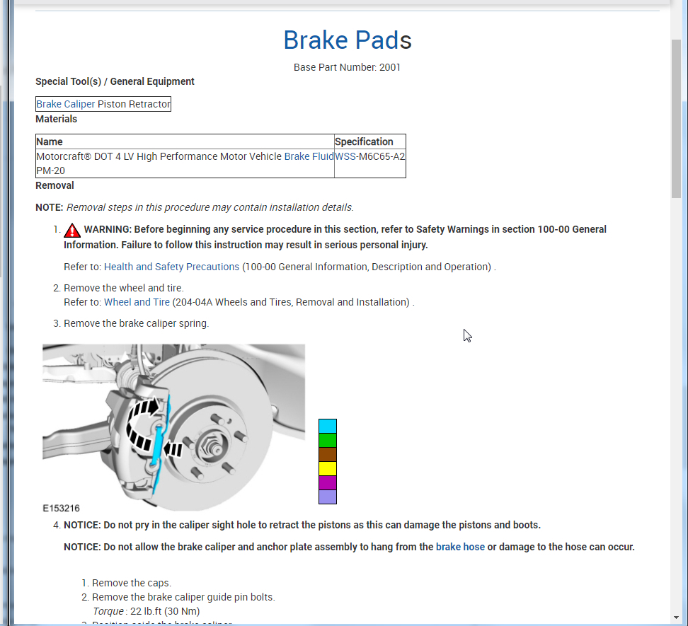

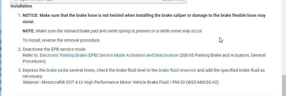

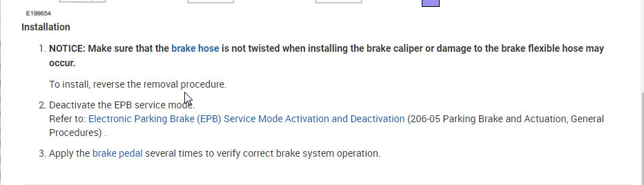

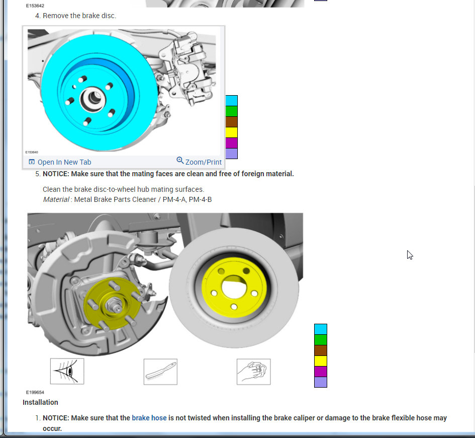

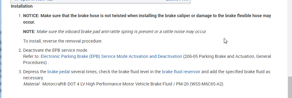

The subject states you need front pads but then you said you need rear in the body of the post so I am going to provide both.
Here are some guides that will help with this: This video shows the job being done on a similar car but the process is the same.
https://youtu.be/dlIUJOYnYQc
and
Below you will find the detail from the manual. Please let us know what questions you have. Thanks
