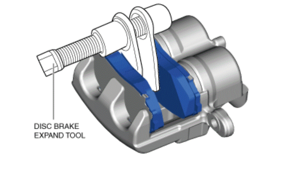

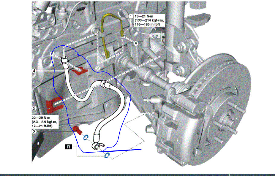

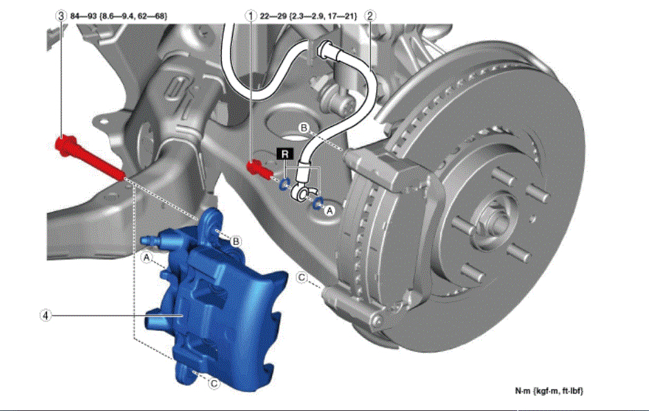

Good afternoon,
If the other side is good, then it could be either the caliper or the brake hose. If either one sticks, the brakes will stay applied and wear down to nothing and the result is what you currently have.
You will need to replace the pads, rotors, caliper and possibly the brake hose as the root cause of failure.
https://www.2carpros.com/articles/brake-caliper-replacement
Did you have the brakes checked yet at a shop?
