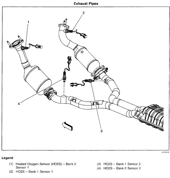

where to locate and install both oxygen sensors?

Hello, I'm Danny.
Your vehicle has 4 oxygen sensors in total. Here is a tutorial showing how to remove and replace:
https://www.2carpros.com/articles/how-to-replace-an-oxygen-sensor
I've attached a picture below of the location of the oxygen sensors for your car. Hope this helps and thanks for using 2CarPros
