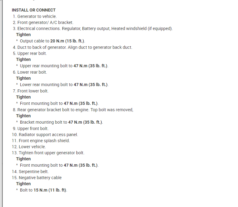

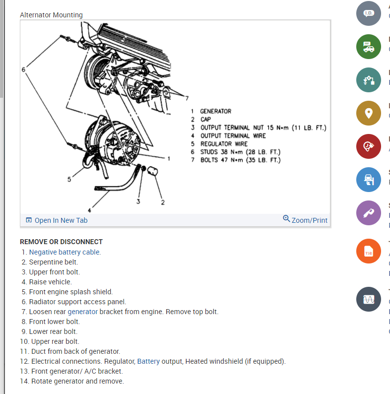

Also, below is the info from the manual that will give the detail needed on this vehicle to replace this.
