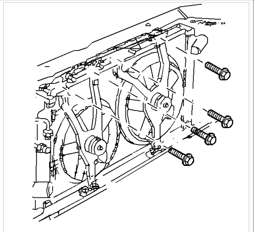

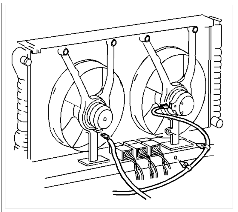

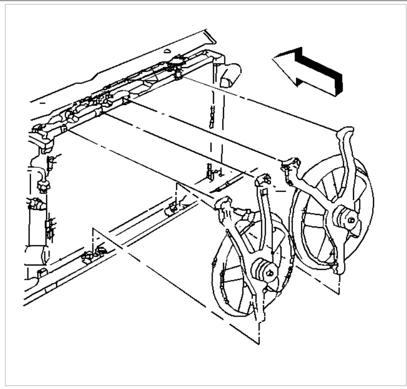

Drain cooling system, then remove plastic radiator support cover.

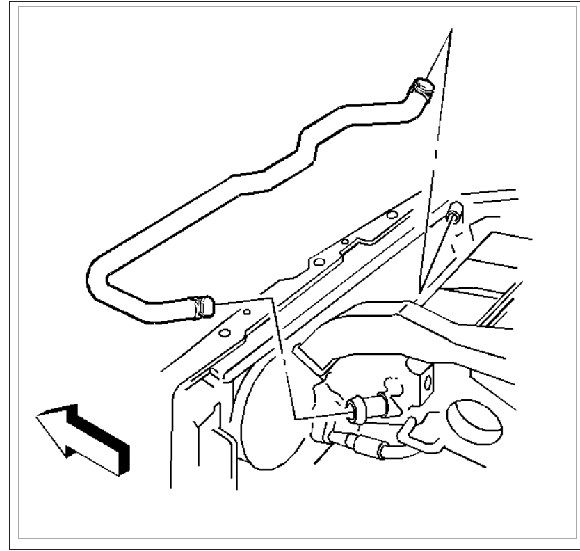

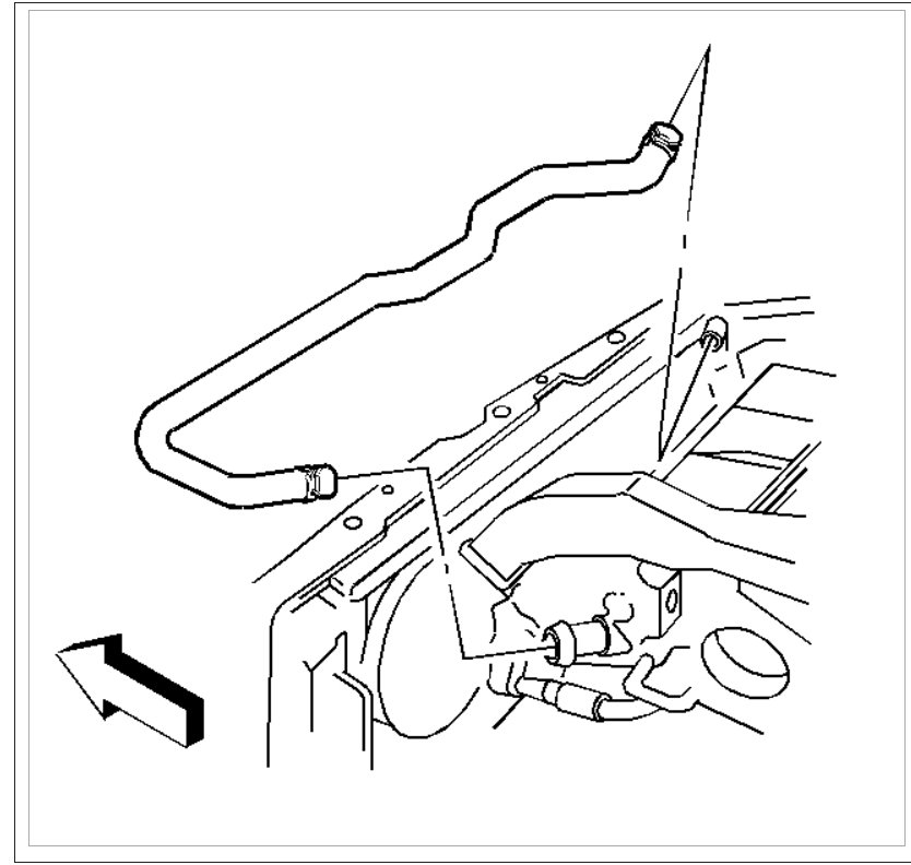

Remove cooling fan, then the coolant reservoir hose at filler neck.

You are going to have transmission cooler lines on the drivers side of the radiator, they are 16mm or 5/8" flare nut. The oil cooler lines I believe are 19mm or 7/8". The upper and lower hoses are 8mm or 5/16" screw drive unless they are spring clamps, they a pair of pliers can be used. If you are replacing the upper and lower hoses you could cut them if needed. The cooling fans and radiator supports are 10mm fasteners.
