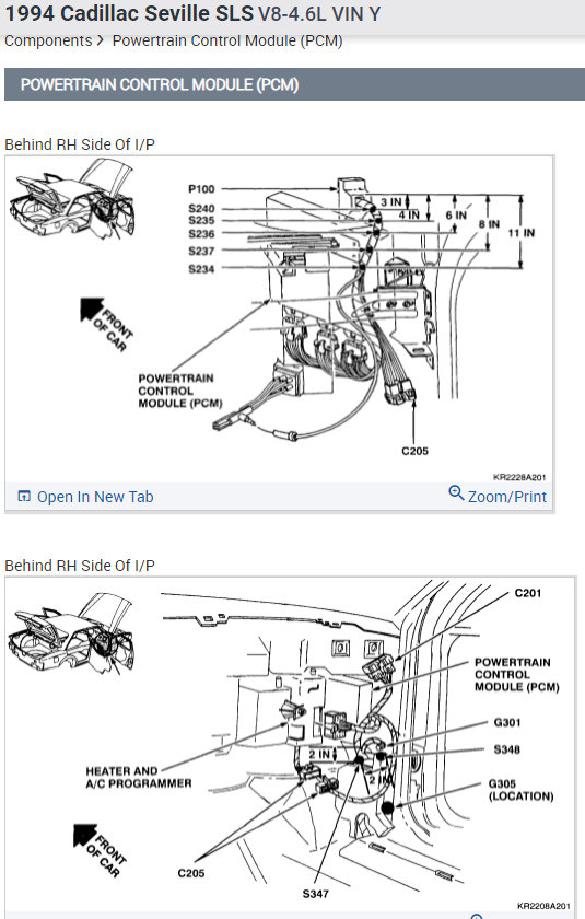

Car not starting need to find out where the computer is located on car?
Jul 11, 2010 at 8:40 PM
SQM
CERTIFIED EXPERT
6,383 POSTS
Please see attached for the location.
