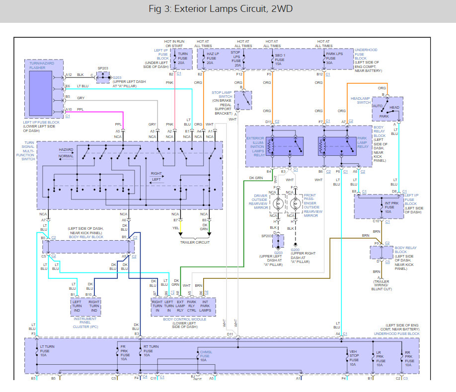

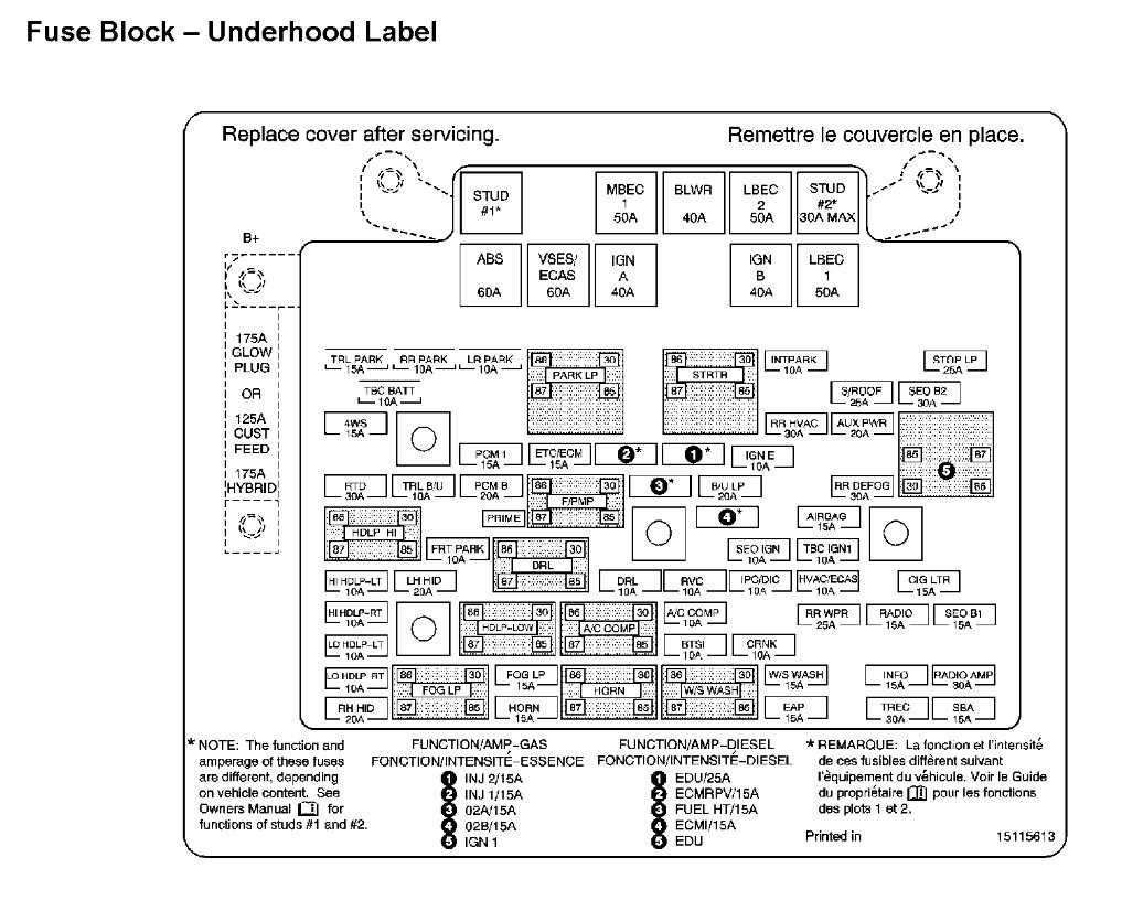

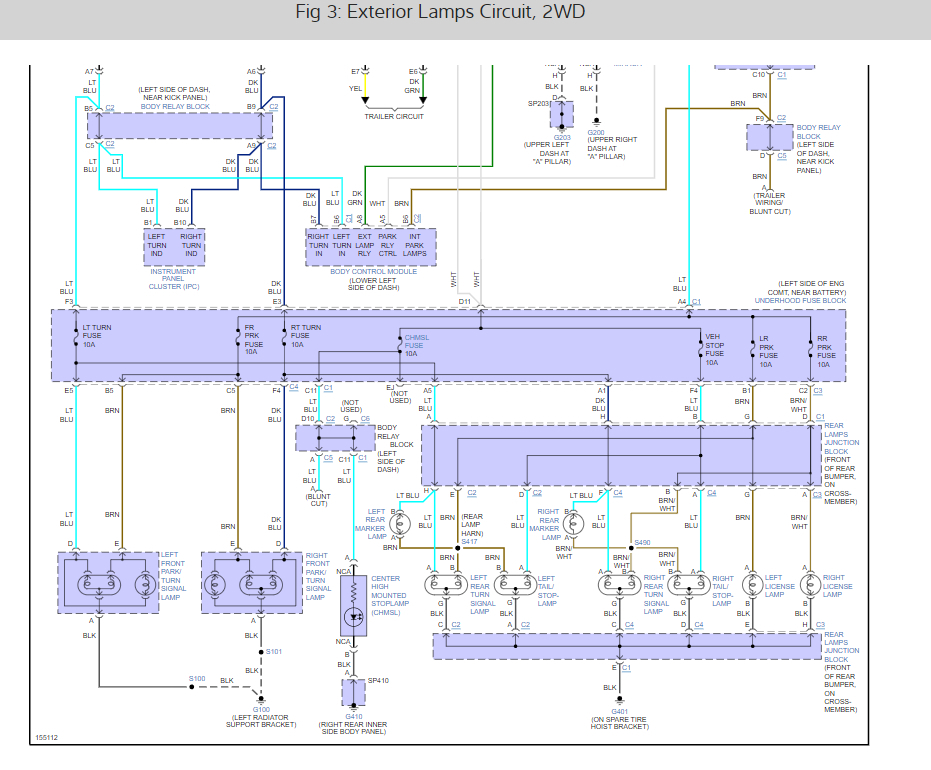

I have seen the park lamp relay go out causing this issue, here is the location of the relay so you can change it out and I have included the exterior lighting wiring diagrams so you can see how the system works. Also make sure to check the fuses. Check out the images (below). Please let us know if you need anything else to get the problem fixed.
