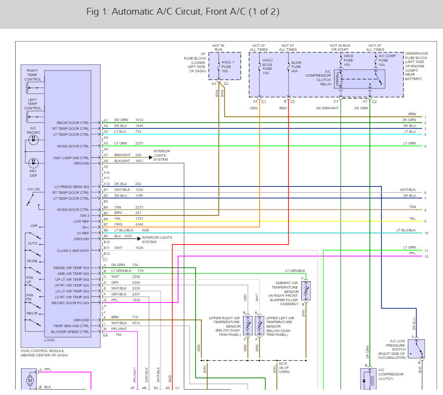

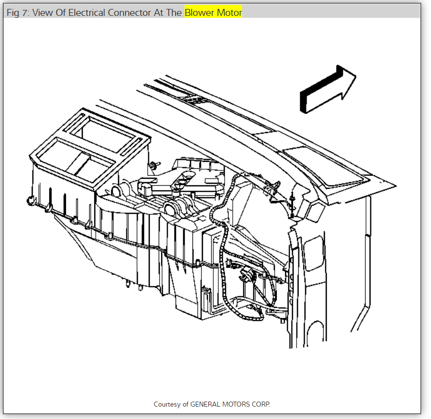

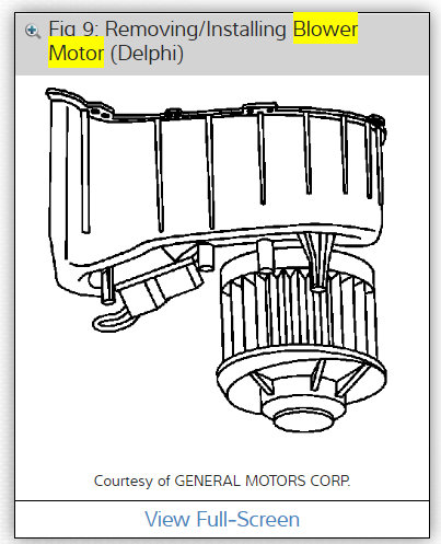

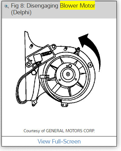

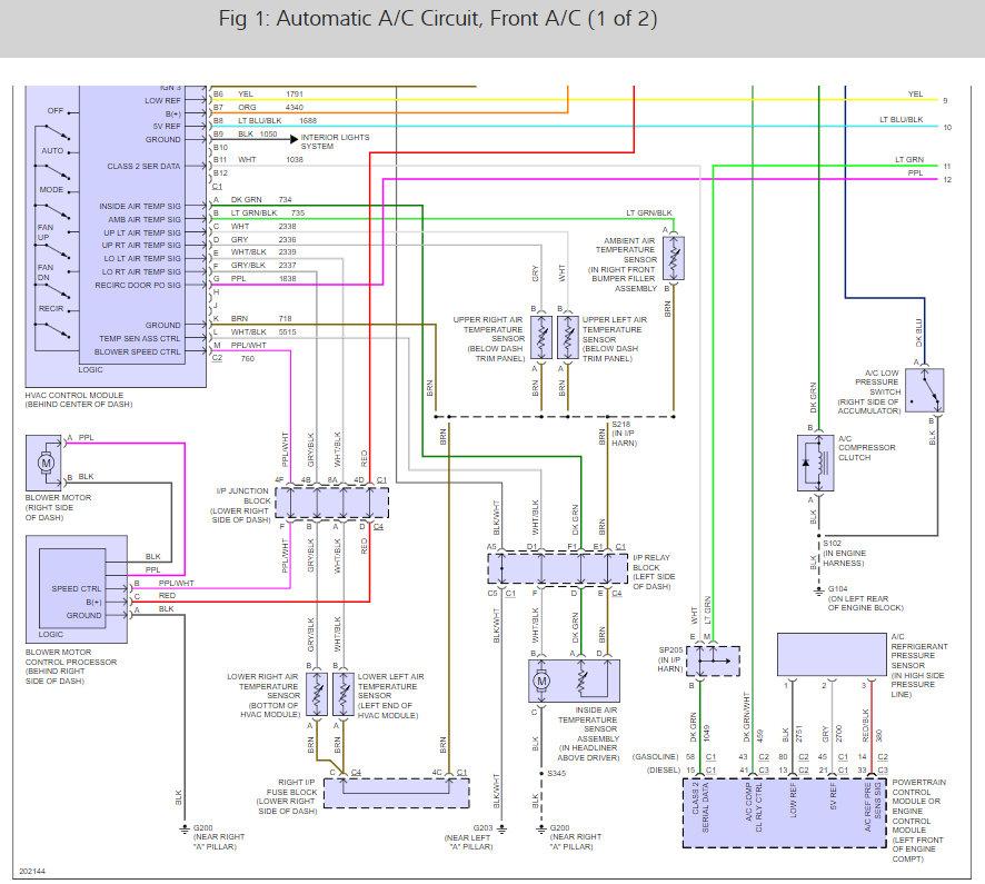

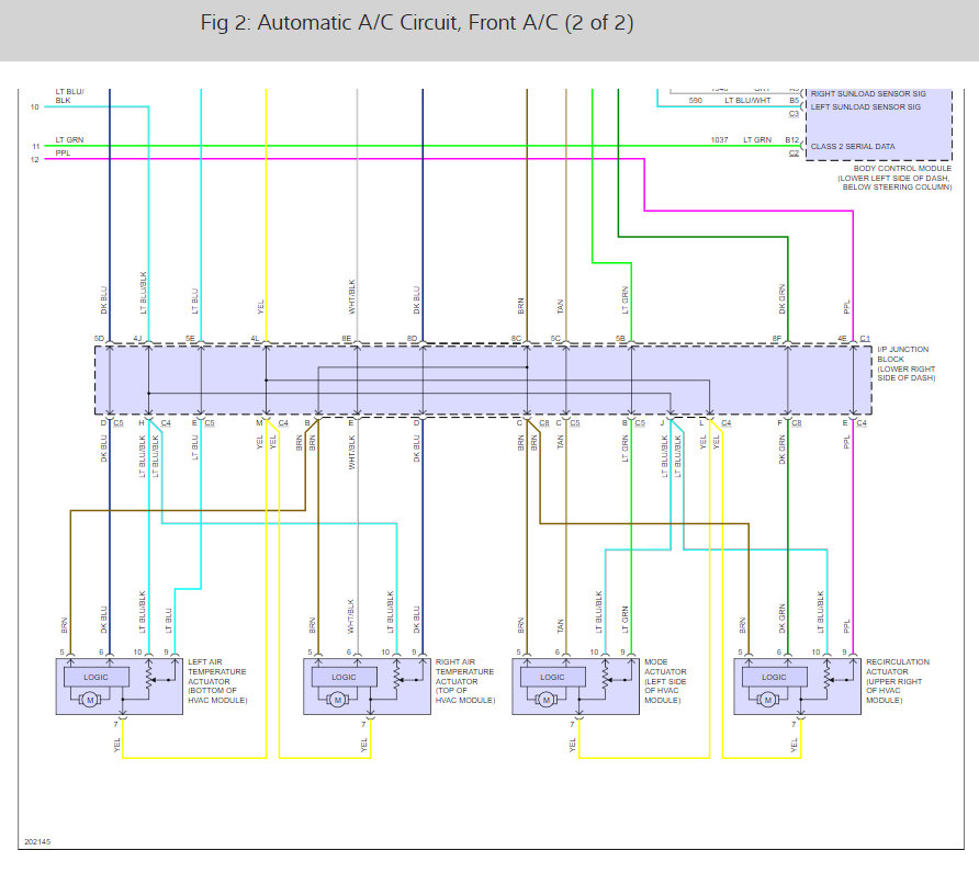

This sounds like a classic blower motor that was gone out. Use a test light to confirm power and ground when the blower motor is not working. Here is a guide and some diagrams below to help you get the problem fixed:
https://www.2carpros.com/articles/blower-fan-motor-works-on-high-speed-only

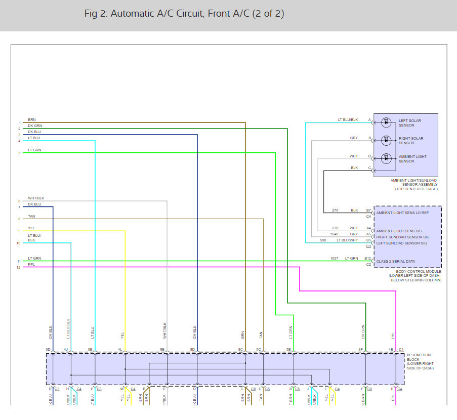

Here are the blower motor wiring diagrams so you can see how the system works.
