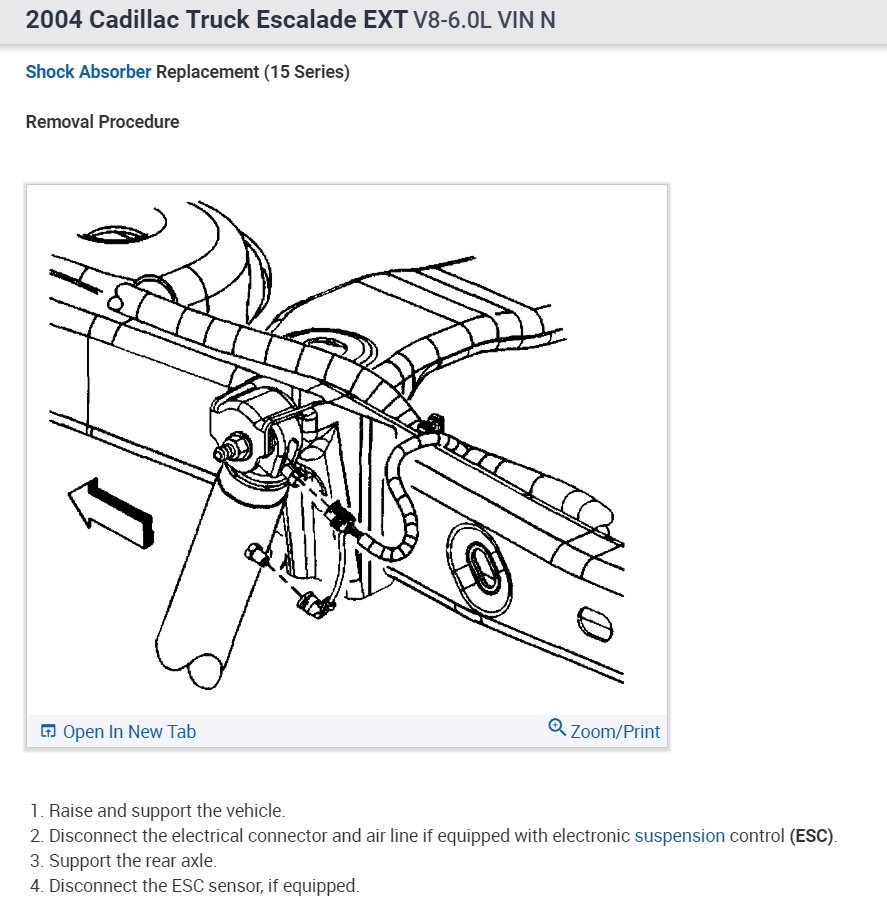

yes the suv saying service ride control. well i have replaced r/ rear air ride shock. it was leaking air, a very little. but need to reset. and hope this is all is wrong. the air compressor in the left rear don't seem to be coming on .where is the fuse or relay for this compressor located ?
