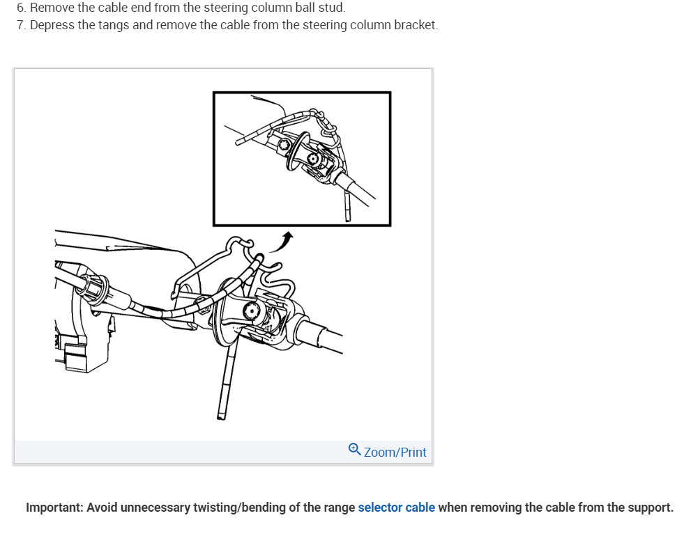

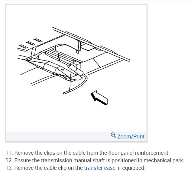

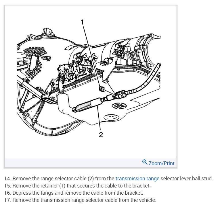

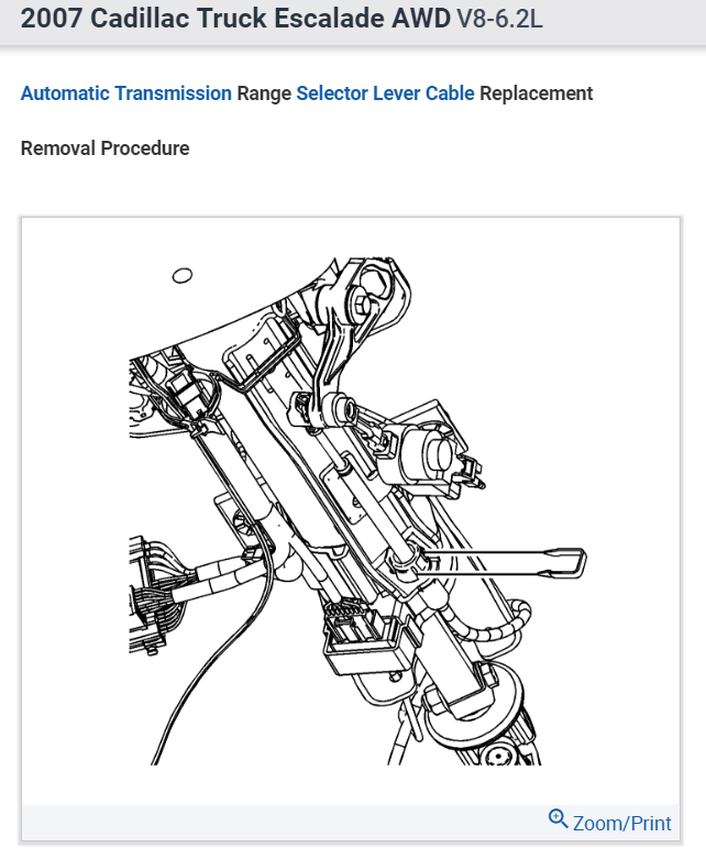

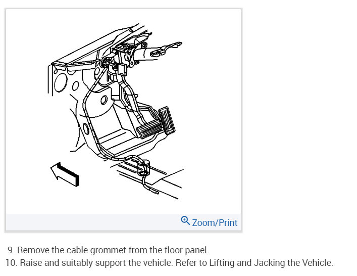

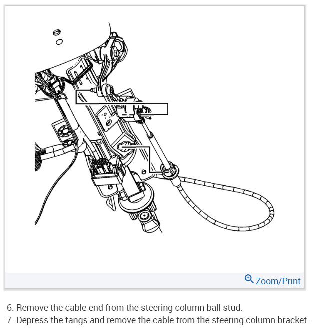

This happens when the shifter cable breaks internally and needs to be replaced here is a guide to help you see what you are in for when doing the job.
PN# 19177019 $51.17
