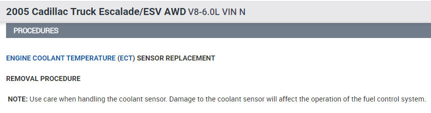

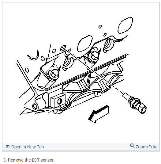

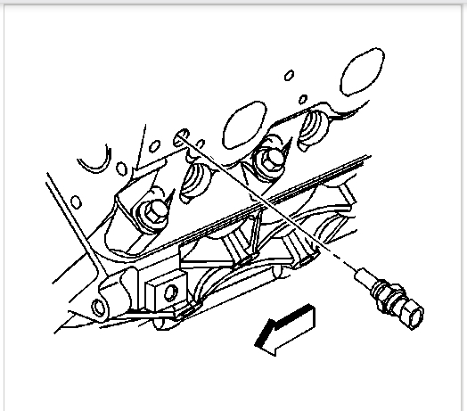

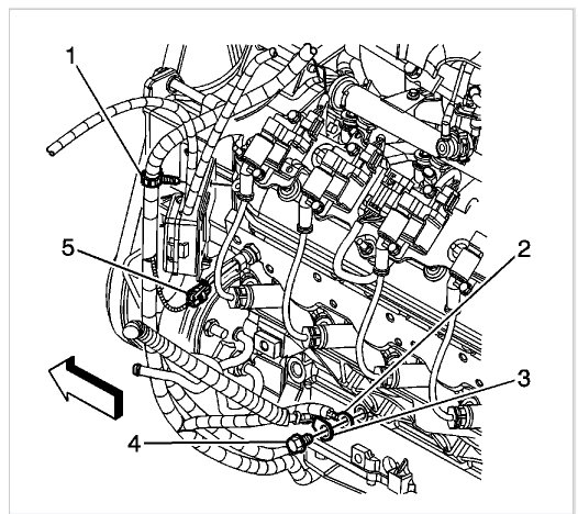

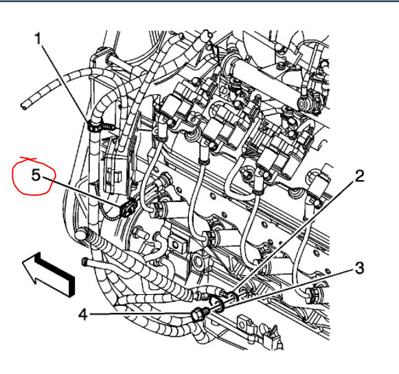

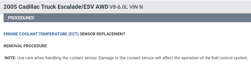

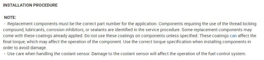

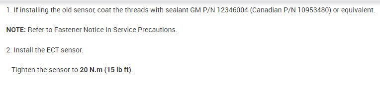

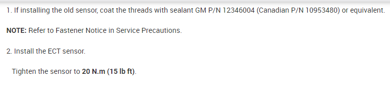

Here is the information you requested. Here is a tutorial showing how to replace a coolant temperature sensor:
https://www.2carpros.com/articles/coolant-temperature-sensor-cts-replacement
I've attached picture steps below on how to replace the coolant temperature sensor and its location on your vehicle. Hope this helps and thanks for using 2CarPros.
