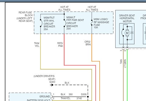

The drivers side seat heater does not work. The passengers side works fine.
How can i fix this.
Thanks
Jun 1, 2009 at 8:45 AM
FACTORYJACK
  • 4,159 POSTS

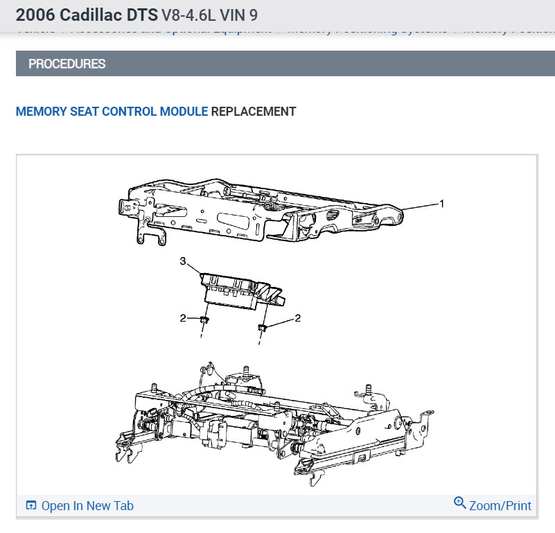

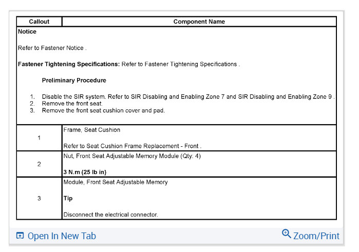

The first thing I would do is check the fuses for the seat here is a guide to help and the seat wiring diagrams below so you can see how the system works and which fuses to check.
If the fuses are okay it sounds like the seat positioning module has gone out. Check out the images (Below). Please let us know what happens.
