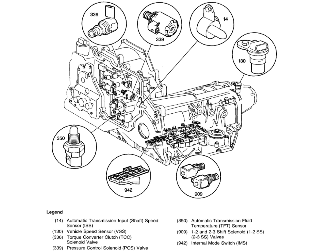

This is common when the torque converter control solenoid goes out here is the location so you can replace it after in which you should clear the codes. Check out the diagrams (Below). Please let us know what happens.

Thanks for the information I got a new solenoid and installed it which was not the easiest but after my buddy helped me I got the job done it fixed it which paying for a new transmission this site is wonderful.
