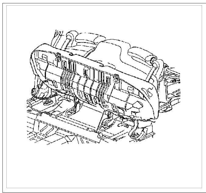

I am trying to lift rear seat up and out to gain access to Battery. No matter how hard I pull push or tug, the seat will not release so I can pull it up. Is there a tool I can use to force it up or can I reach any clips or fasteners that are holding it down. I have got into the back and tried pulling up on both sides together. It will not move, just the top cover comes up a few inches.

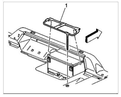

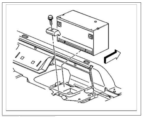

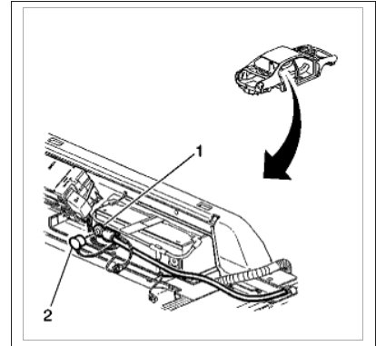

You must lift the rear seat cushion here is a guide to help you see what you are in for doing the job.
https://www.2carpros.com/articles/how-to-replace-a-car-battery
Here are diagrams to help you see what it will be like for your car
Cheers
