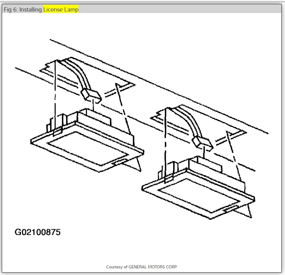

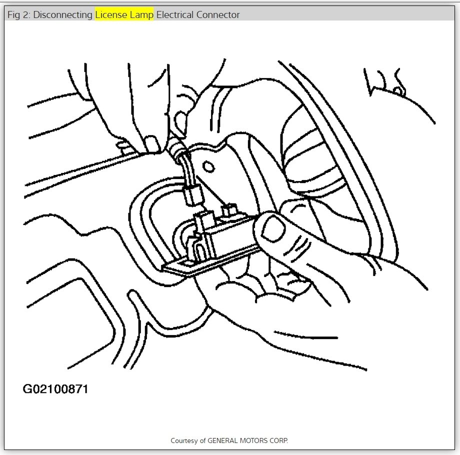

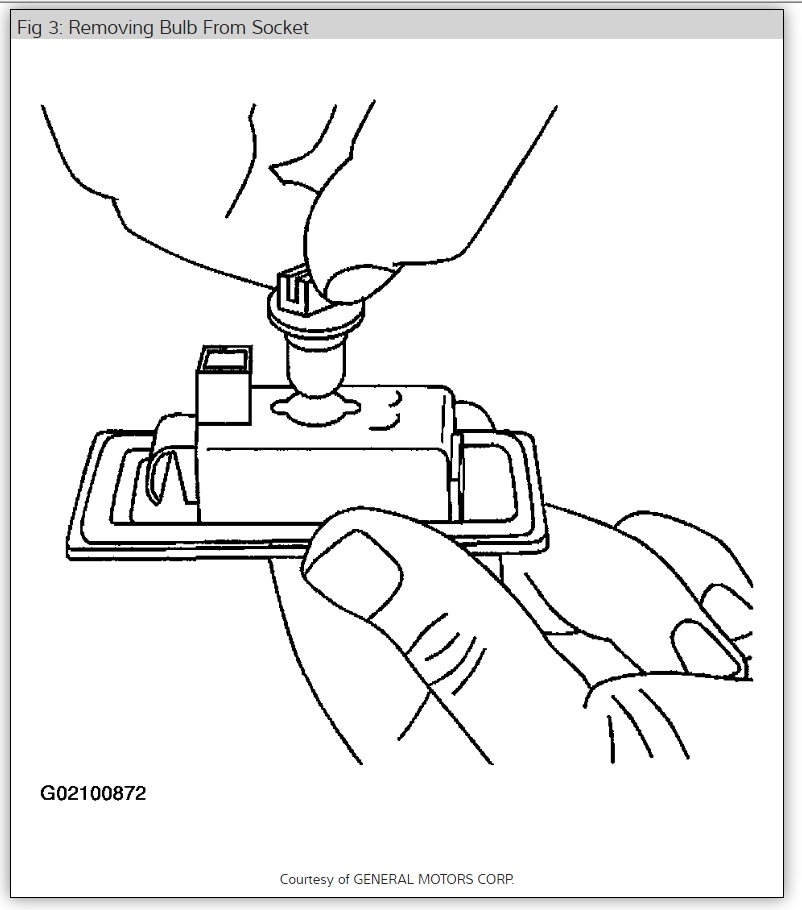

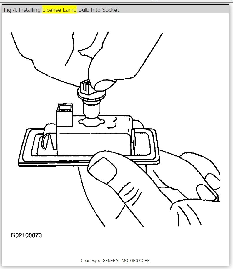

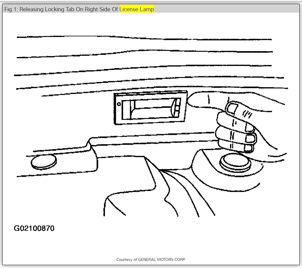

I wouldn't worry the car cannot tell if this light it out and the dealer probably overlooked it. This bulb is easy to change and will only take a few minutes. Check out the diagrams (Below). Please let us know if you need anything else to get the problem fixed.
