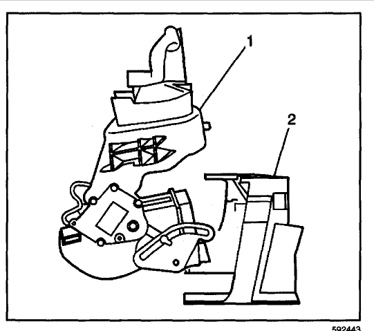

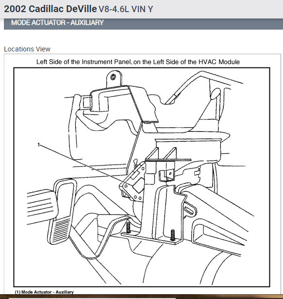

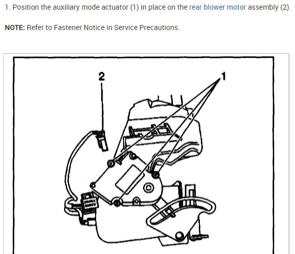

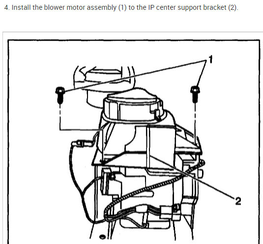

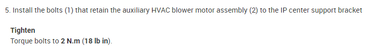

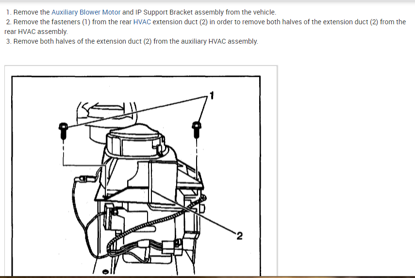

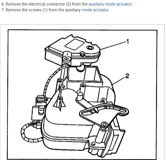

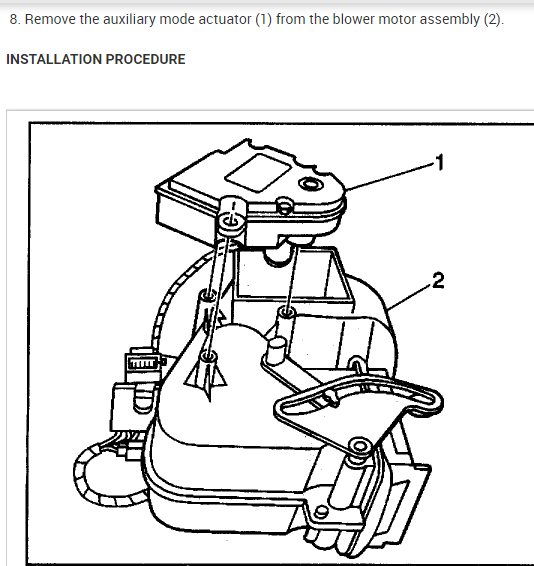

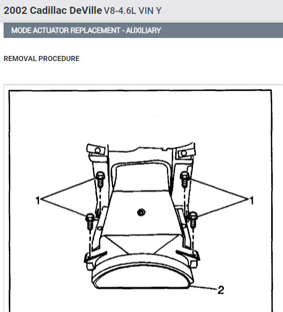

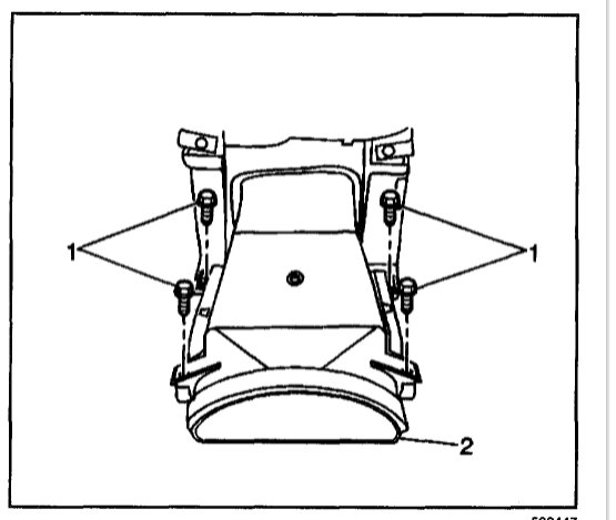

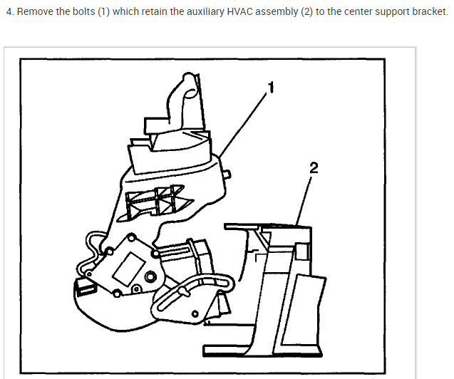

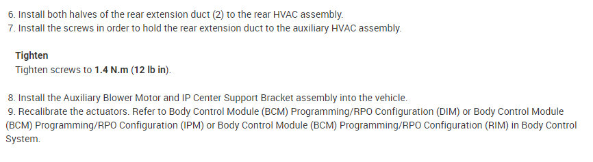

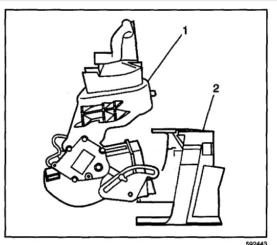

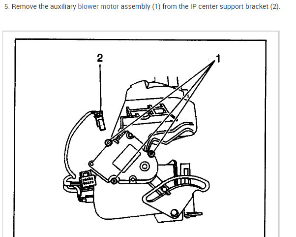

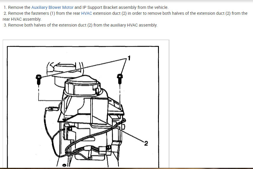

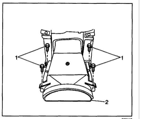

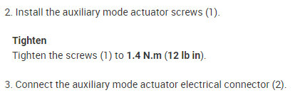

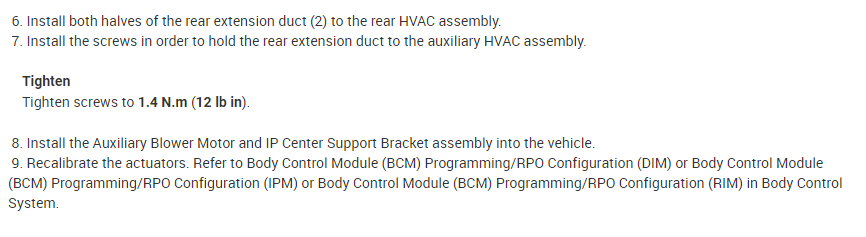

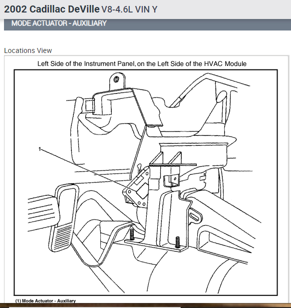

Here is the information you requested. It sounds like you are having an issue with the auxiliary mode actuator which is not opening to provide cold air. Here is a tutorial showing how to replace a blend door actuator which is similar:
I've attached picture steps below on how to replace the auxiliary mode actuator on your Cadillac. Hope this helps and thanks for using 2CarPros.
