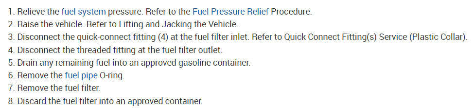

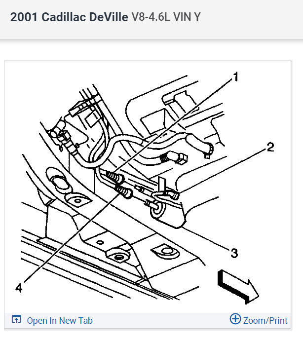

I don't think so, it sounds like the fuel pump is going out or the fuel filter needs to be replaced, here is the location of the fuel filter and a guide to help you understand what the problem is.
https://www.2carpros.com/articles/repair-lean-mixture-codes-p0171-or-p0174-on-some-manufacturers
Fuel pressure should be
Key On Engine Off 41-47 psi
Check out the images (below). Let us know how it goes.
