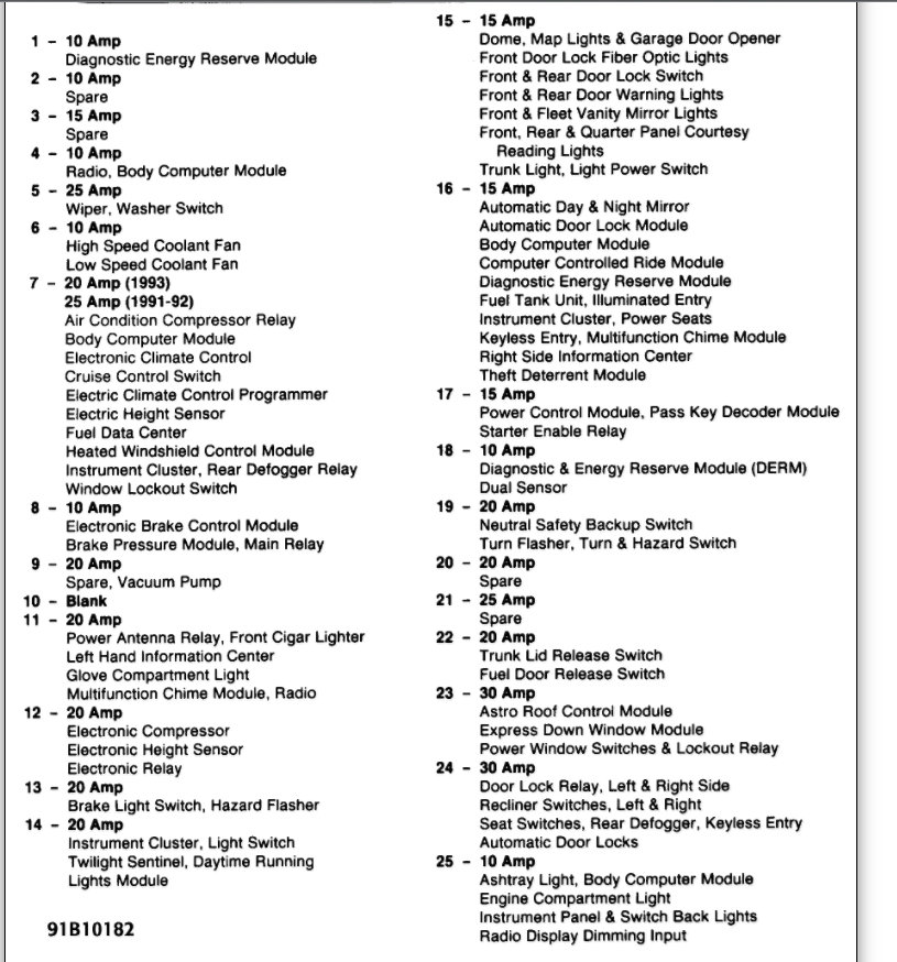

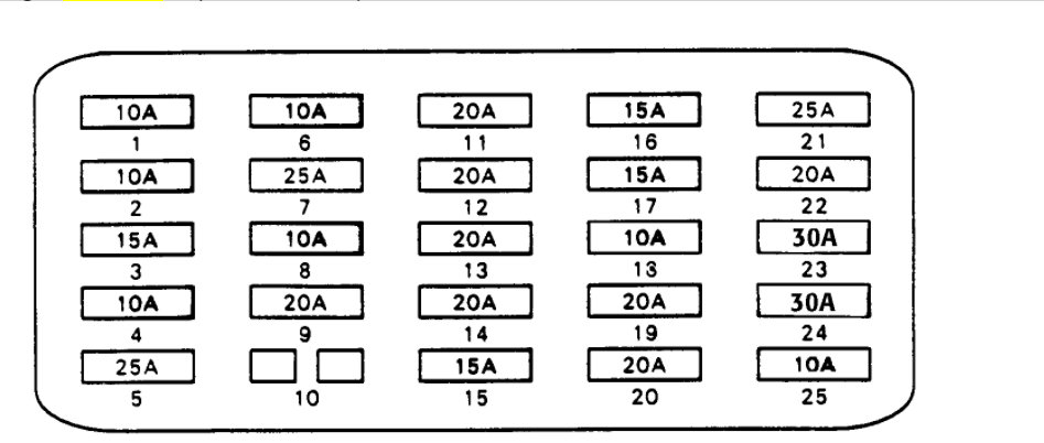

Everything on my car works fine except the two power outlets in the two back door (formerly called cigarette lighters). I assume it may be a fuse problem, so how do I find the right fuse?
In fact, where can I find a fuse diagram for all the fuses in this car. Fuses in the fuse box under the driver's side of the dash are mostly marked, but some have no label. And I can find no label to identify any of the fuses under the passenger's side of the dash.
Somewhere I read that there are also fuses under the hood or in the trunk, but I can't find either.
