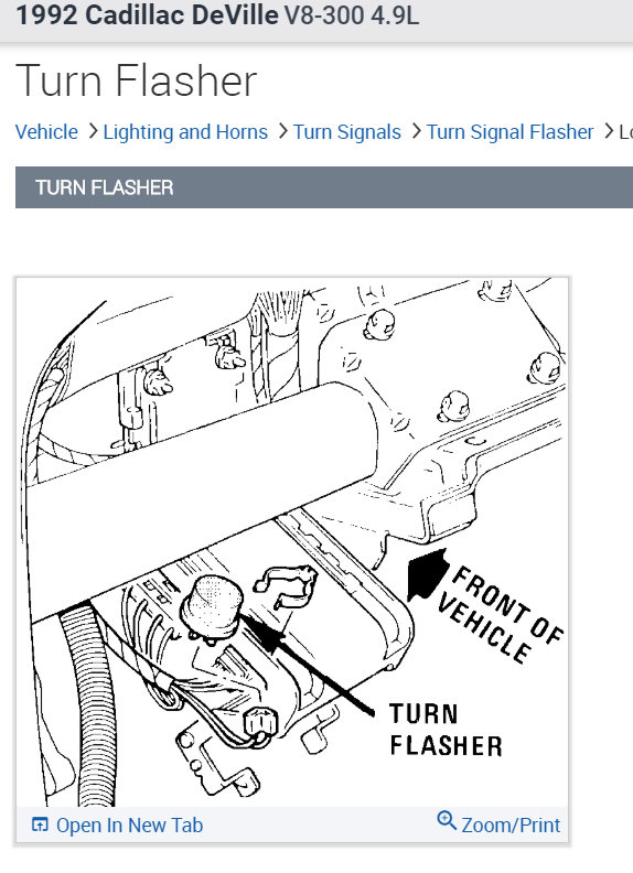

Probably not a fuse, more likely a turn signal flasher. There is a hazard and turn signal flasher under the dash. You can swap them to see of the problem moves to the hazards. I "think" it should look like a 1 1/4" diameter, silver cylinder about 1" long here is a diagrams below. Check out the diagrams (Below). Please let us know what you find. We are interested to see what it is.

You said the turn signal flasher is located under the dash on the 1992 Deville it took awhile to find but once I replaced it the signal are working again! I love this site.
