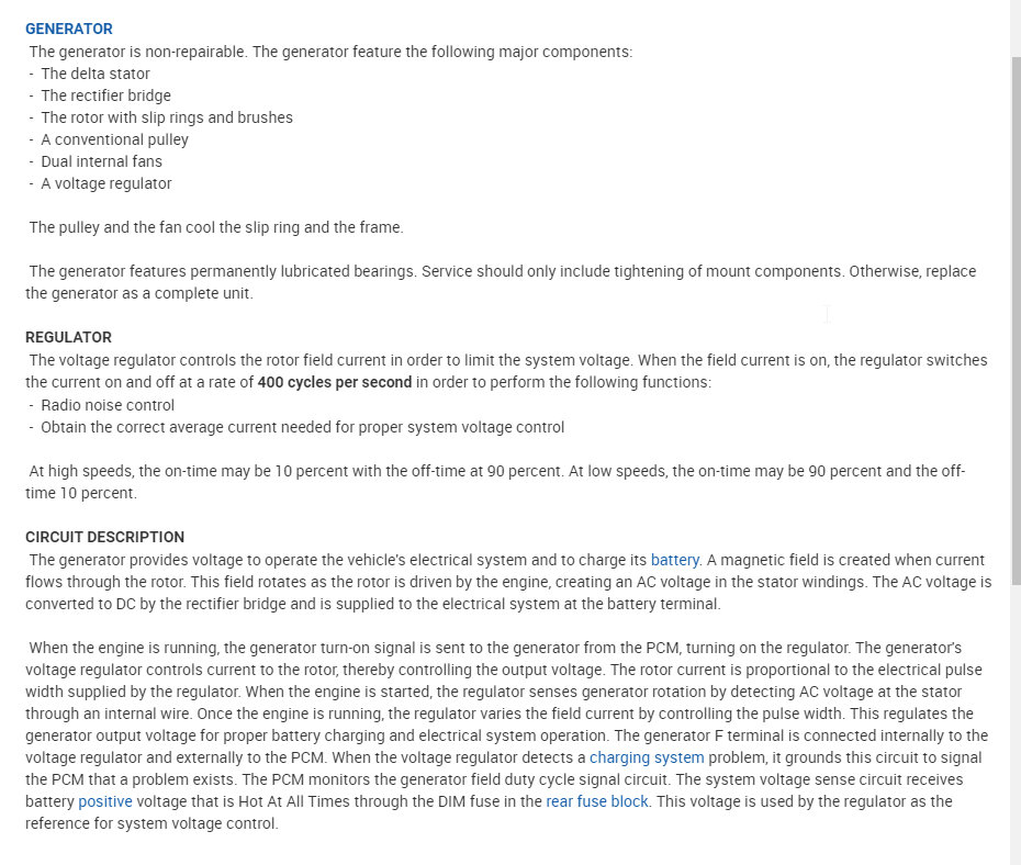

We need to start with pulling codes. This sounds like a crankshaft sensor but since you replaced that we need to see if the computer is seeing the issue.
If there are no codes then I can only assume there is an issue with the PCM. The voltage regulator is in the alternator but the voltage is sent to the PCM and I am thinking the PCM is causing the voltage issue.
Let's start with codes and go from there. Thanks

Yes. ECU or PCM or ECM are all the same thing. ECU is more general because it stands for electrical control unit so any control module can be an ECU. ECM is Engine control module and PCM is Powertrain control module.

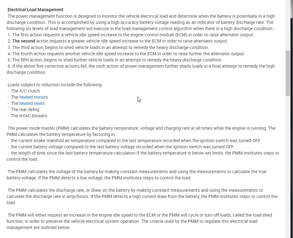

The reason I suspect the ECM/PCM is this has the ability to shut the vehicle off and cause the issue you are seeing. It isn't supposed to shut the vehicle off but if it looses power or the crank signal it will think the engine just shut off and turn everything else off. It is supposed to perform what is called load management but this is not happening.
The only thing I am not confident about this is when you turn the key again it just clicks. This points to a wiring issue but if that is the case, with no codes, it is going to be very difficult to figure out without a little more to go on.
Do you have a scan tool that can monitor live data? If so we need to find out what the ECM is seeing on the input sensors.

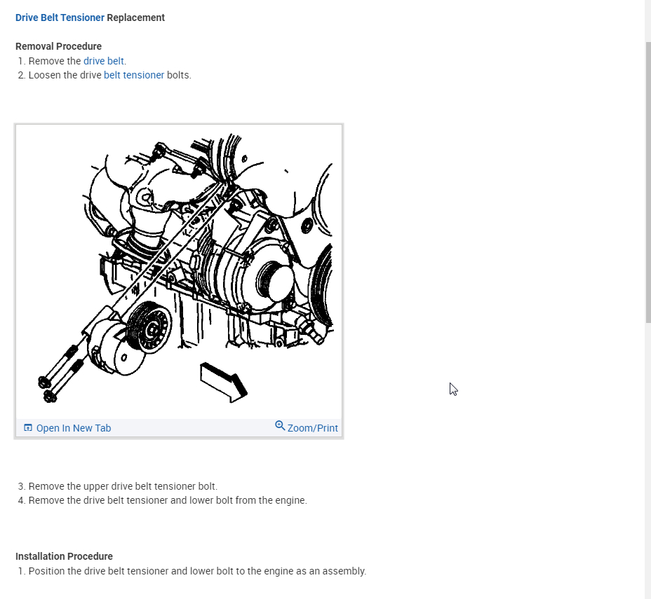

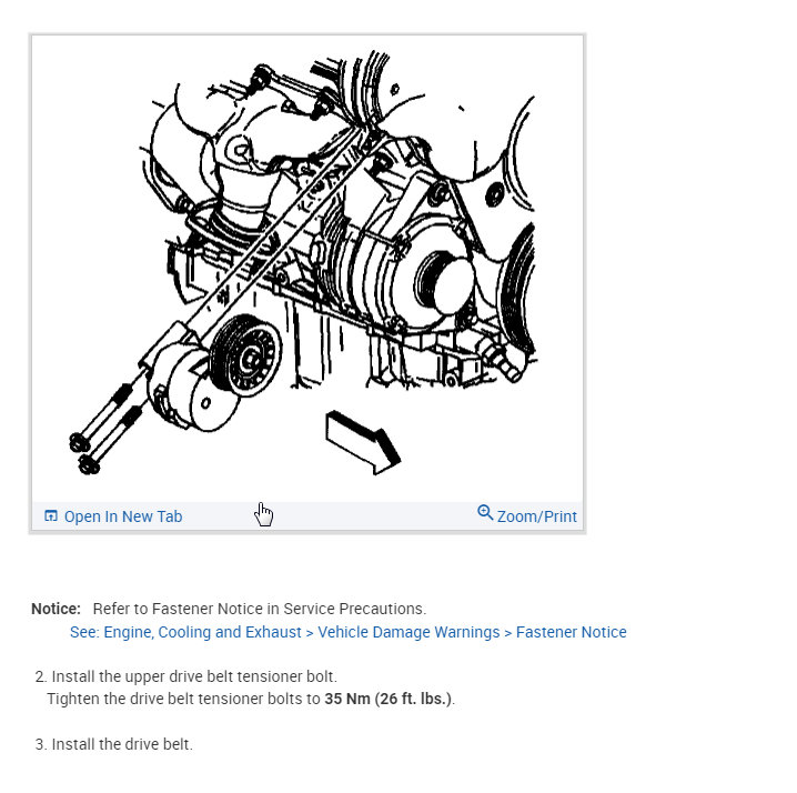

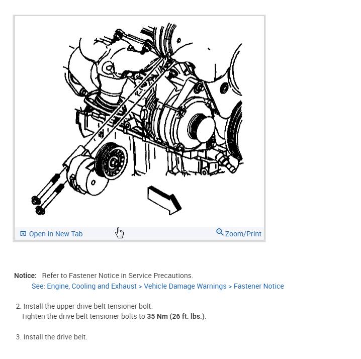

Okay. I am thinking this is one of two issues. First the easier of the two is the belt tensioner. I asked a GM dealer if they heard of this and they have. Apparently this issue is not that uncommon. They said that when the engine is under load coming to a stop and the tensioner is not holding proper tension on the belt that the voltage drops and once it reaches about 12.5 volts while running the PCM shuts the engine off.
Then other issue is the PCM itself. Unfortunately they didn't give any way to test this other than hooking a volt meter up to the battery when it is happening and monitoring the voltage the ECM is seeing. If it differs then the ECM is most likely the cause.
