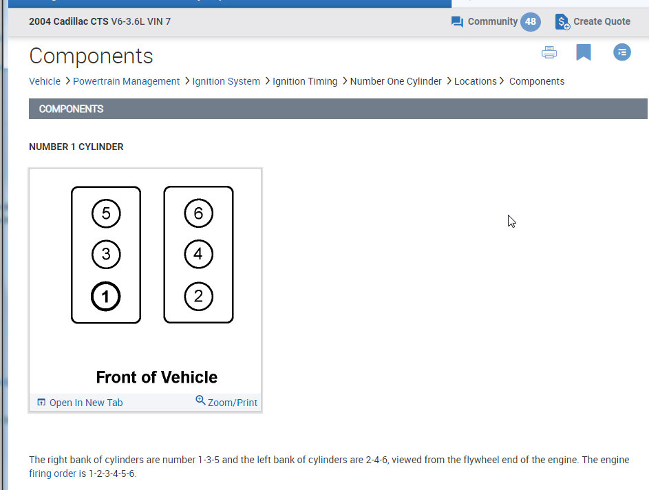

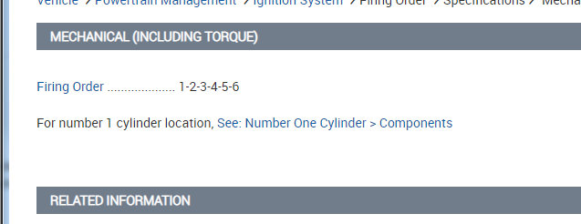

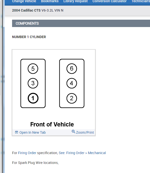

where is the number thee cylinder located on my cts.
Oct 12, 2010 at 7:18 PM
CERTIFIED EXPERT
18,907 POSTS
I am attaching the info for the 3.6 and 3.2L. They turn out to be the same but they are both attached for your review. Let us know if you have other questions.
