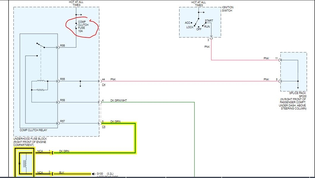

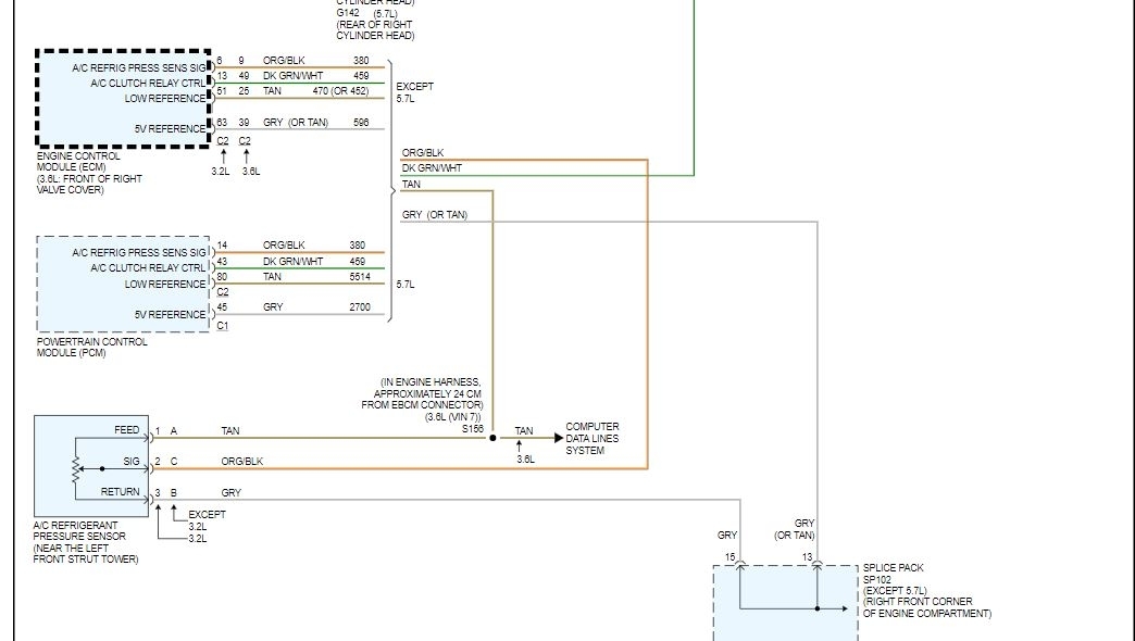

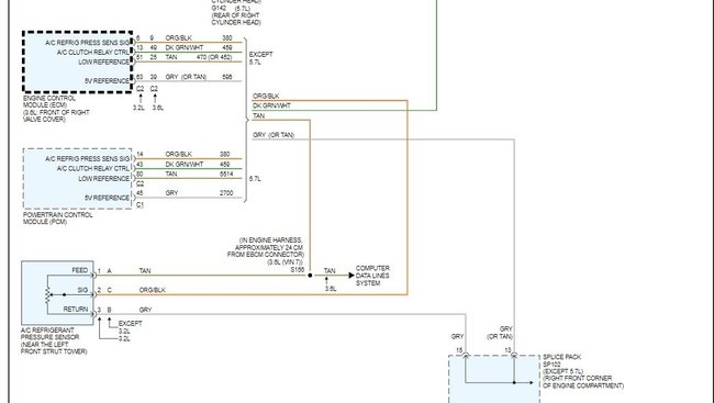

Beyond that, it could be electrical. I attached a wiring diagram for you to view. Check the fuses for power on both sides.
