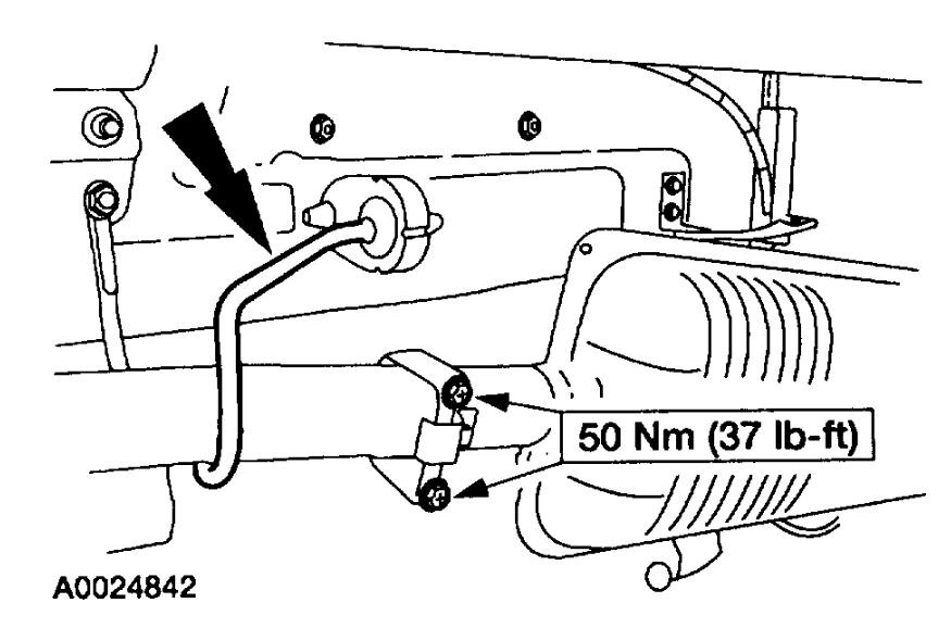

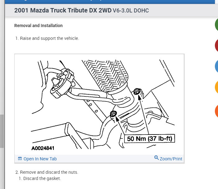

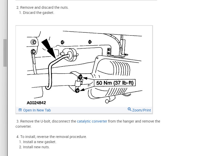

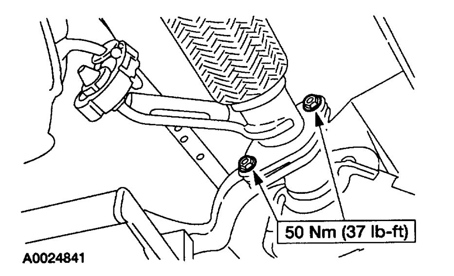

It is right off the exhaust manifold. I attached two pictures for you to view. Check out the diagrams (Below). Please let us know what happens.

CERTIFIED EXPERT
18,907 POSTS
In addition to this info, I am attaching the process on how to replace it.
Also, here is a guide on how to test the converter:
