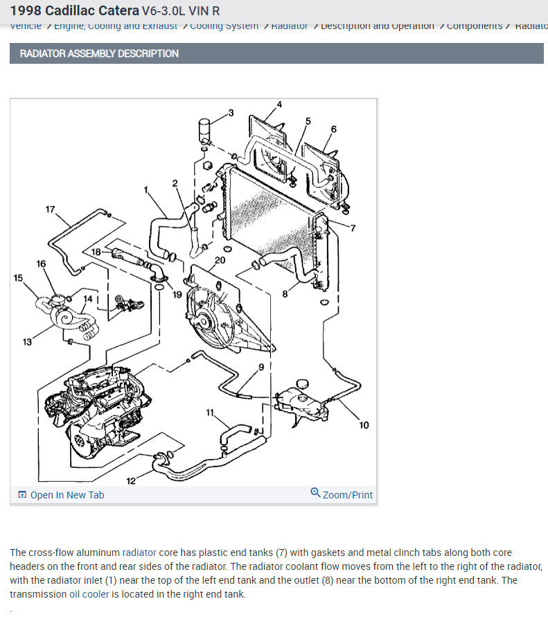

I have a coolant leak that has gradually gotten faster. The coolant leaks out of a crack in the black plastic casing just to the right of the radiator. I'm not sure if I will need to replace a hose or the entire radiator. My husband has tried to patch the leak, but every time I travel more than 10 miles at a time it cracks back open again, leaks out and overheats. Is there any way to just replace the cracked part or will I need a new radiator?
