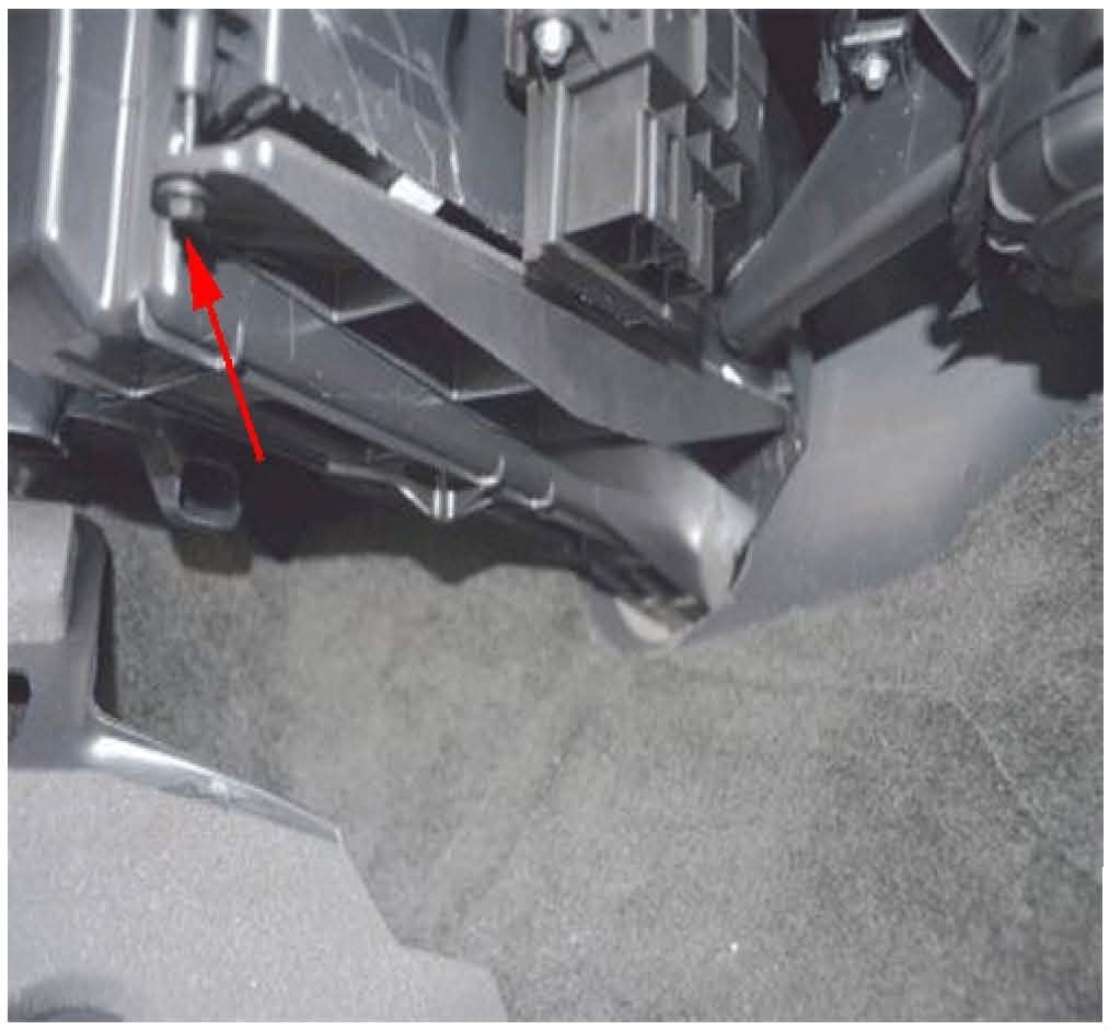

My reference says this vehicle was not factory equipped with one.
However, due to complaints of dust intrusion into the cab, they offered a kit whereas you do/ did a little chopping and install the kit.
Presto!
You have filter.
Whether you have this modification or not is up to you to investigate.
Below is a picture of the modification.
