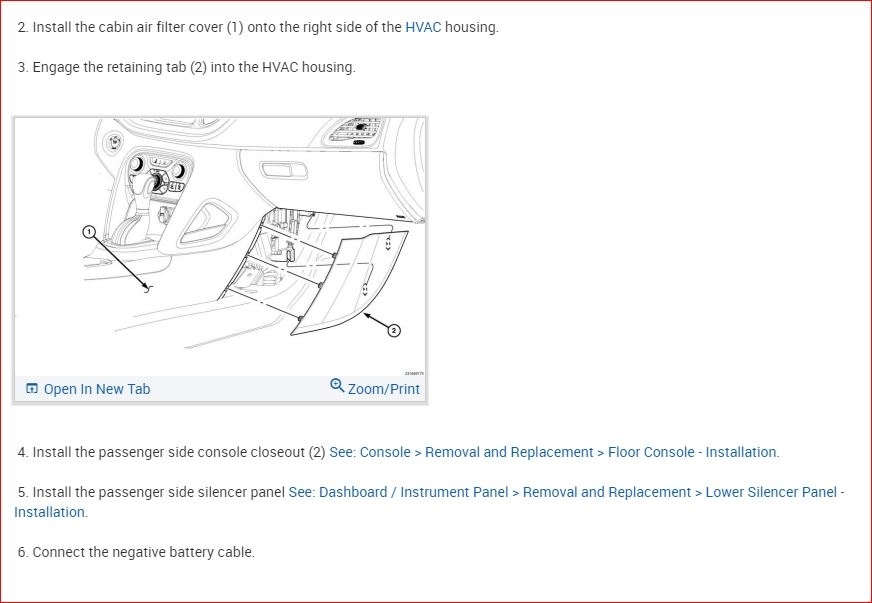

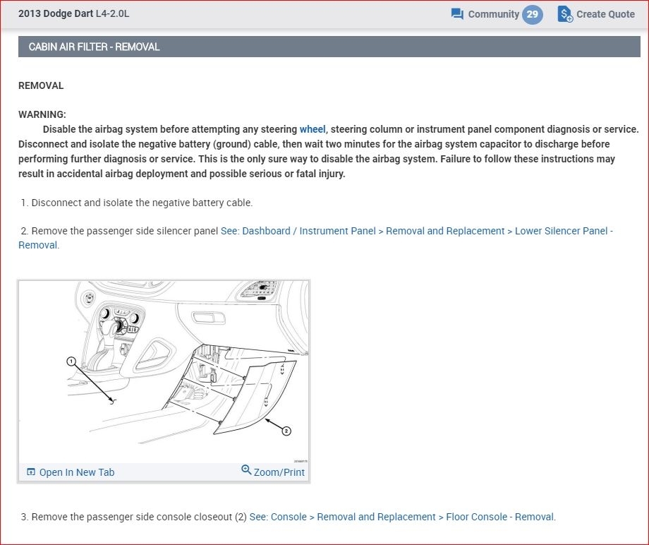

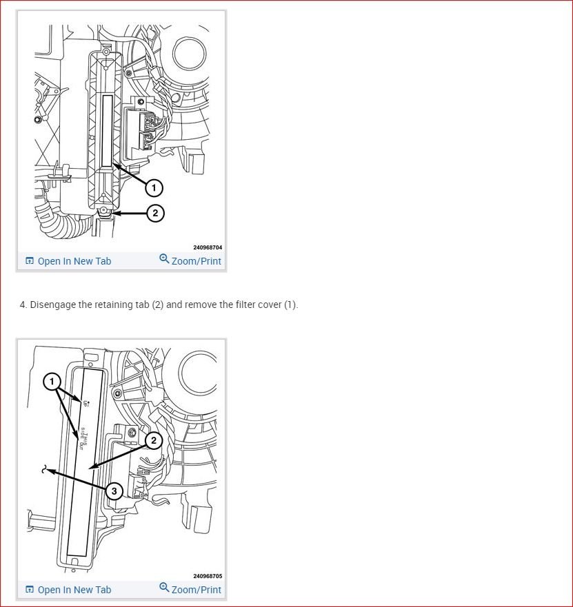

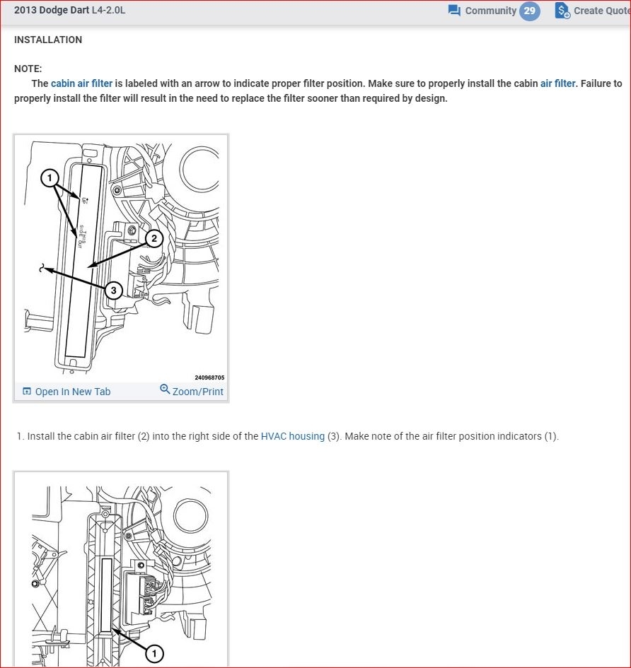

Does my car (listed above) have a cabin air filter ?
Jun 6, 2019 at 12:03 PM
CERTIFIED EXPERT
18,907 POSTS
Hi Chuckie,
Yes. It does. Attached you will find the procedure on how to replace it.
Please let me know if you need more information. Thanks
