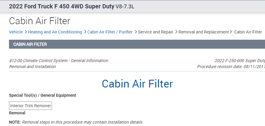

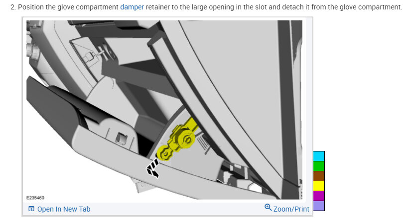

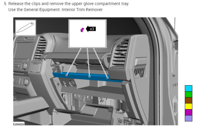

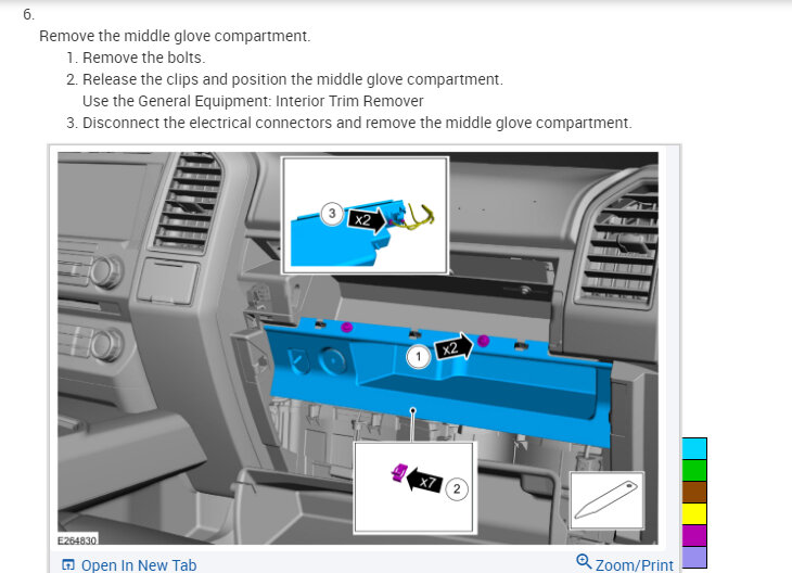

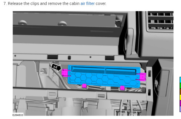

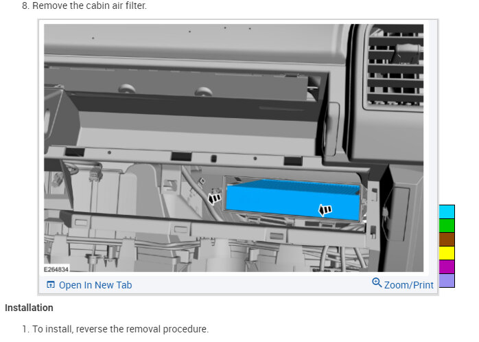

My manual goes up an F450, but they should be the same.

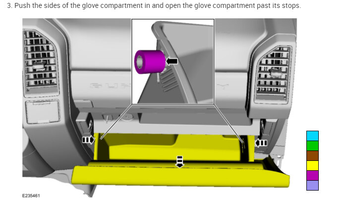

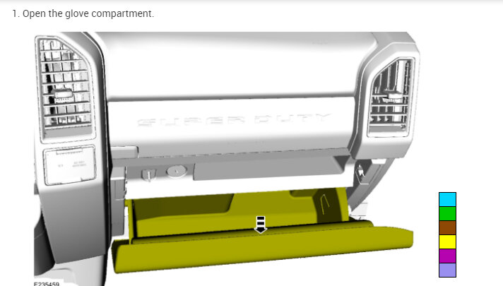

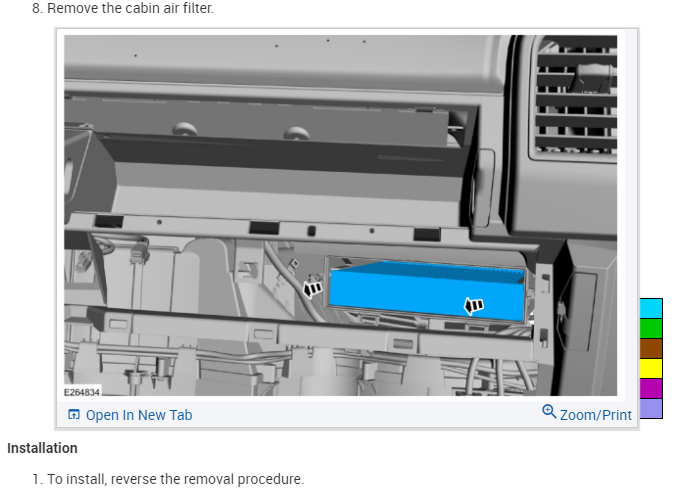

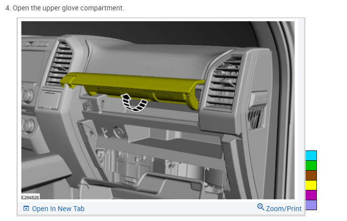

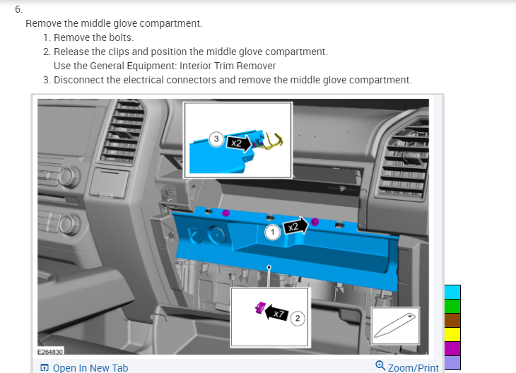

As far as the location, it is behind the glove box, but there is a little more involved to access it.
If you look below, I attached the directions for replacing it. Take a look through them and let me know if it helps.
See pics below.
