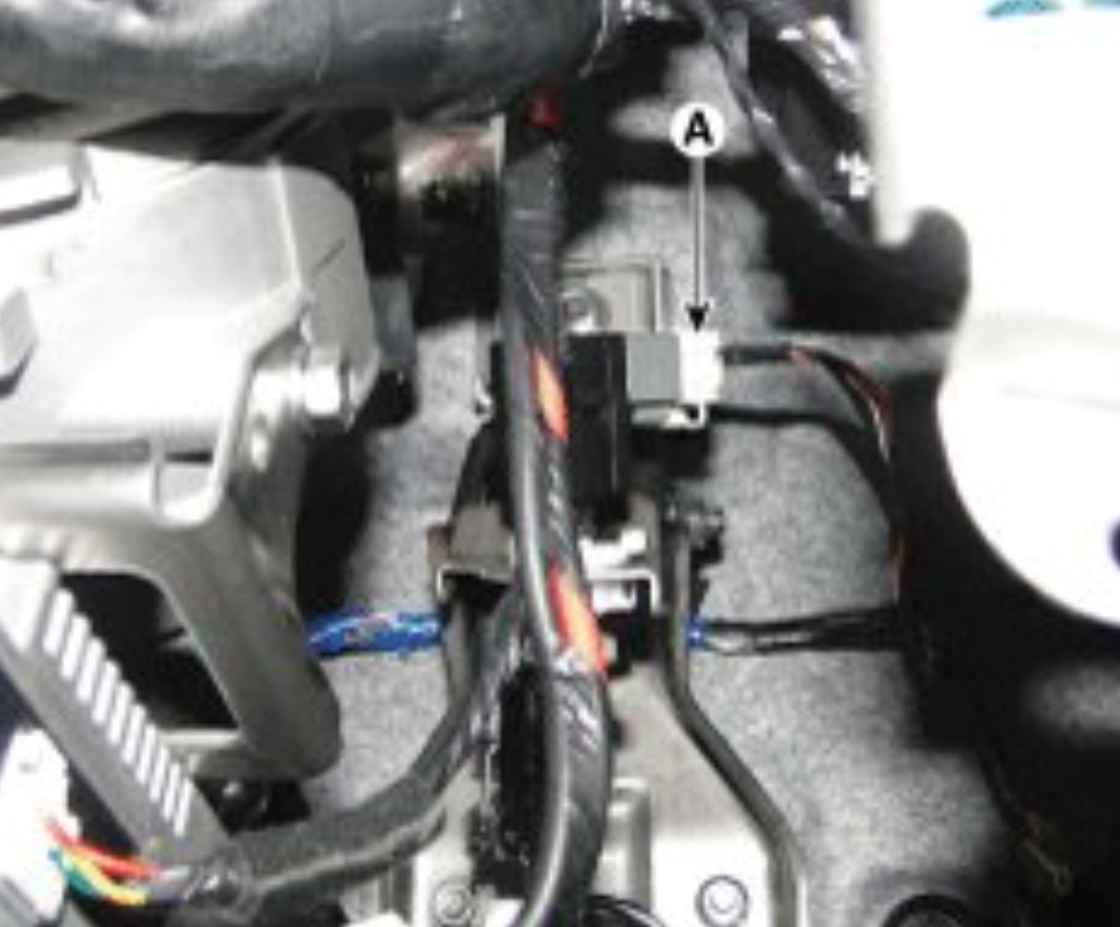

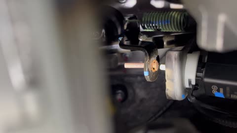

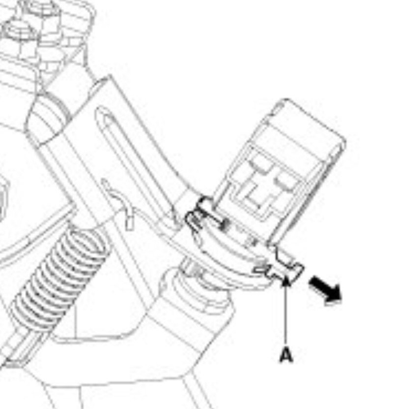

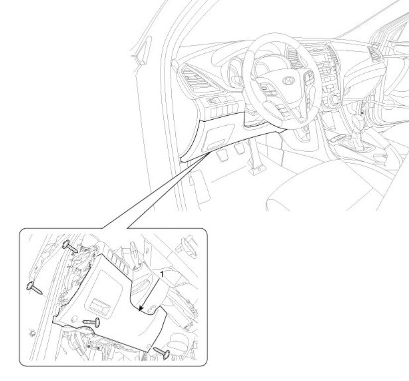

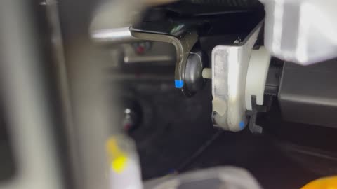

The battery on this car was drained and I suspect that the rear brake lights came on unexpectedly after parking the car for the weekend because the neighbor mentioned that. However, after jumping the car, charging the battery after driving the car and idling the engine, everything seems to be okay. I parked the car and brake lights did not come on overnight and the car started in the morning. The car has been okay since the one time the battery drained, but I feel that it is intermittent. Therefore, I took the car to AutoZone and it passed the battery, charging and starting system check. I also had the OBDII scanned, and everything was okay except the computer stored a C1513 Brake switch circuit error code. I suspect that the stoplight switch is intermittent. That is all I can think of. Any thoughts on this and if it might be the stoplight switch, can you provide detailed steps, diagrams and procedure to replace and adjust the stoplight switch please?
