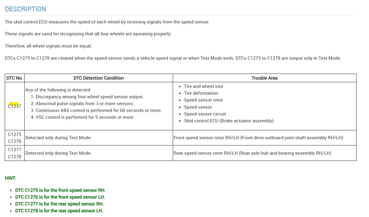

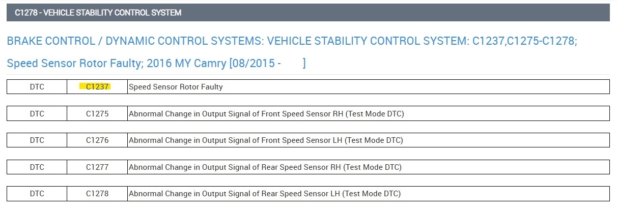

So after I rotated my tires my car started malfunctioning. Somehow jacking it up triggered it. When I drove it after I was done with the tire rotation my traction control would kick in at approximately 20 mph and would be in low power mode. If I manually turned off traction control it would drive normally but would turn back on if I would come to a complete stop and go again. It’s not showing a check engine light either. I hooked up a scanner tool and got a c1237 error code. Says Speed sensor rotor faulty.

Hello, are all the tires on the vehicle the same size? And when jacking it up, I would check the locations where the jack or jack stands were. This is a speed sensor code, so there may have been some wires either damaged or the harness was pulled in some location, check to make sure all the wheel speed sensors are still plugged in at each wheel, you should be able to see the connectors easily. Since there was no fault codes before the rotation, I would think the tires are all the same and the wear on them is roughly the same, if it was one tire that the speed sensor signal was faulty on, there would be a code for that specific tire, but this a speed signal that's not correct, so start with checking all the wiring, also verify there is a speed indicated on the instrument cluster.

So I think I have it figured out. Turns out the last time I got new tires they put the wrong size on. I buy them in pairs so my newest 2 are the -65 and the other 2 are the -55. My car calls for the -55 size. Which makes more sense now since this happens when I rotate my tires. It started in December of 2023 and that was the year I purchased 2 new tires. I will update on the final verdict but I'm pretty sure this is what is causing the issues.

Yes that will cause those types of codes to set, the tires all need to be the same size, or they will register slightly different speeds. With all the same size, you can clear the codes and should be all set. Even without clearing the codes, if the fault is resolved the traction light shouldn't come back on.
