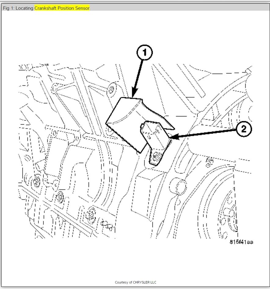

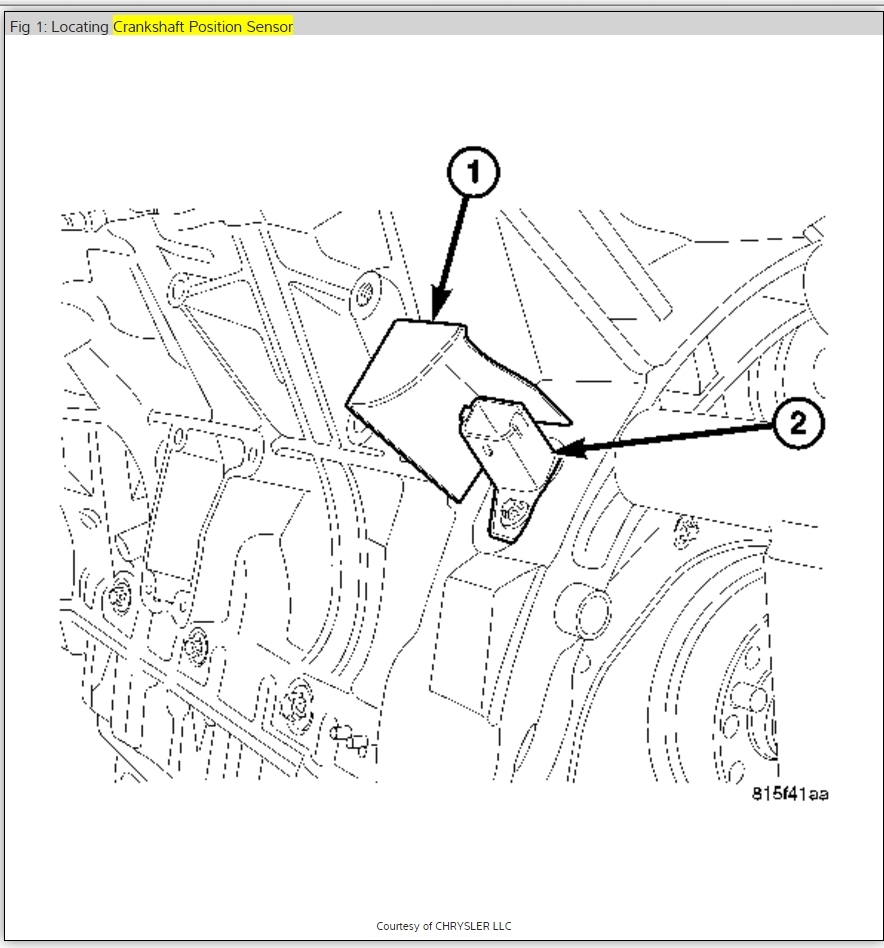

If a code P0016 is present it can cause the C121C which is request for torque denied. P0016 is camshaft/cranshft correlation problem which can be caused by a defective crankshaft angle sensor CKS, check out this guide which gives you the idea on how to change yours,
your is located here:
