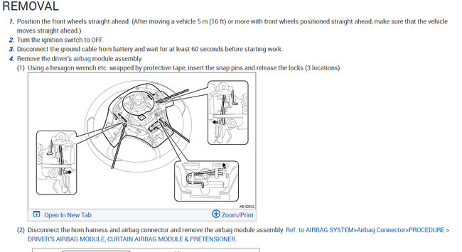

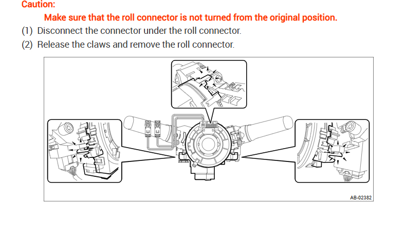

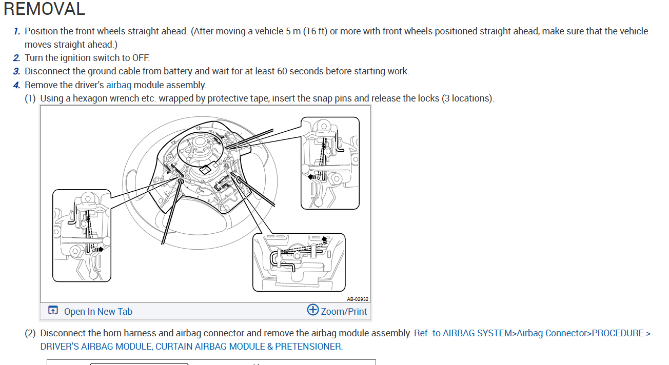

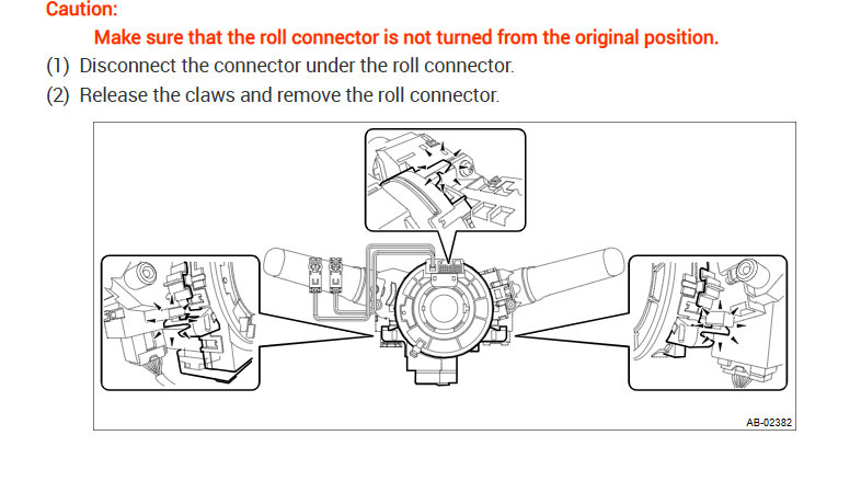

The C0074 code is stored when the VDC/ABS control module detects an electrical fault or invalid signal from the steering angle sensor, which measures how far and how fast you’re turning the steering wheel. To clear the code you must fix the problem first. So you will need to disconnect the battery and remove the airbag and steering wheel for the replacement. Check out the images (below, emailed as well). Let us know if you need anything else.
