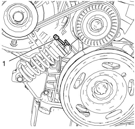

Your best bet would be to use a tailor's tape measure or a length of string and measure the length of the replacement belt around the pulleys with the tensioner retracted and locked in position. See picture 2 below
Once you have the length simply go to your nearest auto parts store, I would suggest adding a few millimeters extra to the measured length to aid installation

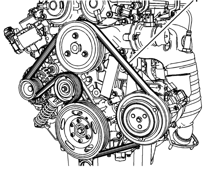

See belt routing in picture 1 below (with A/C)
