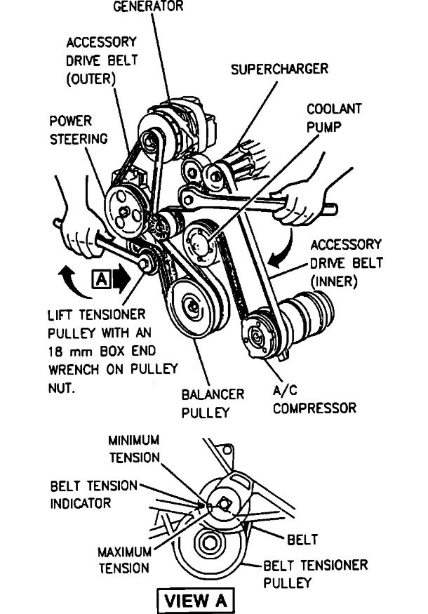

My supercharger does not work. I got a shorter serpentine belt but am not sure how to bypass the supercharger. Do u have a diagram or a video?

The car will run with the S/C bypassed (Not running) but the vehicles performance will suffer greatly since the blades in the S/C will impede intake air flow
Belt diagram is attached below
