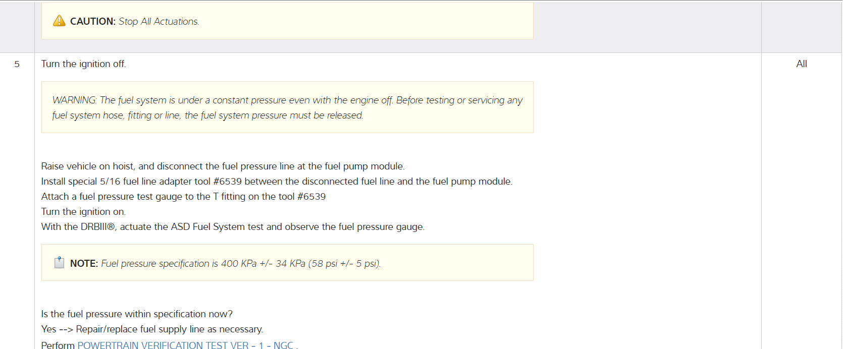

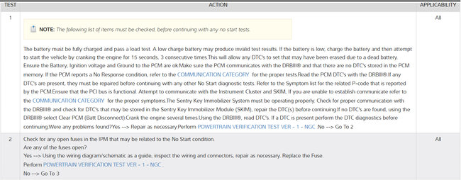

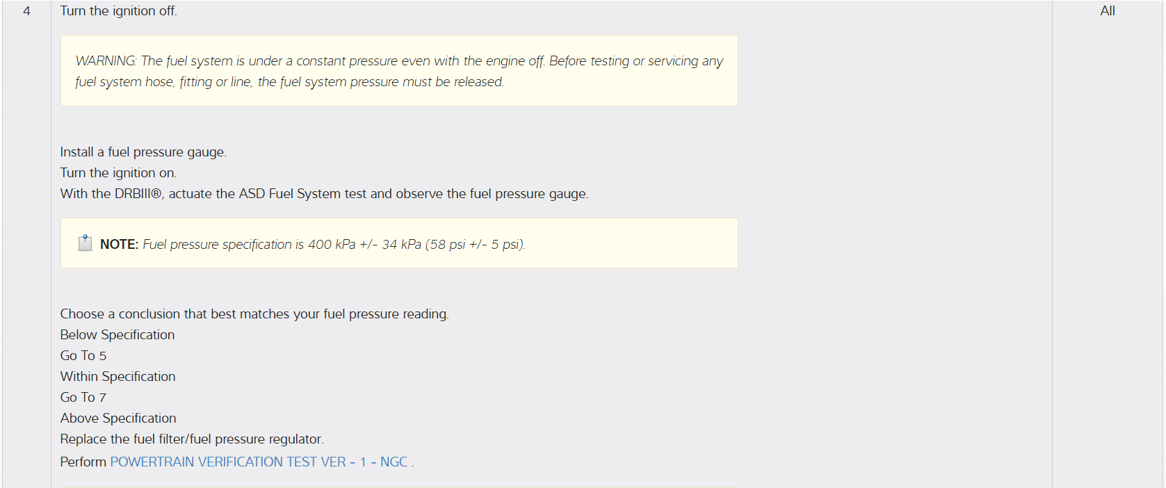

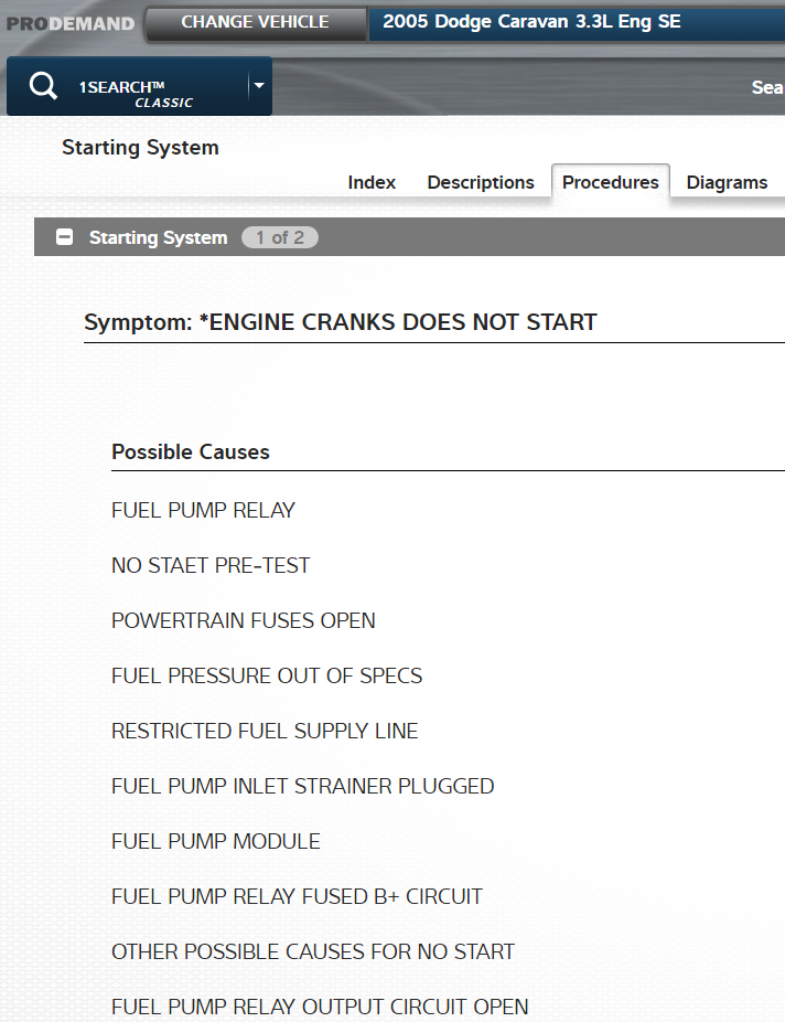

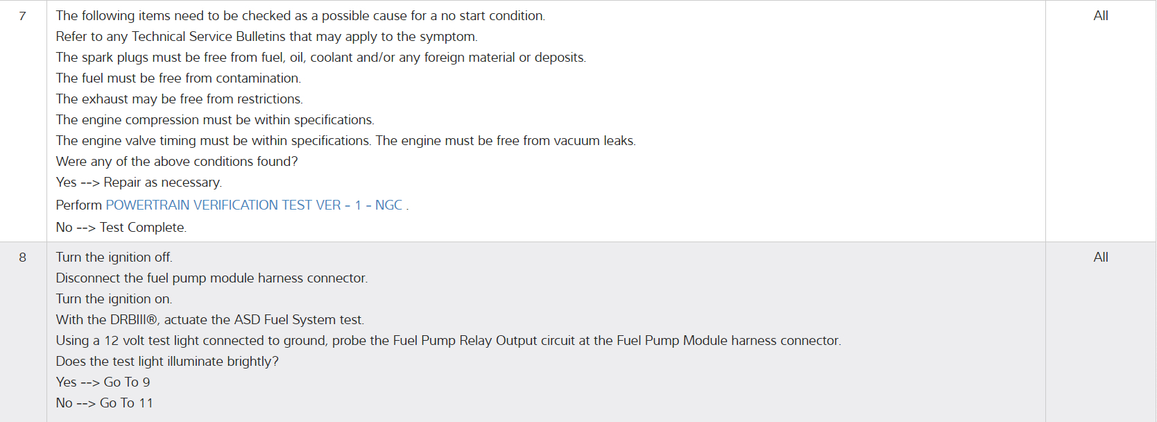

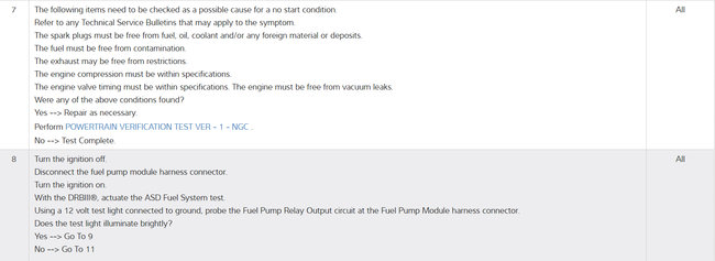

This could be a problem with the starter or the wiring going to the starter itself. Below I have included a link for you. They are troubleshooting guides for you to go through.
https://www.2carpros.com/articles/starter-not-working-repair

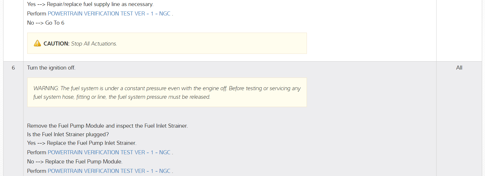

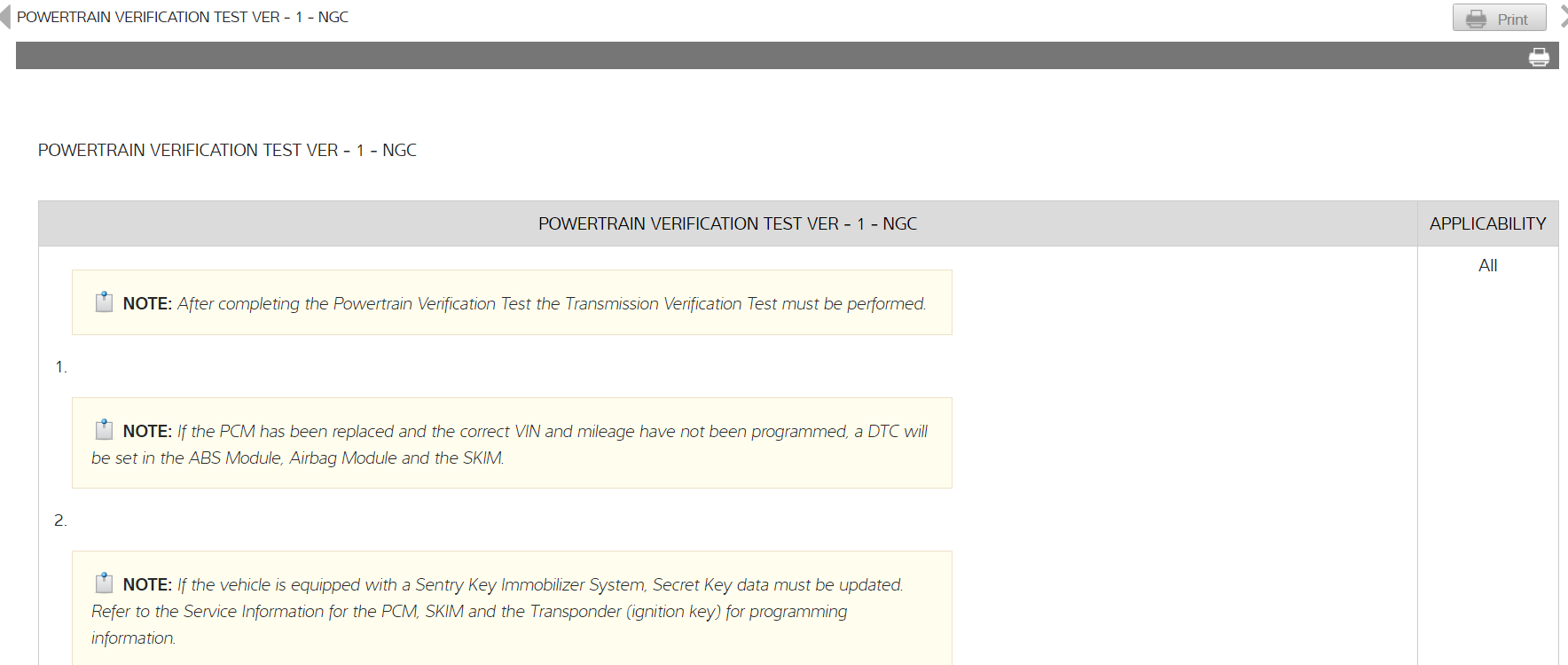

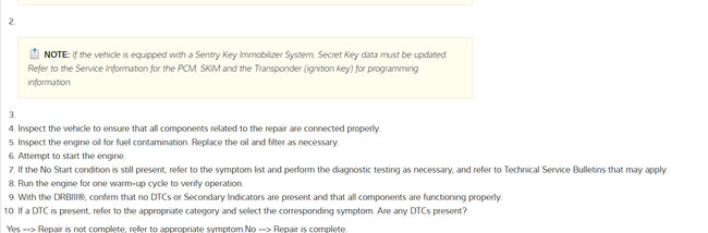

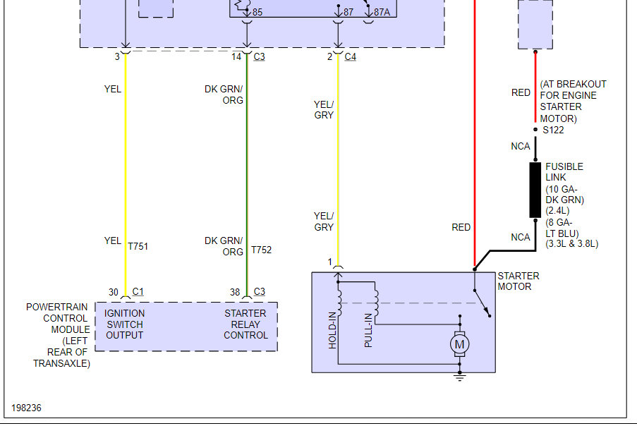

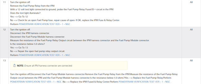

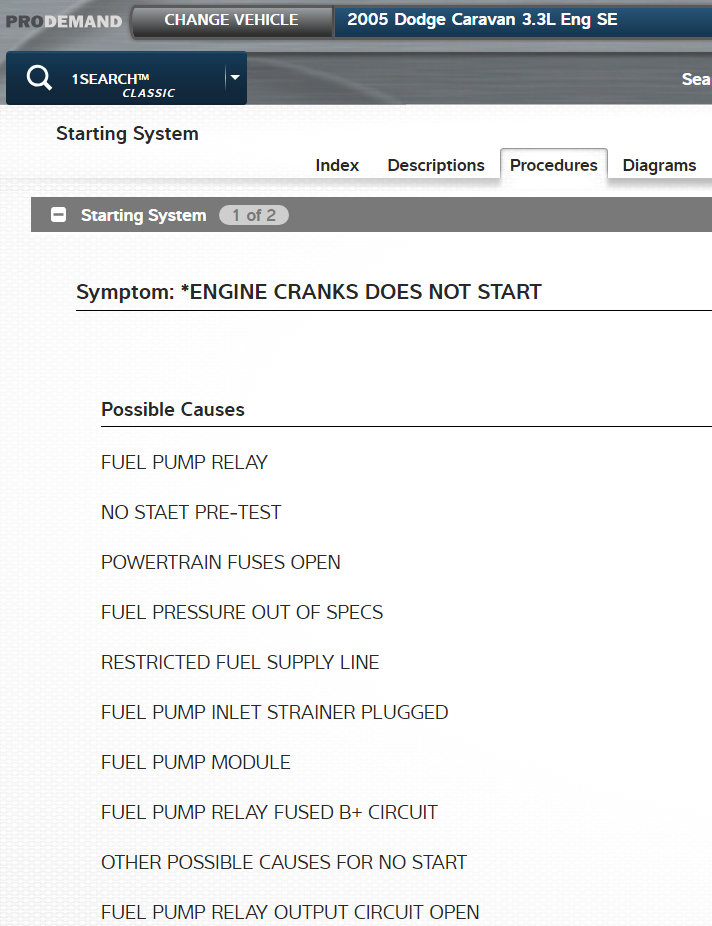

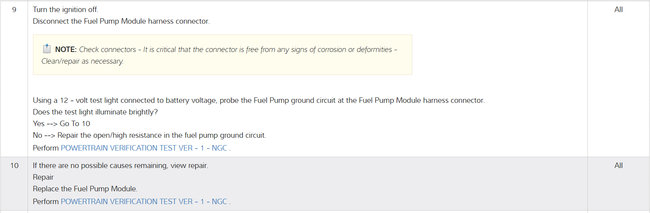

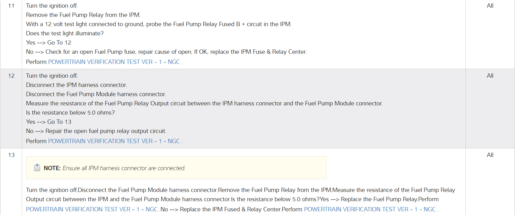

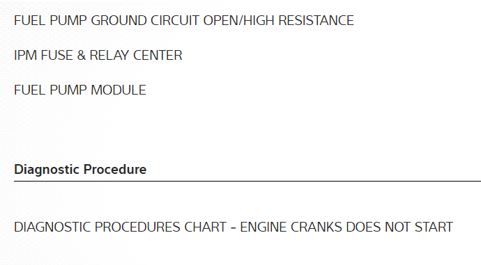

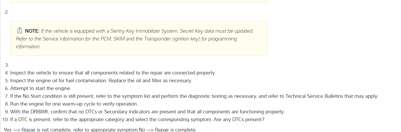

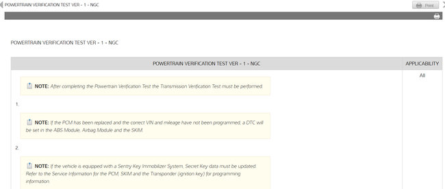

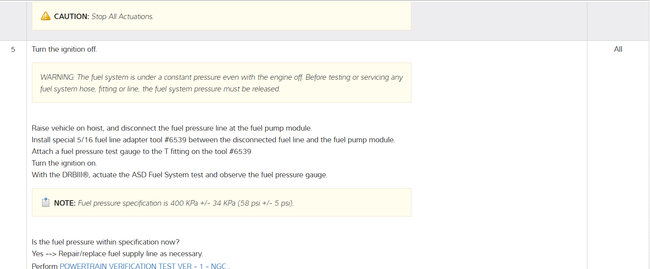

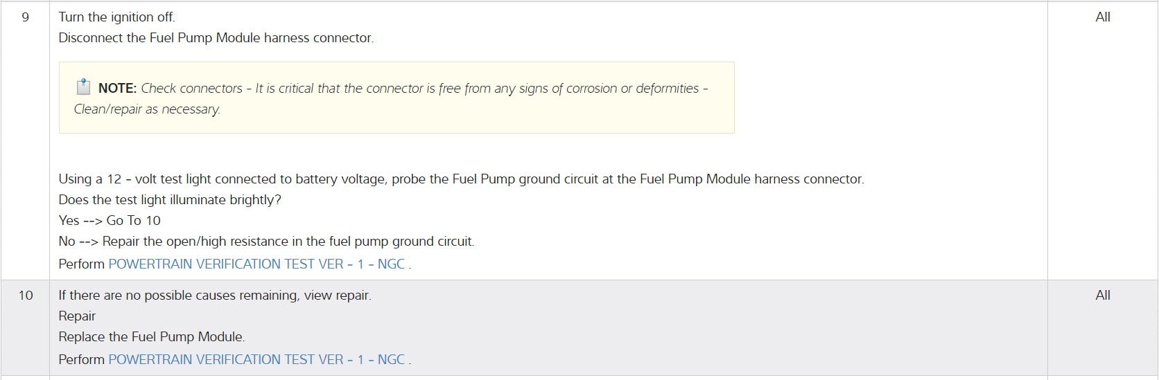

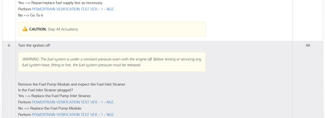

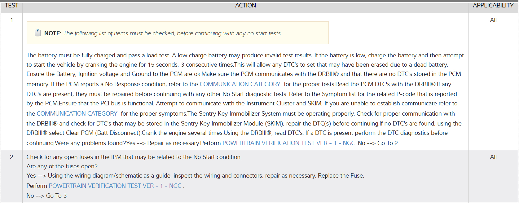

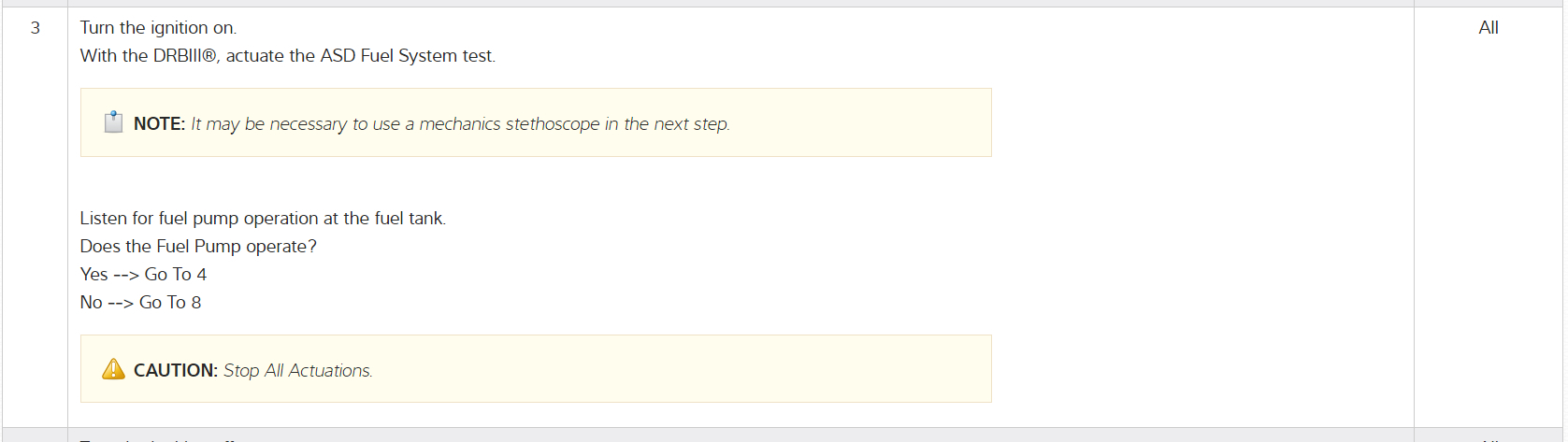

Also I have included in the diagrams down below a step by step troubleshooting flowchart from the manufacturer on your vehicle for it's problem. Please go through these guides and get back to us with what you find out.

It's getting fuel. I forgot to mention I already checked for pressure and it has tons. Has spark as well as did a compression test.

Okay, did you happen to get a chance to go through the factory troubleshooting flowchart that I sent a couple of messages ago? I think that will zero in on what the issue is. Please go through it and let me know what you find out and we can go from there.

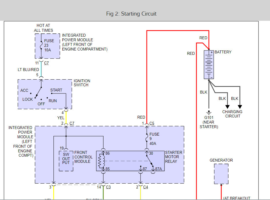

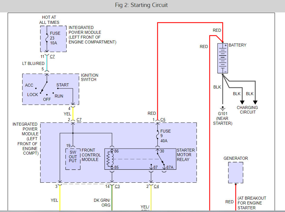

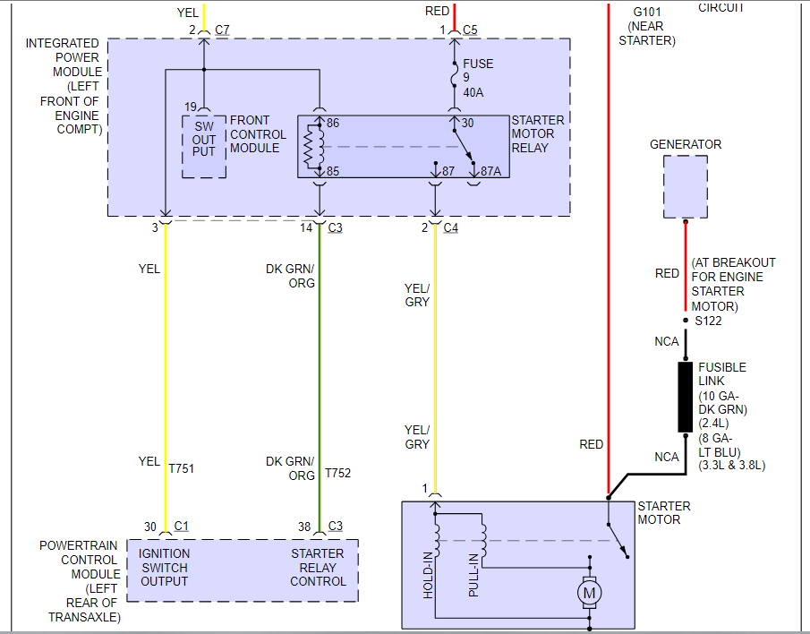

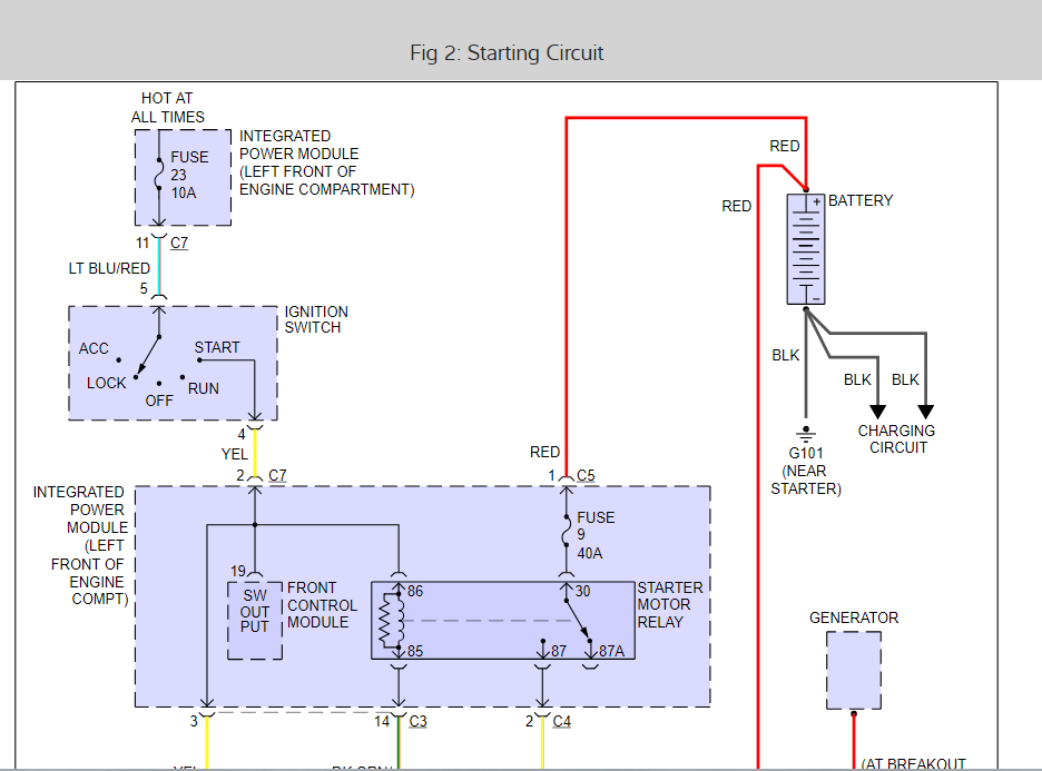

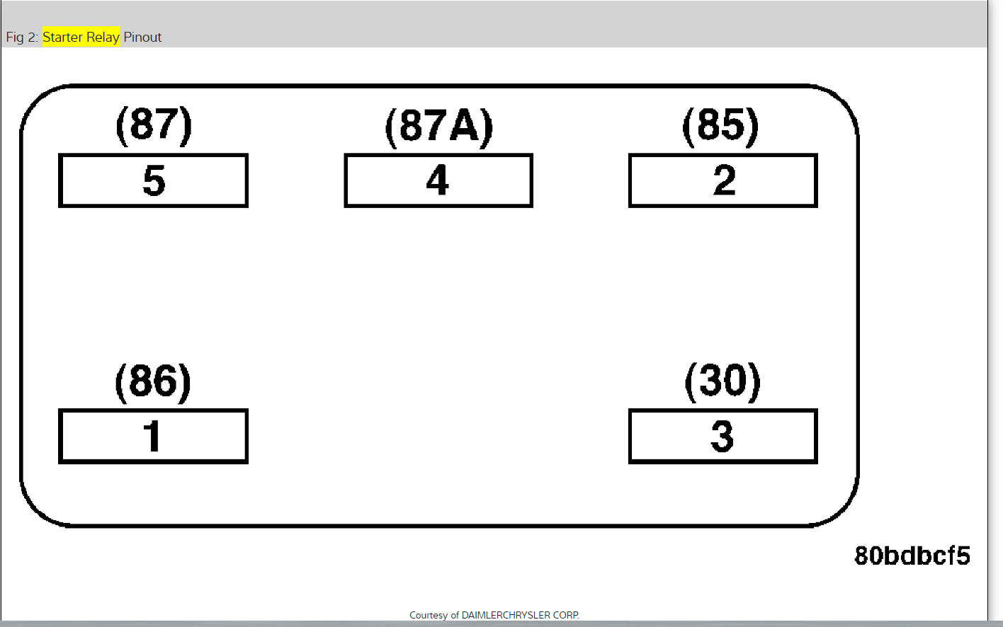

Yes, I had a chance to look at it. What i am doing is taking the starter motor relay completely out and using a wire to jump 30 and 87 together. that will crank. but still no start. do i need that starter motor relay in for it to actually start?
Feb 22, 2019 at 7:51 PM
SCGRANTURISMO
  • 4,897 POSTS

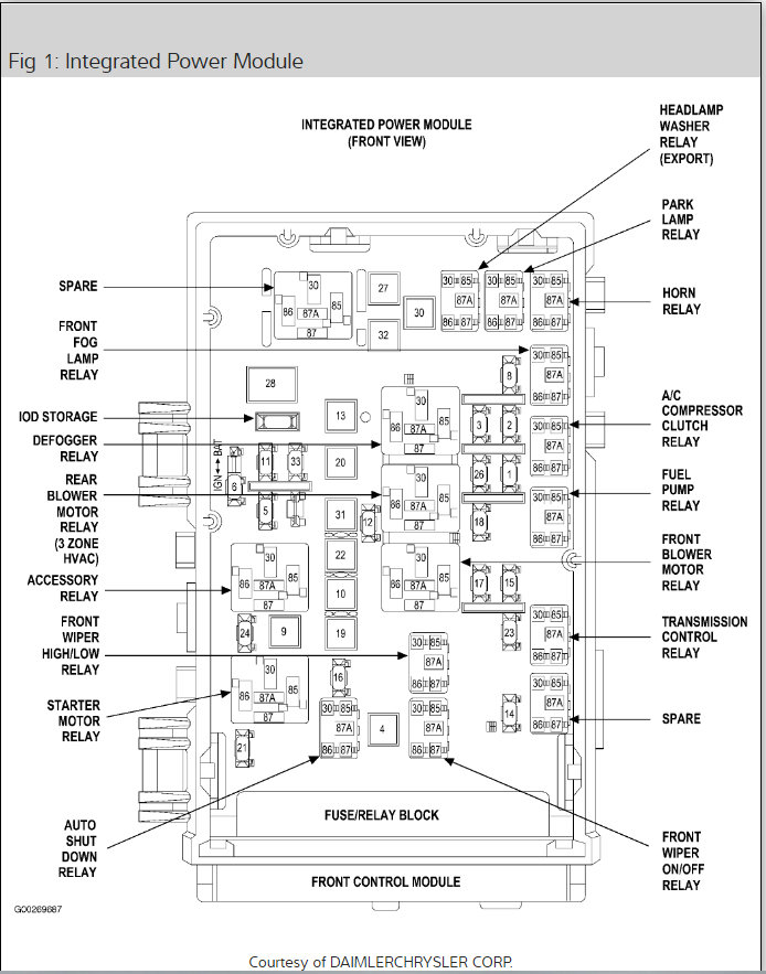

A relay is nothing more than a switch. Electricity is supplied to the control side of a relay, energizing an electromagnet. The electromagnet then pulls the switch closed on the power side completing the intended circuit. In this case the intended circuit is to supply power to the starter. I have included diagrams for the relay in the diagrams down below.

ROCK VONHELSTARR
I have had this happen. Before you jump the relay make sure your key is in the ignition and in the run position then jump relay. vehicle should start like normal.
Mar 22, 2021 at 11:52 PM
Thank you for posting that info. That is a common mistake people make when jumping the relay so thanks for adding that.
Please come back to 2CarPros and let us know if you need help with anything as well. Thanks
