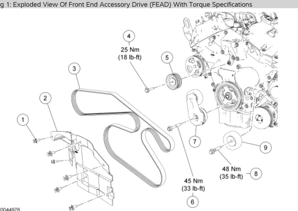

what size of belt would i need to bypass the a/c

if your a/c compressor is locked up then get one from a junkyard if clutch on a/c compressor still works just unplug compressor because most of these cars are not offered and we have no cross listing as most cannot be done. if you do try to reroute it you will have to do that at auto parts store with trial and error.
