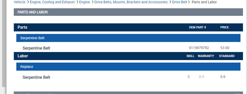

Unfortunately they don't list a belt with no A/C so your options are limited. First you can run a string around the pulleys less the compressor and find a belt that matches that custom size.

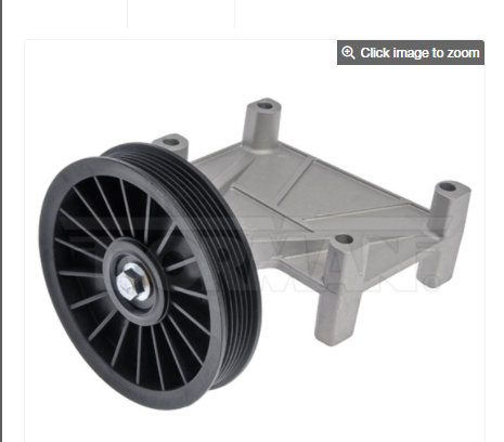

The other option is to install a bypass pulley and just use the stock belt.

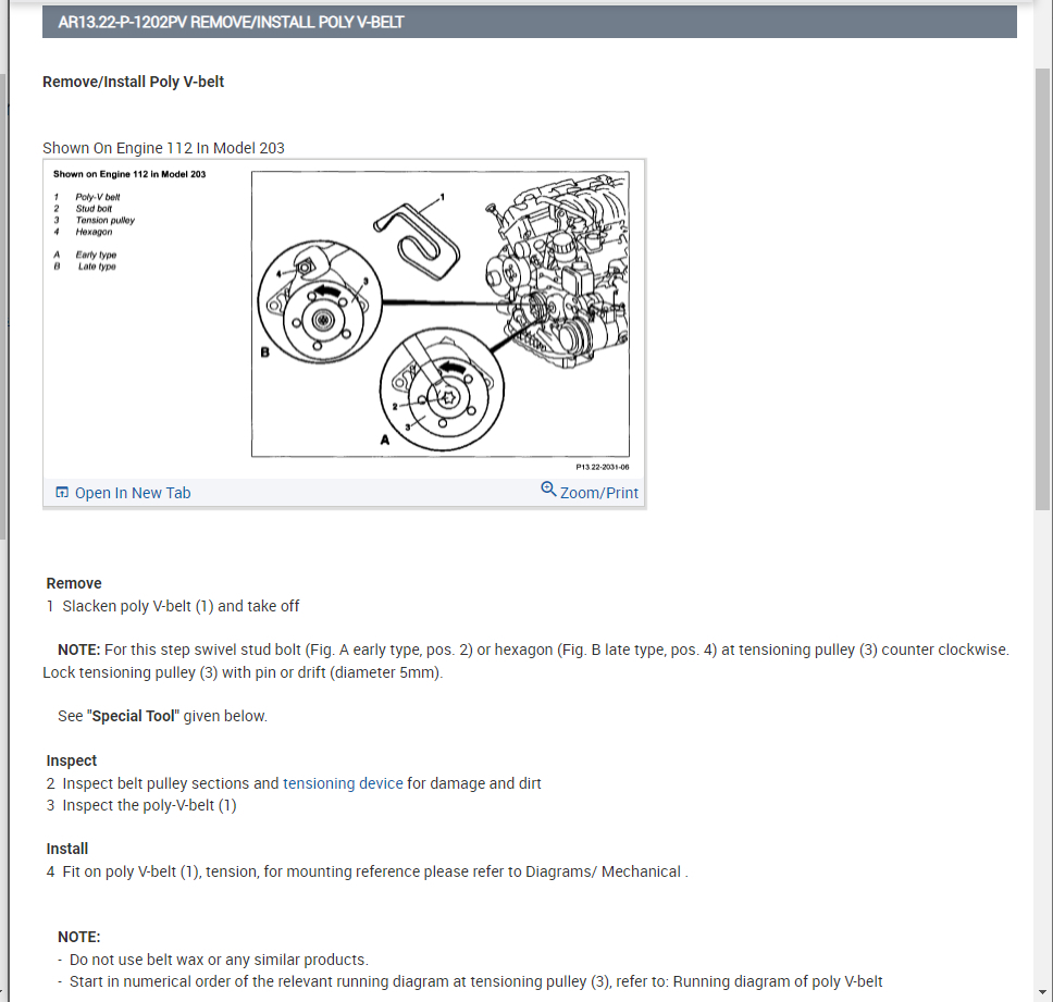

Here is a guide that will help with removing the belt and reinstalling it:
https://www.2carpros.com/articles/replace-serpentine-belt

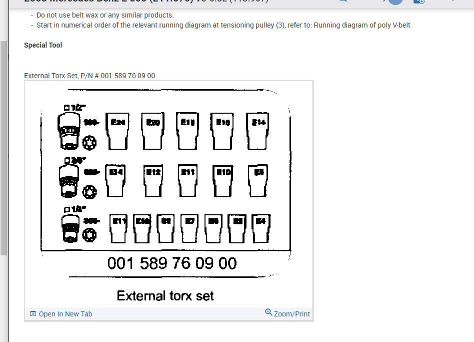

Below you will find the process from the manual and a picture of a bypass pulley.
