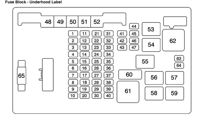

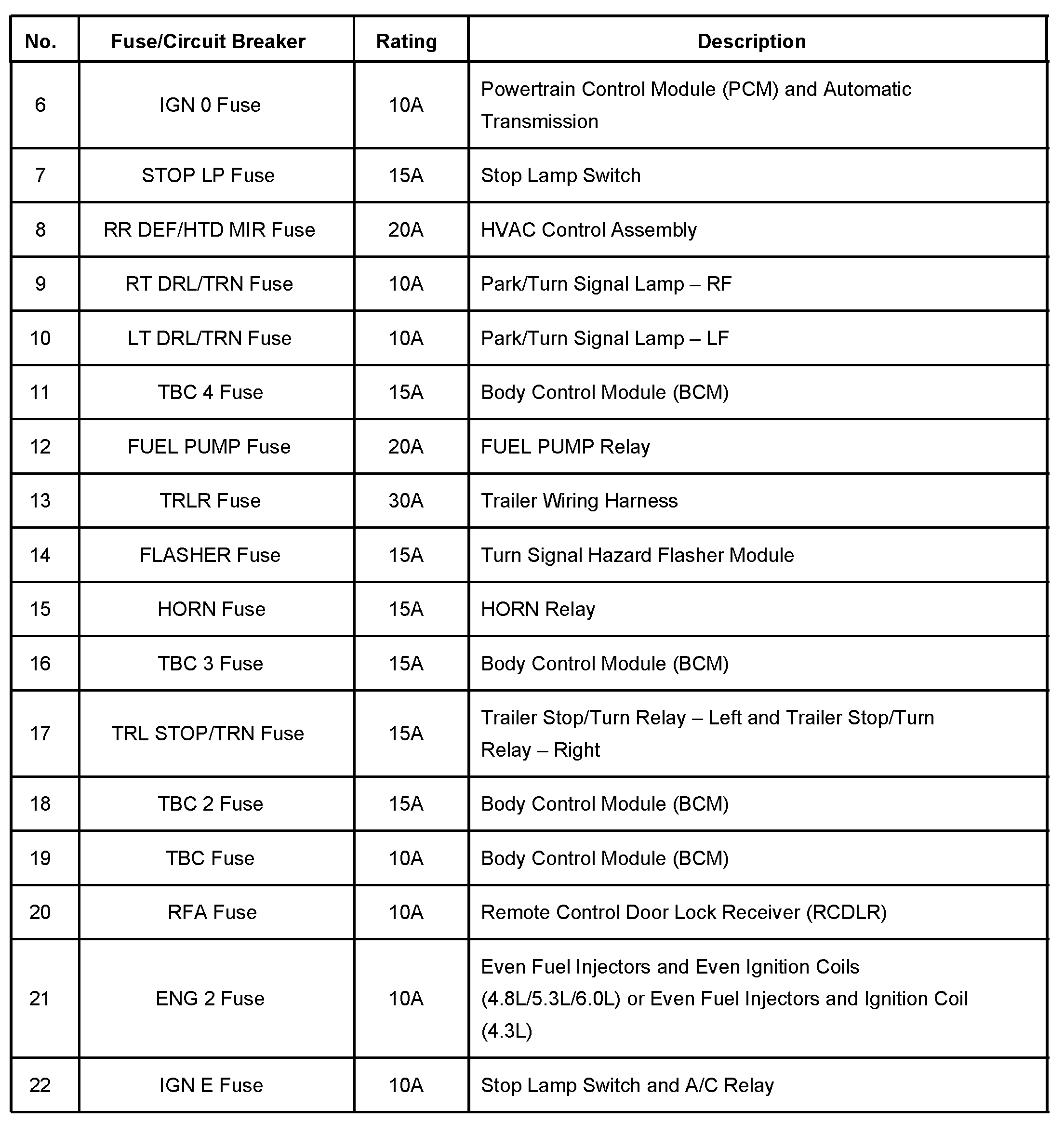

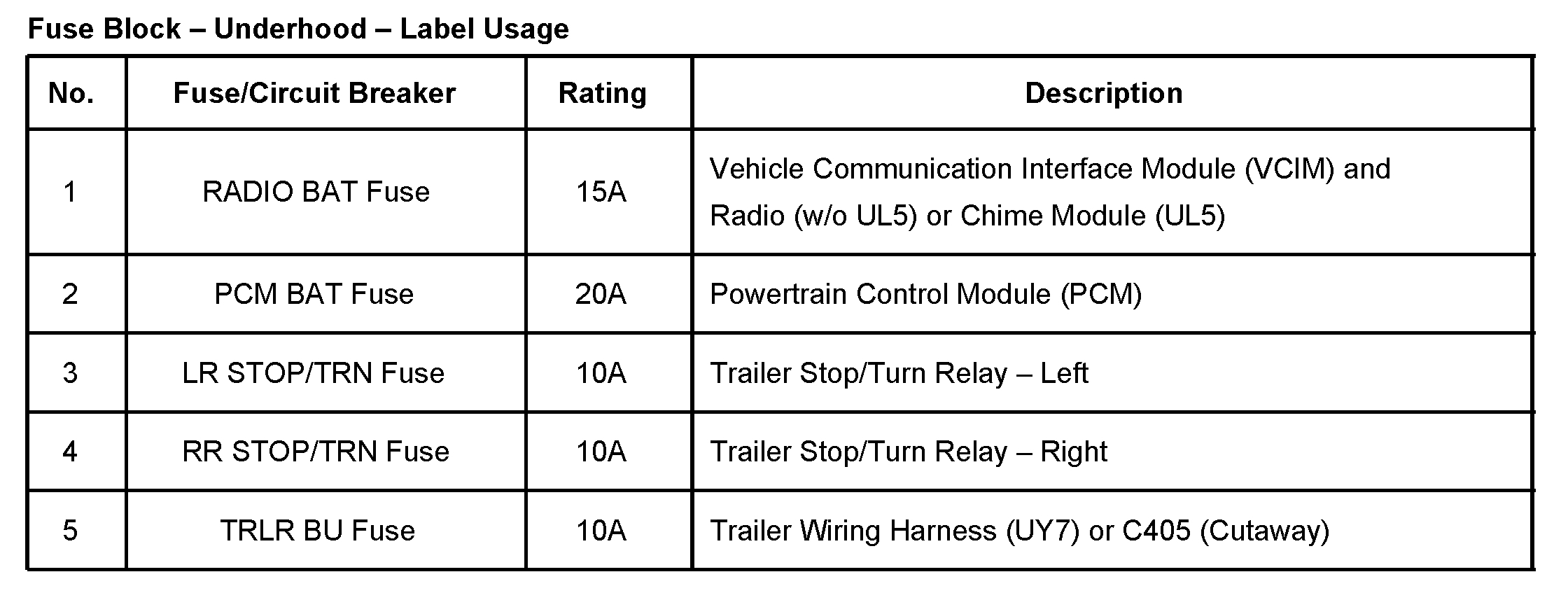

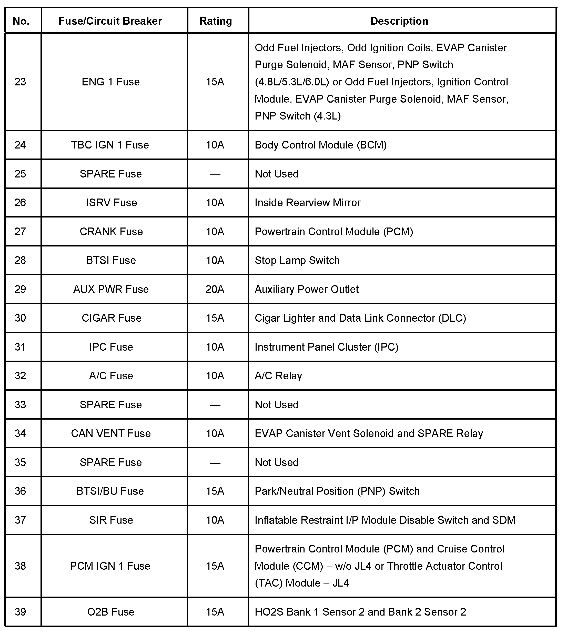

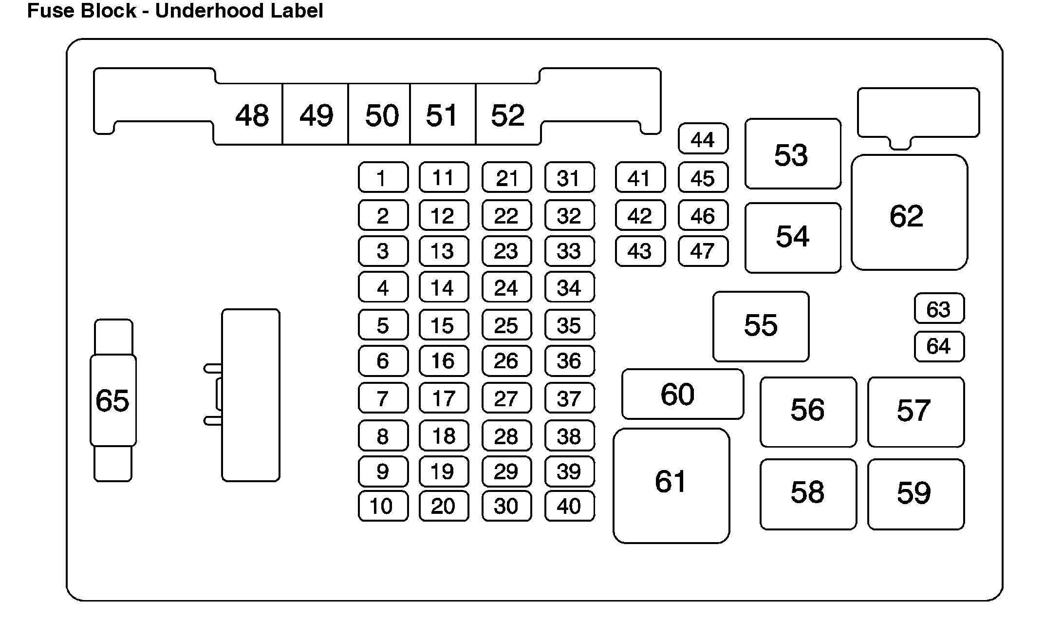

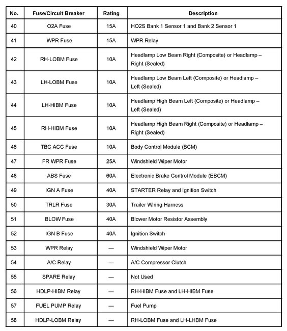

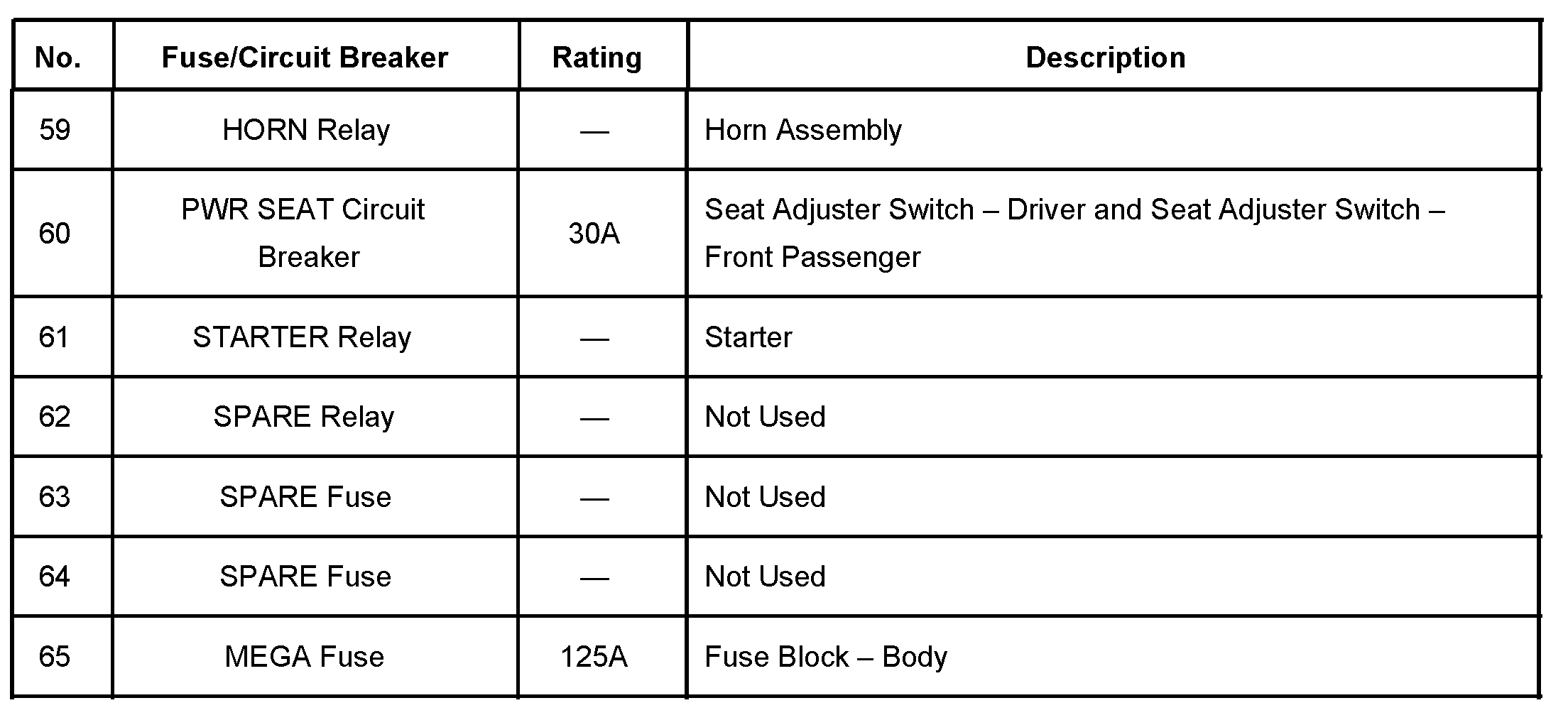

That's a tough one. Is it possible for you to record it and upload the sound for me to hear? Also, what I would do is open the fuse/relay box and touch the relays to see if you feel it. If not, remove one fuse at a time to see which fuse stops the sound. At that point, we will have at least identified the circuit.
I attached a pic of the fuse box and the legends identifying what each fuse controls. Try that and let me know what you find.
