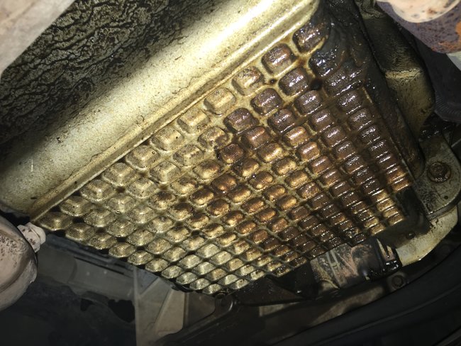

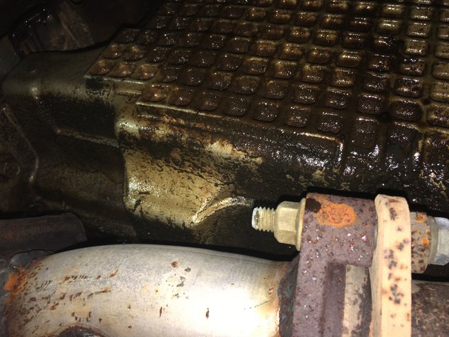

I keep smelling a burnt rubber smell after driving a mile or two. (I can smell it in the car while driving) I have no oil pools under my vehicle but the oil pan looks little wet. so I’m thinking oil pan gasket. I’ll attach some pictures of my oil pan.

It could be but normally the gaskets are not large enough to smell if they are "melting." Plus this gasket is a hard plastic which again, will not put off a smell strong enough to smell that quickly inside the vehicle.
I suspect you have something rubbing a tire. Do you hear any noises when driving? I would suggest starting with checking each tire all around both inside and outside edges to see if there is any wear. A tire would make much more sense based on how quickly and the strength of the smell you are experiencing.

You may also want to inspect the valve cover gasket for a leak which could be leaking into the exhaust or inspect the entire exhaust system for a plastic bag that has melted on the exhaust system causing the smell.
