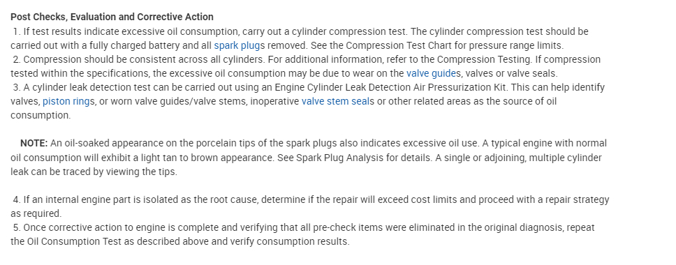

The last oil change mechanic said it was bone dry, no leaks. Might be engine burning oil.
I drove 1,600 miles since then. Dipstick has oil a quarter of the way up from minimum when I check an hour after driving. Dipstick shows 3/4 up from min in the morning. Both checks are in flat driveway same spot. Which reading is right and should I be concerned. Thank you
