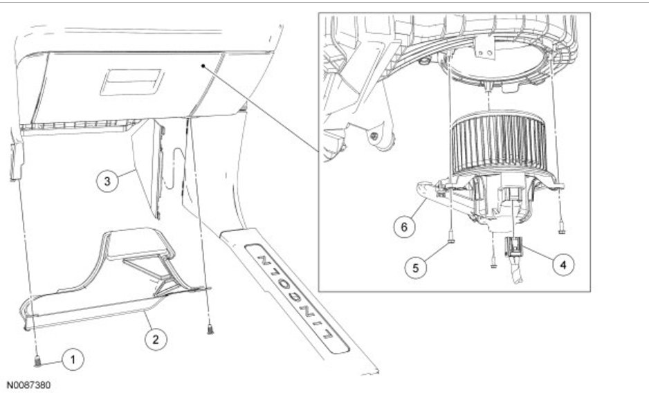

It sounds like the blower motor shorted out.
Here is a guide and some diagrams that will show you how to test the motor and how to replace it:
https://www.2carpros.com/articles/blower-fan-motor-works-on-high-speed-only
Here is the location on your car (below).
