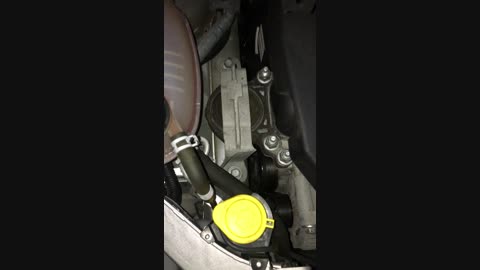

Here's a longer clip of the engine bay. It's pretty cramped so I wasn't able to show everything.

Thanks for the video, this is not a hybrid correct? I have seen hybrid batteries produce a smell when they are shorting out.
The next step is to put it up on a rack to see up under where the exhaust manifold is located. Something must have fallen onto it causing the burning smell. Please let me know.
