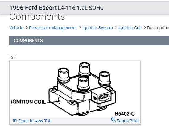

I don't believe this vehicle has a distributor. Are you referring to the coil pack? see pic 1.

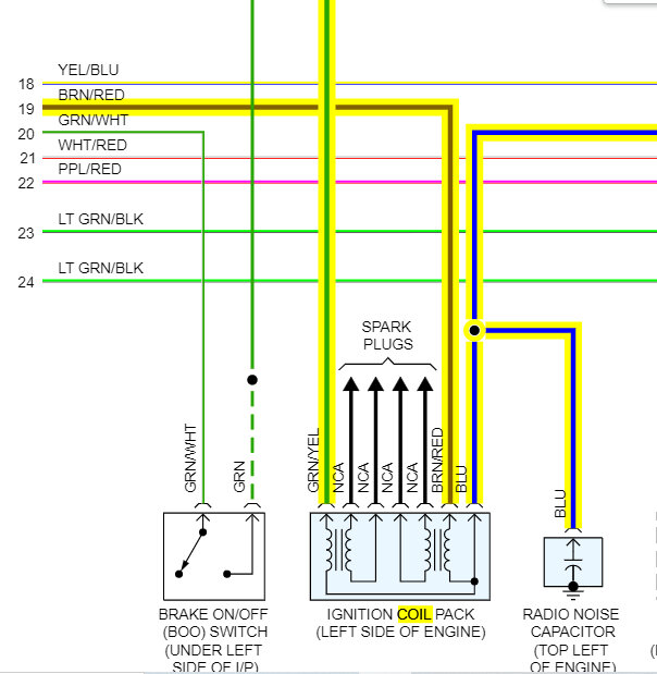

Also, if you follow the wire that is burned, can you find a point where you can identify the wire color? See pic 2
See pics below.
