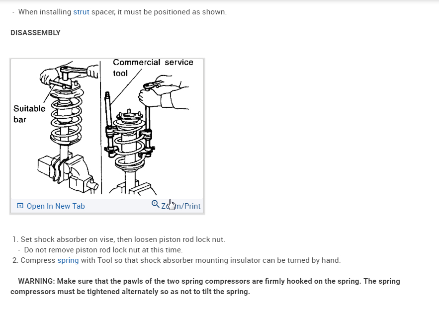

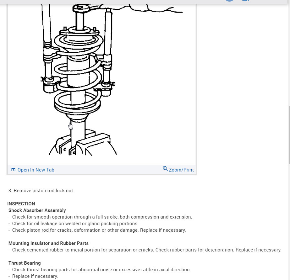

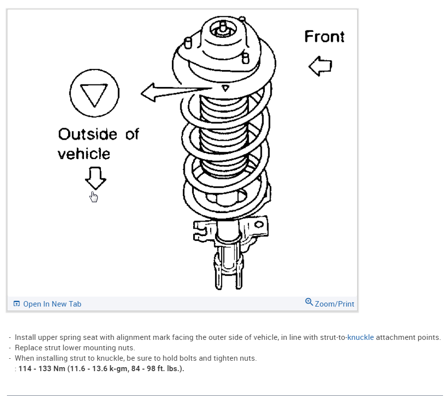

Bumpy driving normally sounds like shock absorbers are worn or have leaked out the oil needed in order to dampen the suspension and give you the firm feeling.

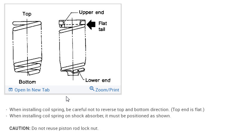

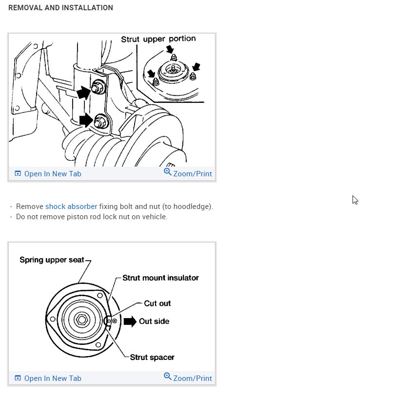

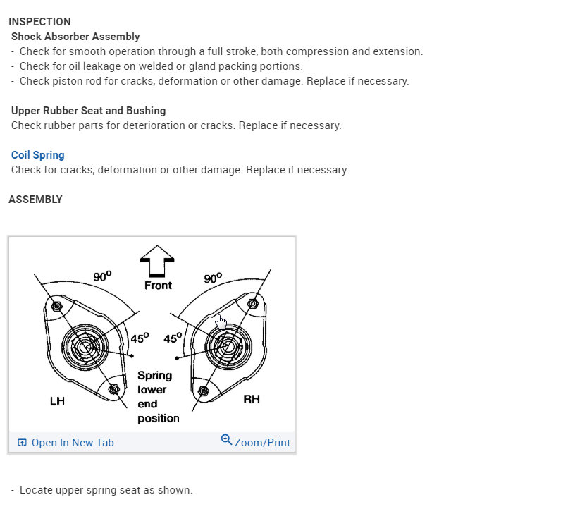

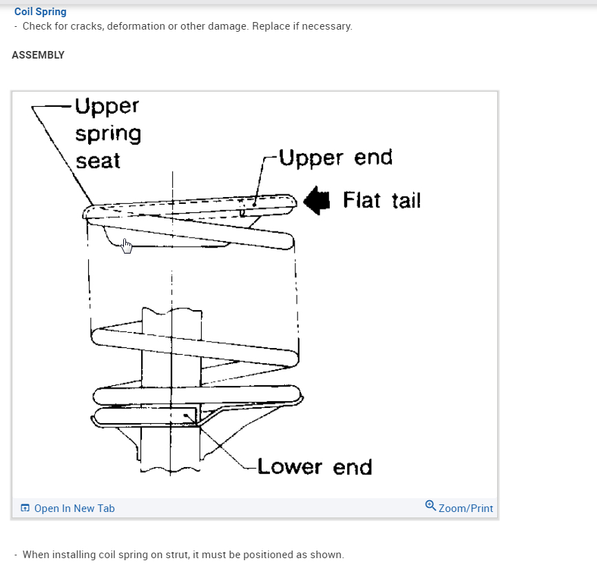

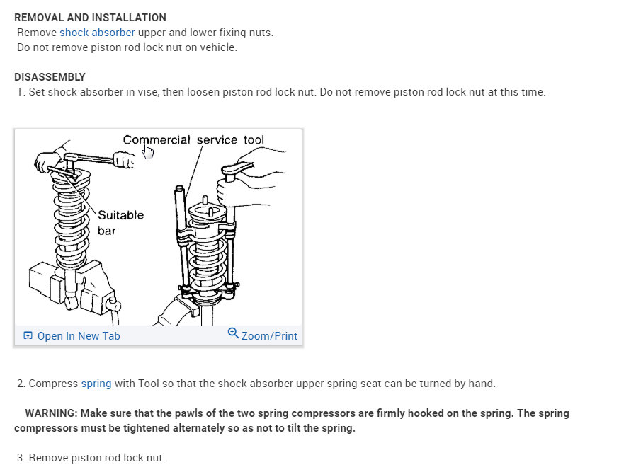

I attached the procedure for the front and rear shocks to remove and install them in the even that I am correct.
https://www.2carpros.com/articles/replace-shock-absorber

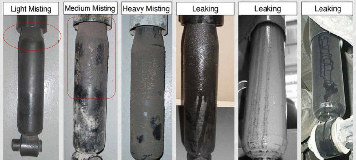

Let me know if you find them leaking. The best way to tell is to see if the shocks look clean or are they covered in oil and dirt? They may be dusty but if they have an oily dirt on them then they are in need of replacement.
