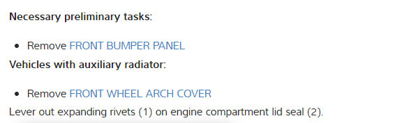

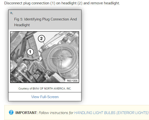

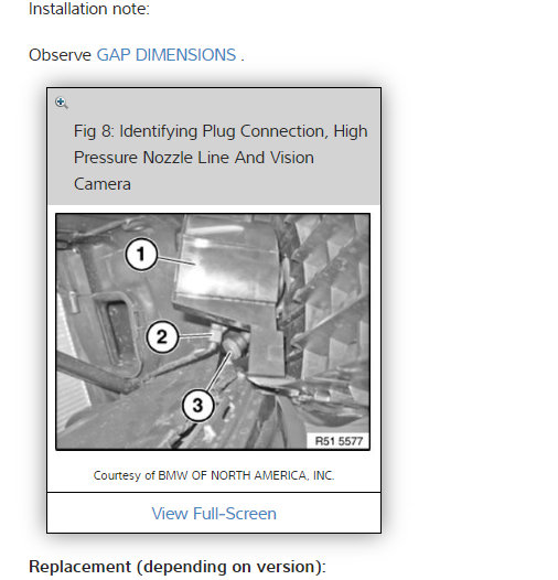

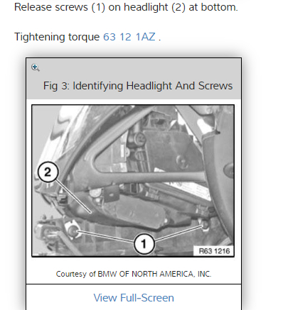

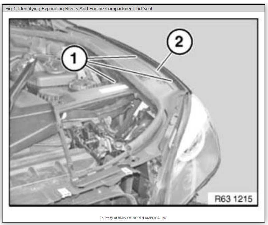

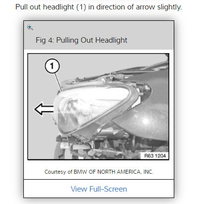

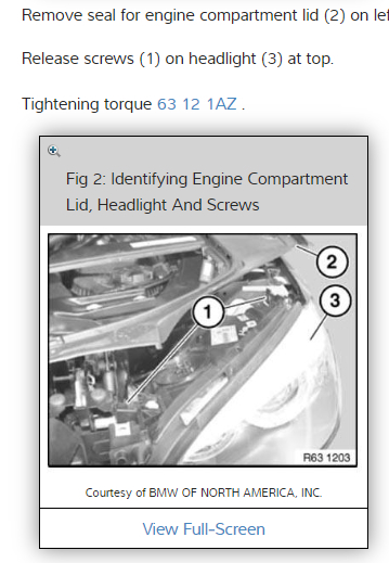

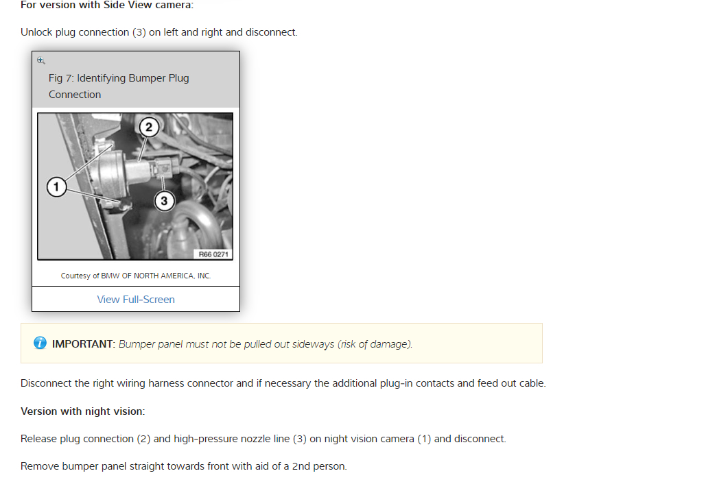

Here are the instructions for the front headlight assembly removal.I wasn't sure what other lights you needed if you need more please let me know. i hope this is helpful.

So bumper must come out?
Feb 18, 2020 at 12:35 PM
PORTAFISHING
  • 37 POSTS

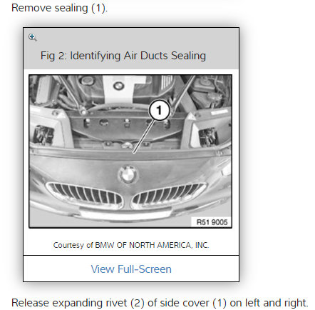

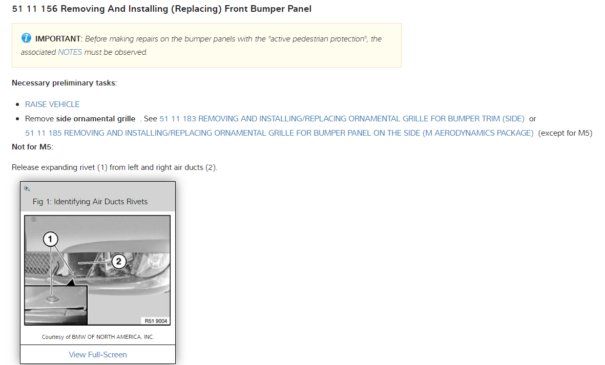

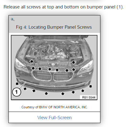

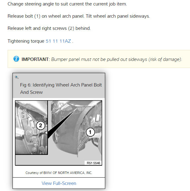

It talks like the bumper had to come out and the grille. you might look at it. If so I can send you instructions on that also.
Feb 18, 2020 at 12:54 PM
NASER NASER
  • 836 POSTS
Yes it seems like it. please send instructions.
Feb 18, 2020 at 1:11 PM
PORTAFISHING
  • 37 POSTS

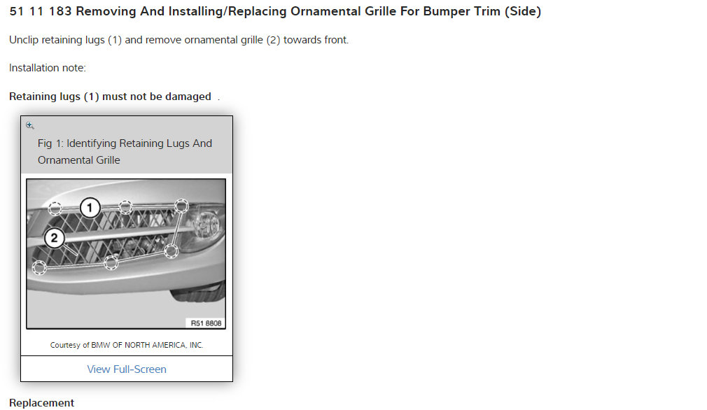

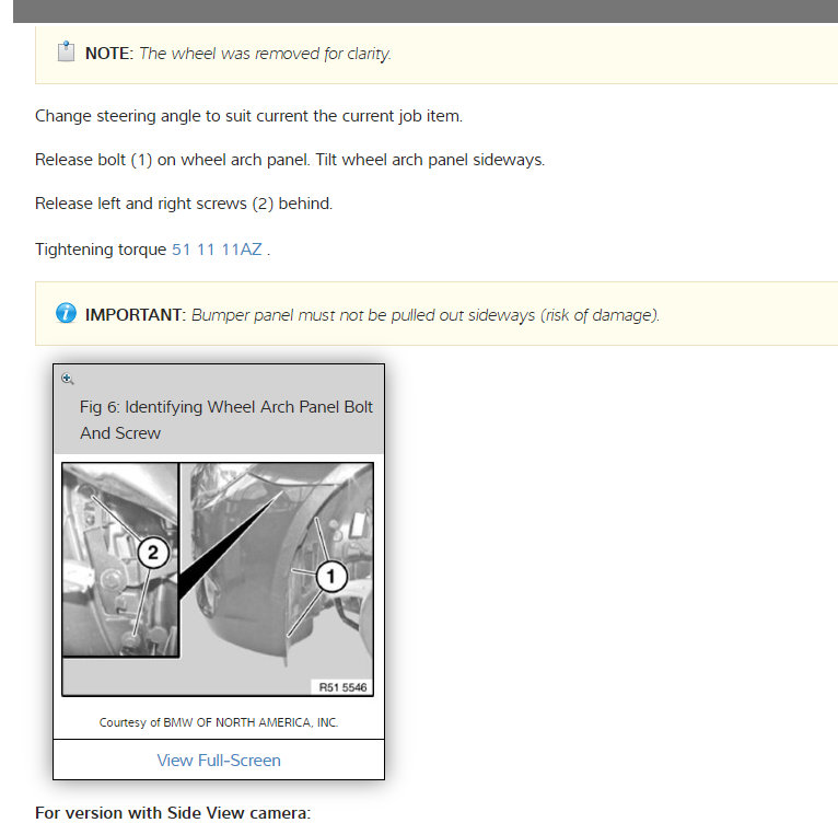

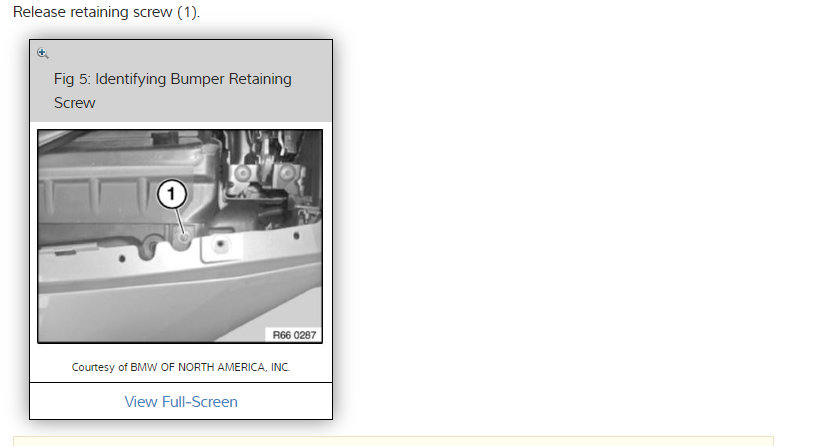

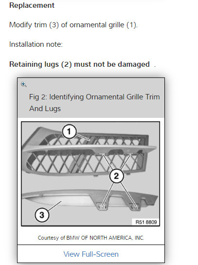

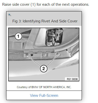

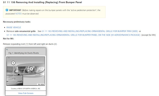

Here are grille and bumper removal instructions, grille first. Let me know how it goes and if i can be of an more assistance.
